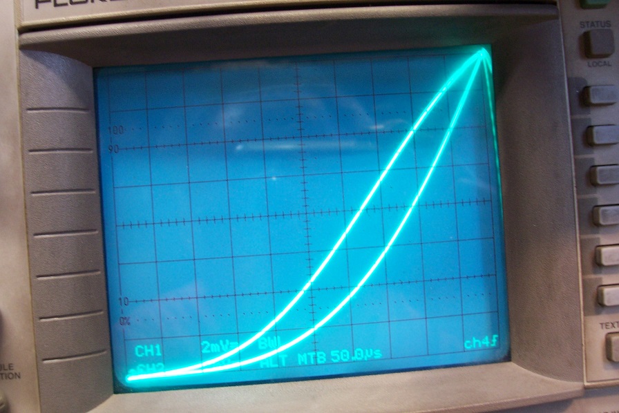

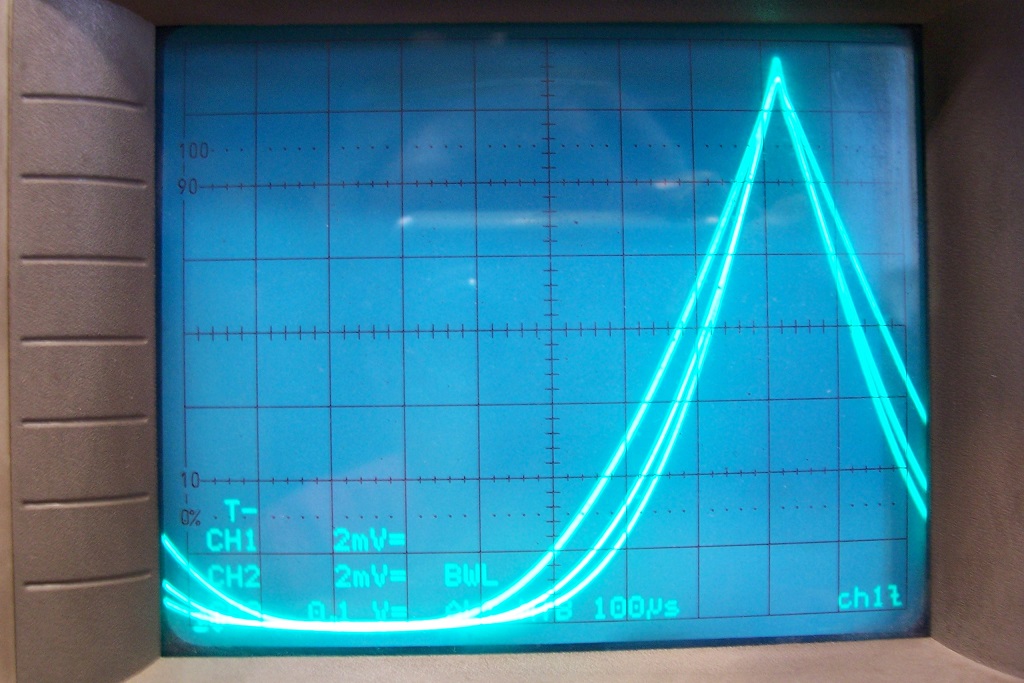

Here it is:
attachment.php
I added a 71mΩ to the 3.31V one (the two others are 3.56 and 3.73V).
It does the job, obviously, but with he peak currents equalized, the region between 0 and 6.4A is significantly altered: it is visible in the much wider "skirt" of the characteristic.
Completely normal, of course, but is it acceptable?

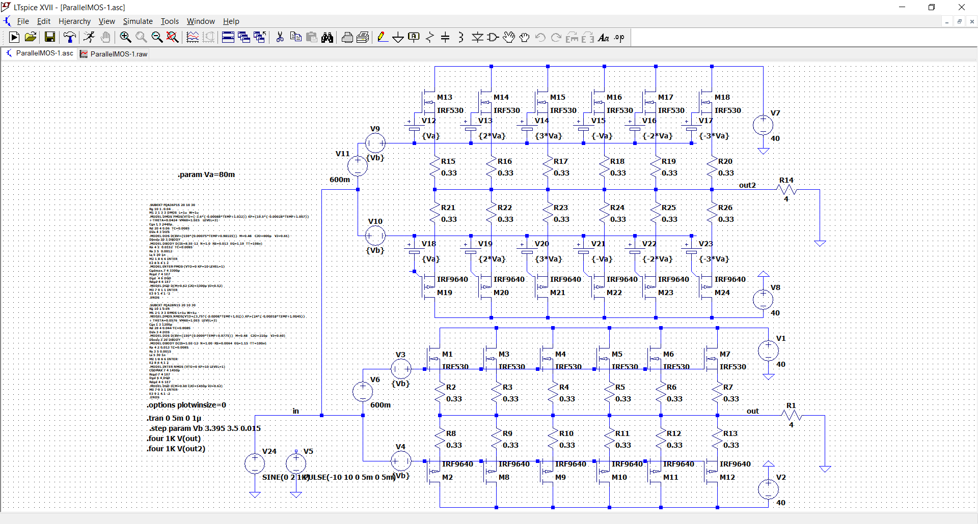

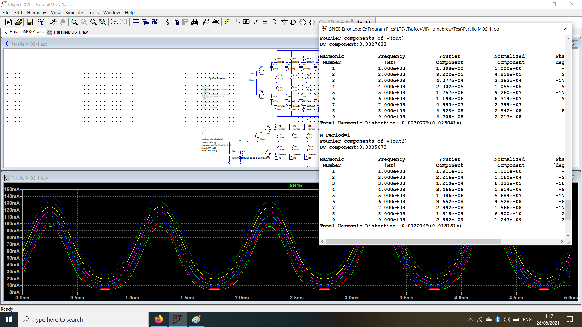

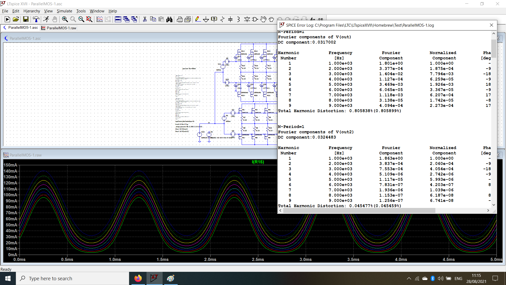

I have explored the Vto dispersion idea in greater details.
I have used sounder models in the sim: IRF530 and IRF9640.
attachment.php
The results on the crossover distortion are quite spectacular: this is the first iteration (lowest bias current)
attachment.php
And this is the last one:
attachment.php
Not so spectacular, but still a worthwhile improvement
Hopefully I'm not wrong to say "not bad!" Small achievements are still achievements.

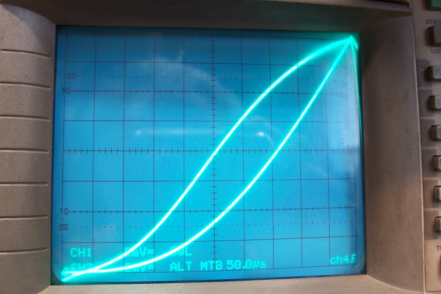

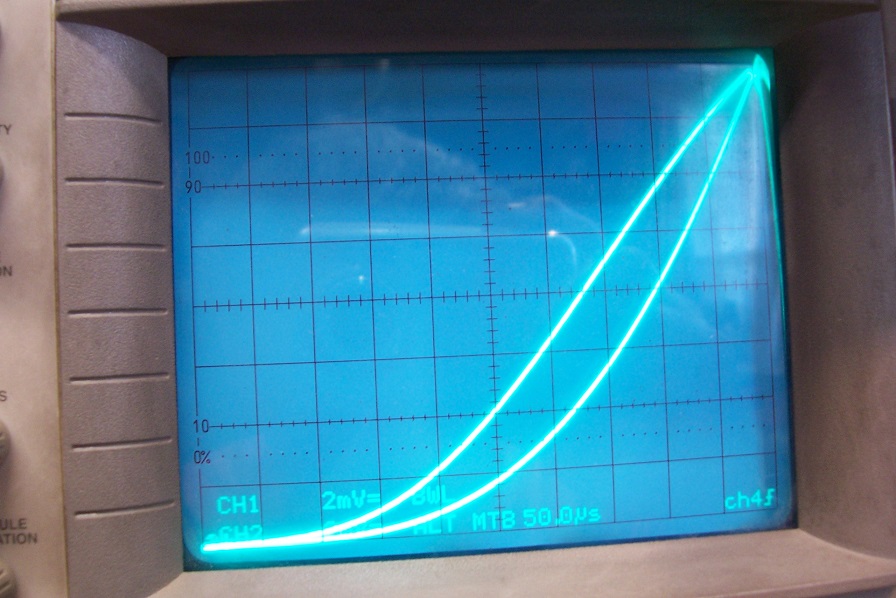

Since gm = dIs/dVgs and dVgs/dt is constant with a triangle wave, if you trace the derivative directly by adding a C-R filter at the output of the current sense amp, you will get gm...
Here are the results: I first tried to do it digitally, using the math function of the scope, but the dynamic range was not sufficient to get a comfortable full-screen view and I ended up extracting it analogically.
First, a "normal" FET (no resistor, Vto=3.52V)
attachment.php
Next the one with the resistor:
attachment.php
And finally, the global average:
attachment.php
The vertical scale for the derivative is arbitrary and relative: I simply tweaked the parameters to arrive at a full-screen waveform.
The most obvious (and expected) difference is the dilution of the exponential component by the resistor

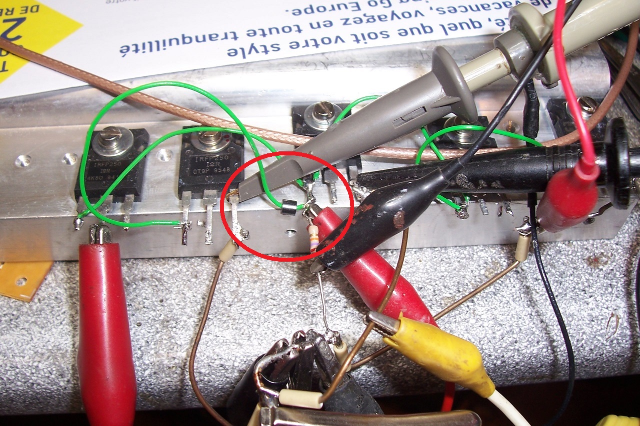

I use them all the time: for example, for this test I had to use two of them (the other one is hidden behind a probe)

Mostly trial and error.
The inductance added must be low enough not form a LP filter having a Fo affecting the loop characteristics of the amplifier, but other than that you have to rely on experimentation.
Sometimes, a // combination of a discrete inductor and resistor works better: you are free to chose the inductance and the damping separately
Larger gate stops are just a band aid, and will eventually degrade the non-dominant poles inside the intentional global feedback and eat into phase margin. Small gate stops are all that is needed to prevent parallel FET (odd mode) oscillation.
Sensible advice there, which is why ferrite beads are more effective than resistors, as they target VHF effectively without impacting too much the loop characteristics
