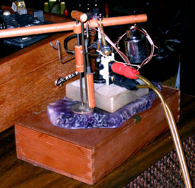

It's not as easy as it might seem..Sure, lifting up is no problem, but getting it to stay up, rotate smoothly and level, and drop nice and gently...spot on, is a whole nother story.

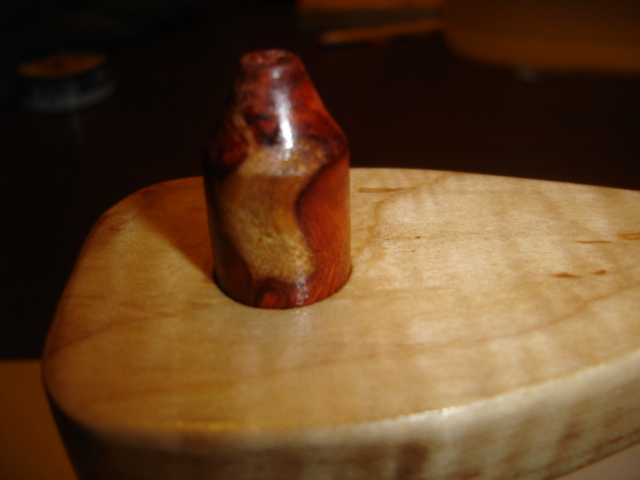

Hi Stew,
not much yet,soundwise,'cause still have no wire,waiting.But...
mechanics,well, looks excellent.Balanced,it rotates on the bearing for a well 2 minutes,after a gentle push.Which it seems right,frictionwise.
Had to widen the hole a little bit more,just to have some more clearance in the vertical movement.

well if your counter-weight can grip the shaft, then no need to worry too much. As the tonearm is "freed" from the lift arm, the azimuth adjustment will self-restore🙂, one of the beauties of Dumb-a*s simple design.
The same thing can be accomplished using "outrigger" weights to stabilize the cartridge cantilever laterally, and help adjust azimuth. This is something I haven't discussed at all...lateral stability of the cantilever.
wjlamp: That's the beauty of this design. And know I was in an absolute rush to get these together and to dave (I finished them late Wednesday night, shipped them on Thursday for delivery to chris and dave on Friday. The audio fest began Saturday morning), and I know they were not perfect.

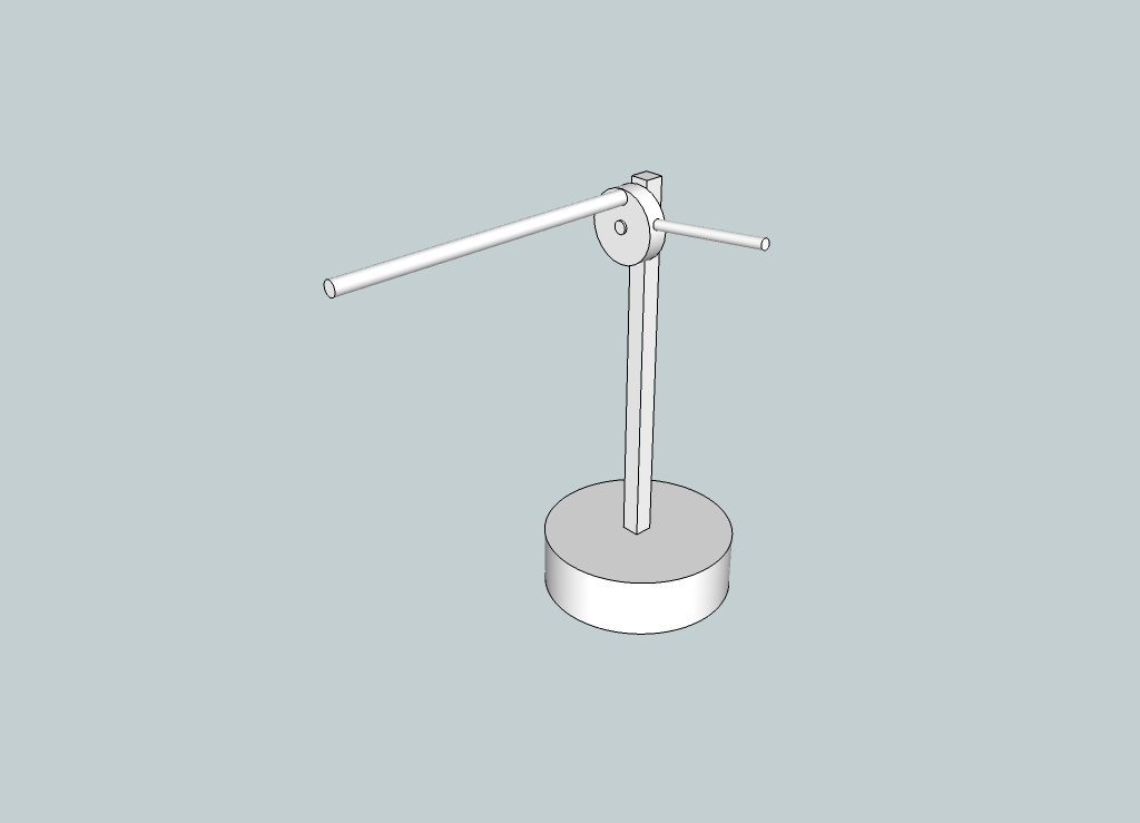

Well, all of my drawings (and I do mean hundreds of them), in sketchup and autocad are gone. This includes the measured drawings that I had for the tonearms, so that if any might need further instruction via a visual, they could be posted.

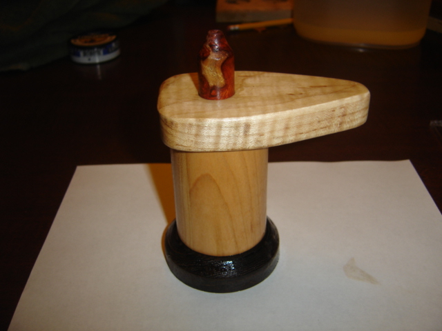

Almost finished with the Tonearm pedestal. Here is a few photo's of the progress.
Still need to make the base and arm rest. I put a little room for a lift if I get around to making one.
The bearing base is moveable up and down to set VTA. I will probably make a set screw out of wood to hold it.
So far cost is zero since these were scrap pieces of wood laying around. At times it pays to be a pack rat.
