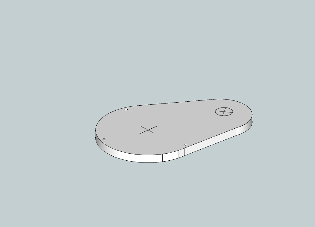

I am thinking of making an armboard/pedestal as well. I like the set screw type collars though as it allows you to move the arm around quickly and easily. Also wanting to make an armboard to attach to my Oracle so that it is an easy swap.

some tools for turntable setup (for "219" users, and anybody else).
Acoustic "sniffing": My wife needed (or wanted) a new stethoscope for work. I bought my wife an updated Littmann, with the newest design acoustic bell. It has proven to be a significant upgrade to her Littmann Lightweight. Then I was able to keep the Lightweight for myself for audio purposes.
for Scott (in his "Phoenix" thread). It depends on what stethoscope your wife uses. If a newer electronically "assisted" one, then they are very expensive and getting your wife an "improved" one would be more so. Even an inexpensive "student" type works very well for audio purposes.
for measuring rotational speed: I also bought a digital tachometer that has proven to allow me to be much quicker (and it is much easier to use) when adjusting speed. Stick a piece of foil tape (mylar) onto the side of a "dull" platter edge (or cover the platter edge with electrician's tape, except a small gap left exposed). Put a record on and adjust the speed while playing. +/-.05 RPM is displayed. I figure if I can get to within .1 of the 33 1/3 rpm, I'm doing ok. My ears agree.
for measuring tracking weight: Local "head shops" sell digital scales. I bought one that has a max weight capability of 50 grams (+/- .005 grams) for measuring static tracking force. This has proven invaluable as it allow very fine adjustment .
A few more "tools" and I should be set to actually measure something. An inexpensive micrometer is useful. An electromagnetic base and a dial indicator. A couple of good microphones, a few more slabs of granite, a couple of marble. Some levelling feet would be good as well to help create a portable , stable platform to work on.
And a couple of test records. Also a good mono recording to help with adjusting azimuth using more than my ears (although there is a couple of ways to do this with very little effort.
I had designed an audio "transom", although quite poorly named. It allows for the quick and easy location of the tonearm mount location. It also allows for accurate measurement of the offset angle and provides an alignment grid . Basically place over your spindle. Slide the arm outward (not rotationally but dorsally) until the locating pin is above the centre point of the rotational location of any tonearm. Rotate the primary angular grid until it reads to the nearest degree, then use the secondary one to fine tune the grid. Accurate to within +/- .1 degree. Or do the math with the measurements 🙂
