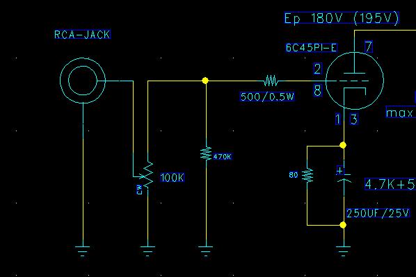

Volume VR connection could try this circuit.
I connect Volume input in this way.
My D/A pre-amp is Hi-Z OPT output.
But sound better than old connection.

The connection of the VC as you showed will present an even higher impedance to the 6C45 grid as the standard one, at lower volume settings it will approach 100k. The 6C45 has a very high input capacitance dominated by miller of a few hundred pF. This will cause high freq roll off well in the audible band.
Also the input impedance of the amp will vary with volume setting, approaching very low values at low volume. Not ideal with a High Z source. Depending on the source that could mean increased distortion.
The fact that it sounds better to you means you like a high frequency roll off which can make a source which tends to sound a bit harsh to appear more relaxed. technically this connection is sub optimal.
A 100k pot driving a 6C45 is already borderline in the standard connection.
Did you check the frequeny response at different VC settings?

Hi:
VC is a carbon trimmer basically is low Q factor component.
After modify circuit I get more detail between 1Khz~4khZ.
That's means audio sensitivity is better than before and
High frequency roll off is not worse as predicted.
That's why some Amplifier no VC setup.
BTW when volume setting approaching very low values at low volume.
Speaker lost more than source input distortion.

Did you measure it? Where is the -3dB point? Does it change with VC setting?

Hi:
feed S.G. signal and use Scop. to measure....No.
-3db bandwidth should be open loop testing
and measurement on scalar analyzer.
I only do Tube amplifier L / R Channel different VC connection test.
After test I choice this connection.
