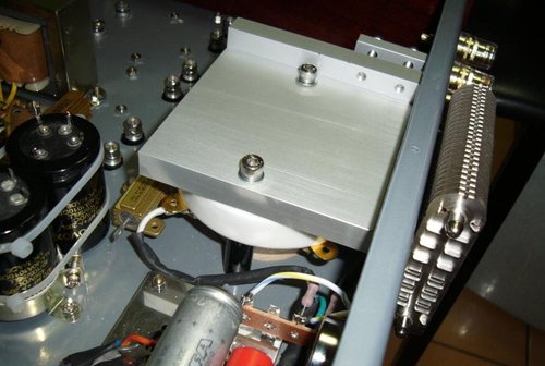

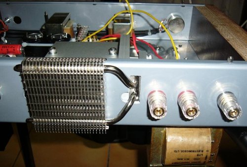

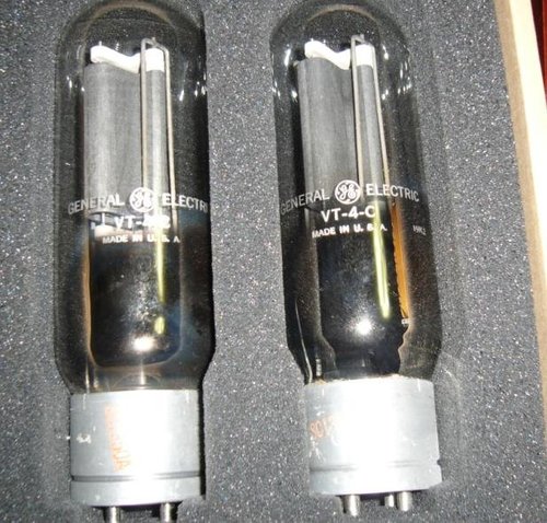

Because VT4c-211 too hot so I design a water cooling platform to fix Tube.
![images-7.jpg images-7.jpg](https://www.diyaudio.com/community/data/attachments/183/183203-d364964847a7eda1827ede99264f12d4.jpg)
Second hand GE VT4C-211s.

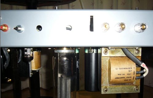

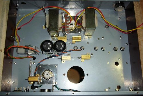

![images-8.jpg images-8.jpg](https://www.diyaudio.com/community/data/attachments/183/183207-72e38aaace03054a247b2984cf5f0078.jpg)
Top view. The cooling heatsink is close rear board but no contact case.

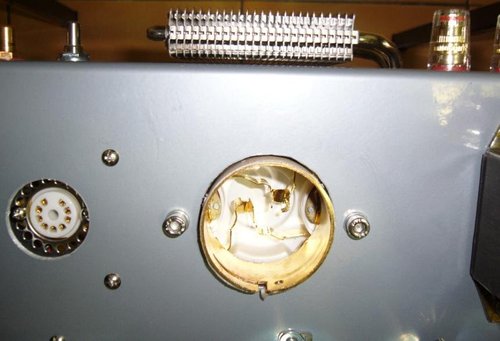

![images-9.jpg images-9.jpg](https://www.diyaudio.com/community/data/attachments/183/183211-676aac51f6e9869df8913c50858adb22.jpg)
Rear view. I open a window for water pipe through rear board.

This is completely unnecessary. Especially down there at the socket, a heatsink will not have much effect. The 211 is made for air cooling without the need for additional heatsinking.
Be careful with that aluminum plate fixed to the sockets! The screws in the ceramic which fix the connectors, carry high voltage and might be too close to that aluminum!

Hi:
Thanks your remind!
I design a stick to fix platform.

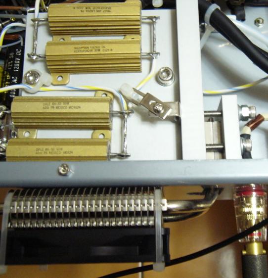

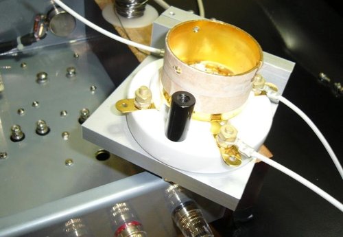

![images-10.jpg images-10.jpg](https://www.diyaudio.com/community/data/attachments/184/184406-2d07af0808e316e64139db80b7d6215e.jpg)
This black Stick keep enough distance to isolate high voltage.
I also fix 211 cathod resistors on this platform.
![images-11.jpg images-11.jpg](https://www.diyaudio.com/community/data/attachments/184/184412-2a31d88bf33aa14580ef2dc2081ec4e3.jpg)
After test looks pretty good.

Hi!
That's not what I meant. There are screws going through the ceramic which fix the connectors on the socket. In some sockets these are insulated, in some not. They could be quite close to your aluminum heatsink. Better check that.
Seems like excessive heatsinking for a cathode resistor which dissipates only 5W.

Hi:
The screw is through caramic but still have about 5mm clearance to bottom.
About The cathode resistor ...because I use AC heater for VT4C and I remember cathode resistor is hot about 45 degree-C so I Buy 50W.
I have same experience on 300B cathode resistor too (same AC heater too) and cap. too close resistor the temp. cause cap. leak oil.
Your could check picture I also assembly a cooling fan on heat-sink because after 2 Hr the water pipe is hot too.
Maybe the heat is come from the socket of VT4C too.

Hi!
5mm clearance is quite tight. The plate does not only carry the full B+. If driven hard it can see voltage peaks of 2kV.
It is ok to overrate the wattage of resistors. I ususally use a factor of 5. It makes no difference to the dissipation of the cathode resistor if the 211 is AC heated or DC heated.
I use no extra heatsinking to sockets or resistors in my 211 amps and I drive the 211 at maqx plate dissipation.

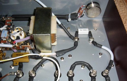

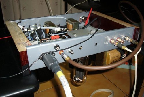

Toy11 VT4C 211AMP -4
High voltage I design 2 times frequency boost and rectifier to 1600V(no load).
Two power balance chocks one is for 211 B+ another for GND.
Finish GE211 plate voltage connection with Teflon tub.
Finish OTP connection with Teflon tub too.
Insert GE211 tub prepare supply high voltage.

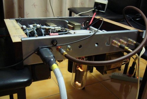

Connect AC power and audio signal.
Modify 6C45 & VT4C gride voltage to meet design.
Supply high voltage.
Measure GE211 plate voltage as design 1250V.
So far just finish one channel amplifier (This system is mono amp.) .

Hi Aster,
Your meter measures VT4C/211 anode at 1265V? It's already
higher than 1250V maximum.Why do you need that much power when you
are using high efficiency speaker at 92db? More power gives more distortion.
Another thing is when you want to use shuquang or other chinese
tube they may not be able to last long or survive that high anode voltage.
Why not set it at 1000V - 1100V?
Are you using switchmode supply or normal voltage doubler for 211/VT4C
anode? So how is the sound of your amp?
