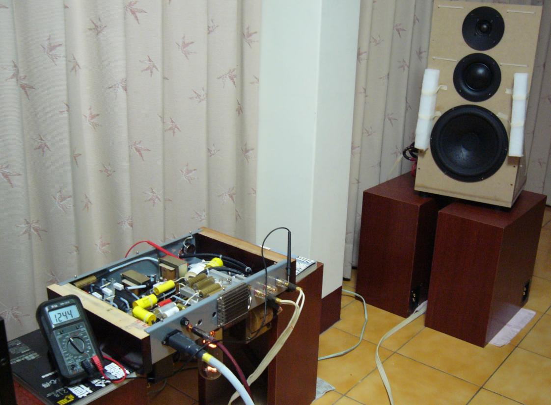

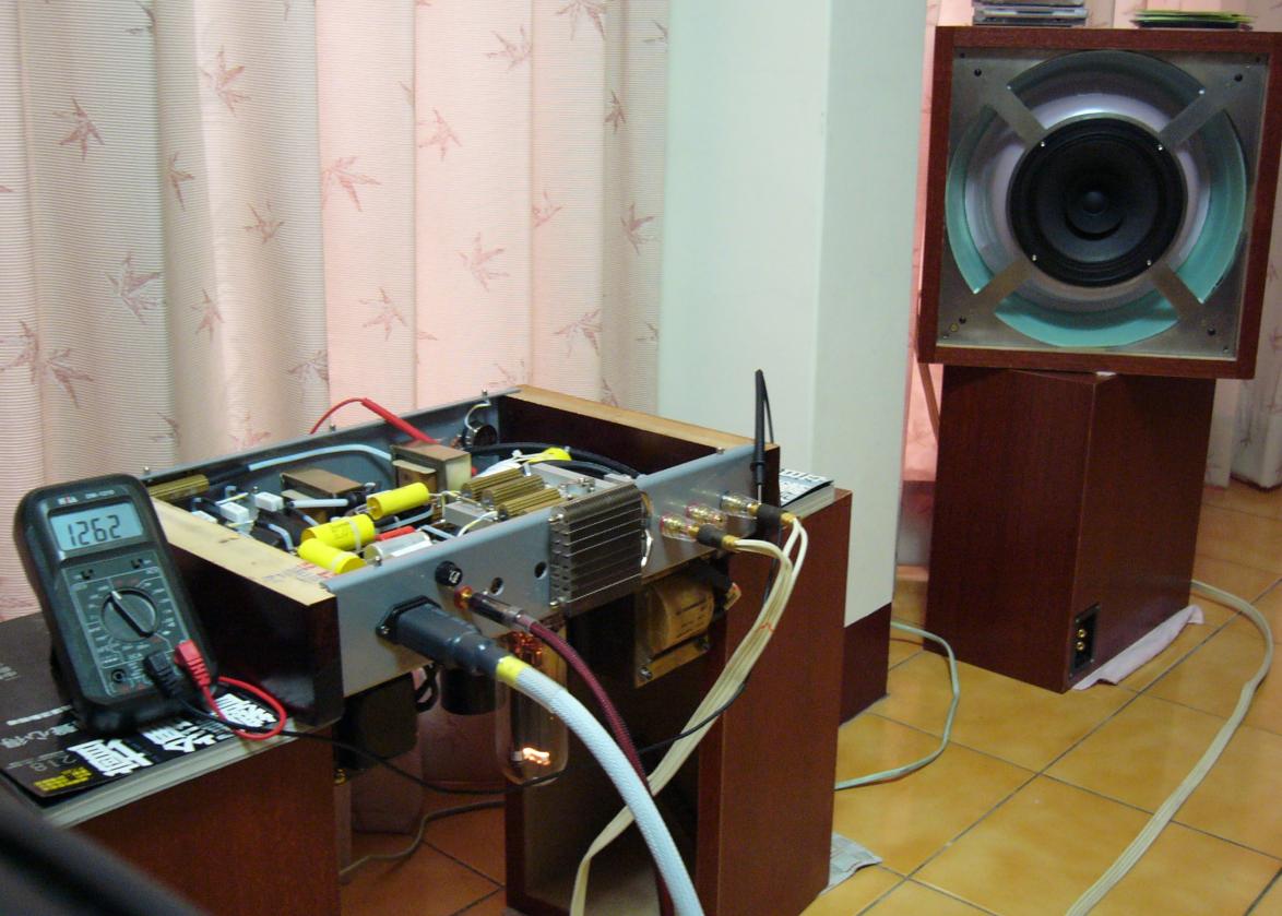

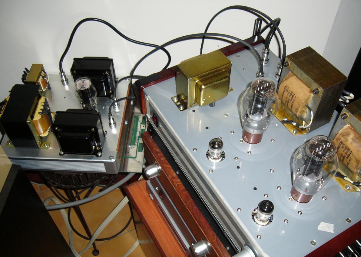

Toy11 VT4C 211AMP -5 ....Check different speaker
VT4C amplifier connet Full range speaker (Diy too).
Test sound quality.... feel not good.
VT4C amplifier connet 3-way speaker (Diy too under check crossover).
Test sound quality.... feel better.
![Images-7.JPG Images-7.JPG](https://www.diyaudio.com/community/data/attachments/191/191747-d5b491a3e388d60d010b809213bbe7bc.jpg)

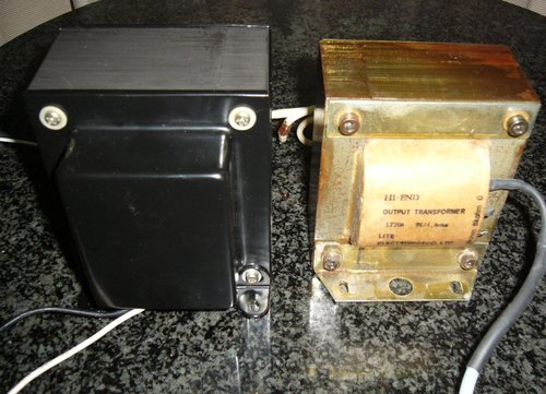

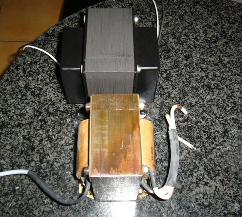

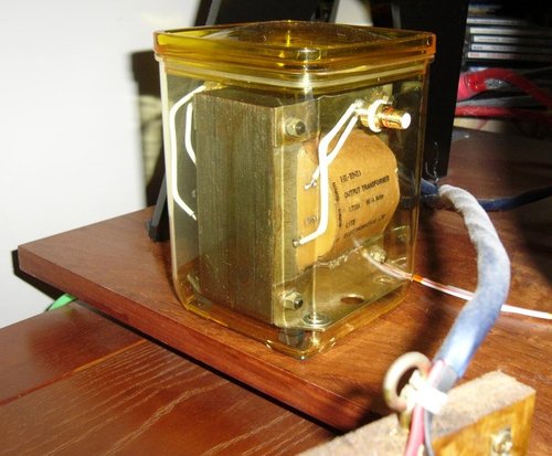

Toy11 VT4C 211AMP -6 ....Change output transformer
211 Amp. take off old output transformer and prepare assemble new output transformer.
Put two output transformer togother.
Left side is Look-T OTP and Right side is Lite OTP from China.
My friend's hand make transformer thickness is more large.
He got over 15 years Tube amplifier experience and that's
from Transformer to Tube amplifire circuit design.
211?845?????? - LOOK-T ????? - Yahoo!?????
Find a suitable box and hand make an home give for transformer.
This for Hi-pass across over (over 7Khz) change impedance to fit Plasma tweeter input.
Because Lite transformer got poor performance in low frequency.
Replace output transformer and verify high voltage operate function ok.
The sound feeling ....sound filed of the deep carved and
VT4C Low freq. (<1khz) have clear body line .
Aster

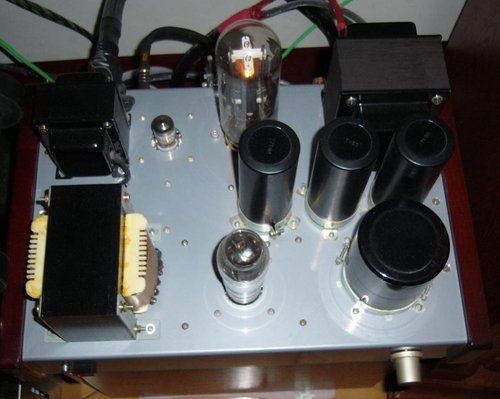

I have made 300B Amplifier too.
6C45pi drive 300B.
300 B+ about 410V and still under tuning sound color.
![images-1.JPG images-1.JPG](https://www.diyaudio.com/community/data/attachments/201/201646-6ee9d669a98d798b59d109ceb648ad77.jpg)
Stand alone high voltage.
Aster
Mr211's Blog - Yahoo!?????

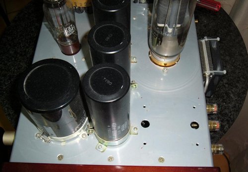

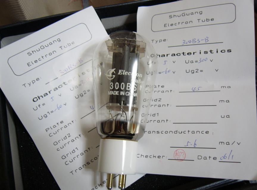

Hi:
I usually tuning sound color between 211 and 300B to make a bench-mark.
That's different scale of Sound field.
I like 300b a little bit more than 211.
![300b-2.JPG 300b-2.JPG](https://www.diyaudio.com/community/data/attachments/201/201651-0a284568501392dc3e5d44be1046c8b2.jpg)
My final selection China 300b because cheap.
I have been using this 300b about 4 years now.
Aster
