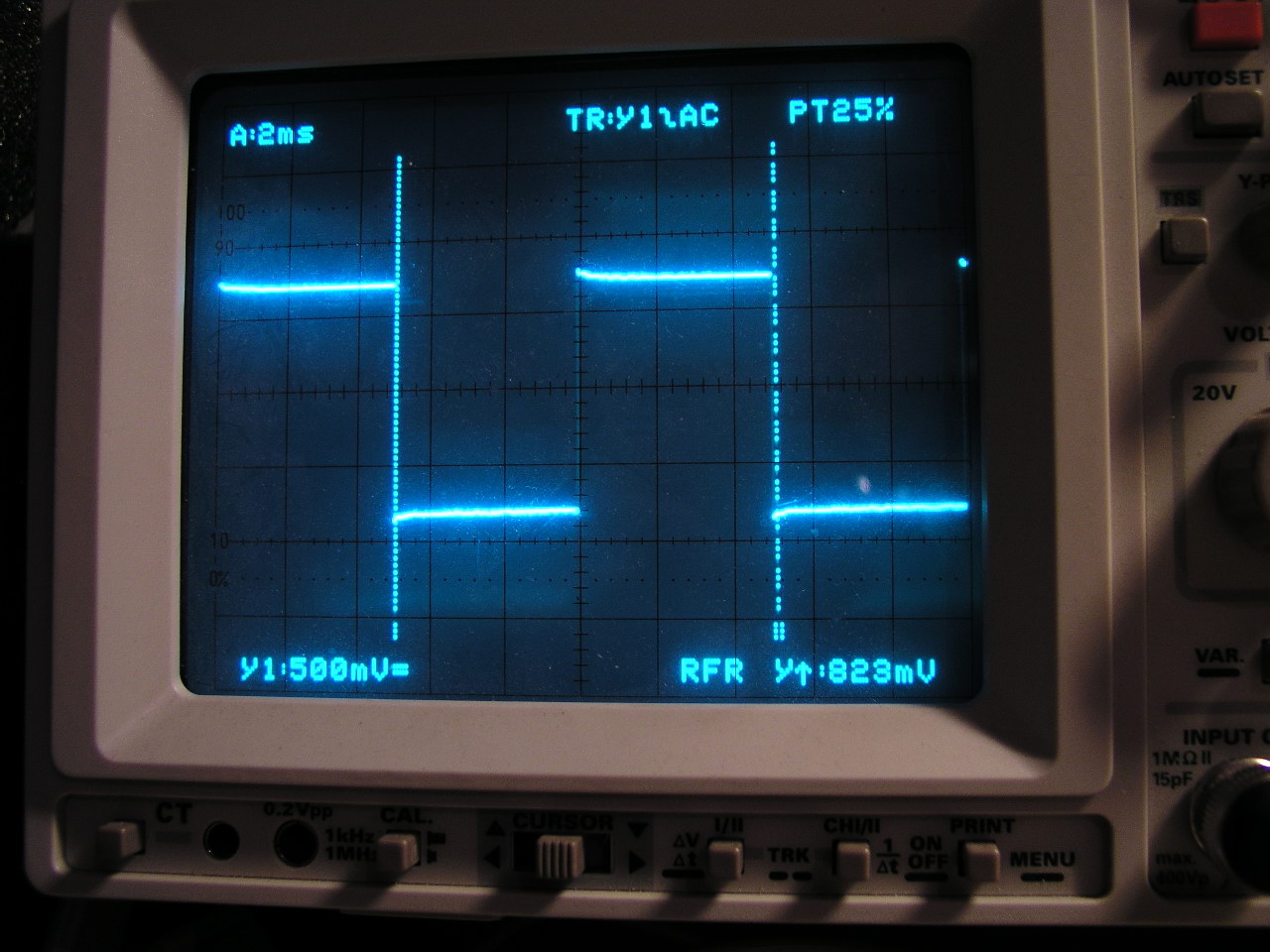

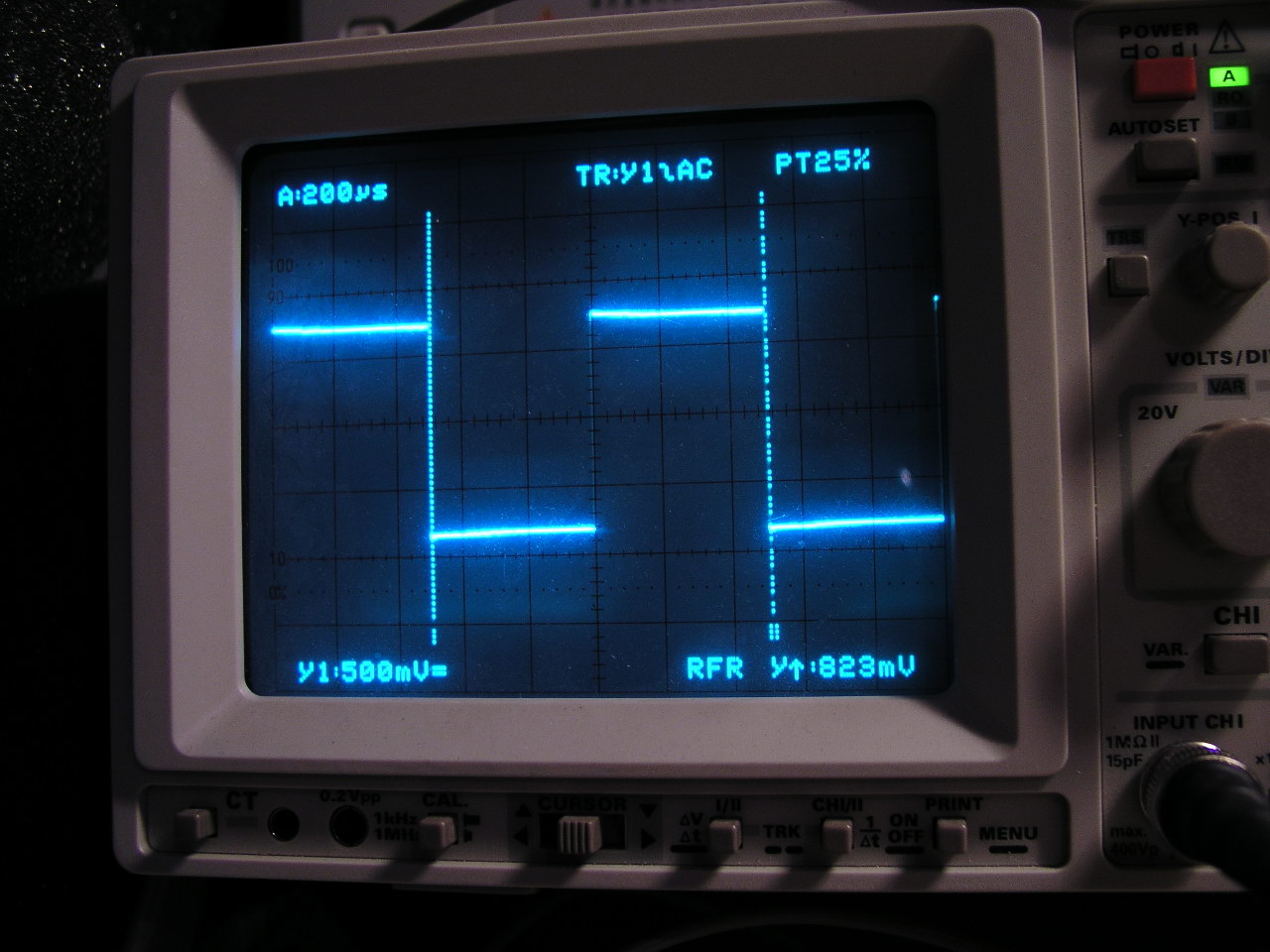

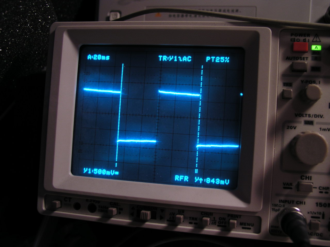

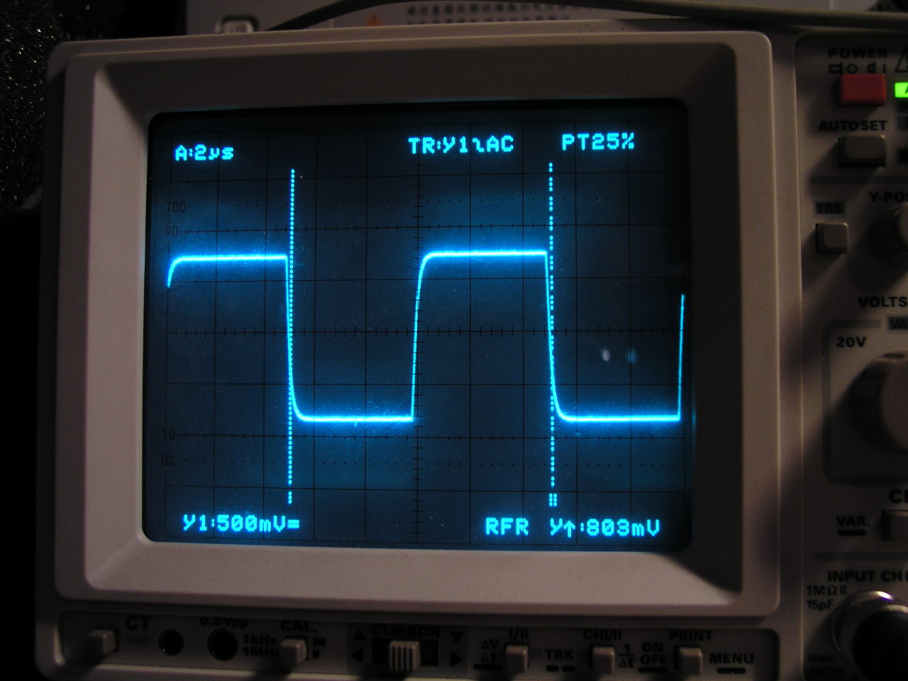

As soon as you're talking about interstage transformers, I can post my case here.
Last week I finalized the winding of a monstrous interstage transformer. This beast weights 7 kilograms and is going to be installed into a 211 SET power amplifier. The output tube is going to be driven in by a 300B through IITC (inverted interstage transformer coupling).
The frequency response of this beast is enormous. Below you will find attached pictures of the square wave response at 10Hz, 100Hz, 1kHz, 10kHz and 100kHz! The pics show the response with the transformer fully loaded!
Such ridiculously high freq response is something not so usual in ISTs...

This IST is wound on double c core iron pieces and is going to drive the 211 output tube inductively by a 300B tube through IITC (remember Shishido's job).
The hardest task is to provide a perfectly linear load on 300B under all operating conditions (both ClassA1 and ClassA2) from subsonics to supersonics. That's why you need mostrously sized iron pieces. This is not well seen here but it is obtainable only if the IST has freq extension so huge like this one.
