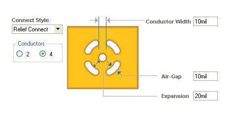

a little off focus, but could someone explain to me the difference between a pad connecting to a surrounding trace all around, or by four little "bridges"?
Example of all around: C5 pads on latest PCB
Example of 4 bridges: D1 pads
is there a difference?

It's called heat relief connection, and its purpose is to aid soldering when pads are placed on large copper areas.
Without those little "bridges" you wouldn't be able to provide enough heat to allow solder fill up the hole completely, as the heat would spread into surrounding copper. This is especially critical when the copper plane is in top layer, and soldering is done through the bottom layer pad.
Removing components, with pads on large planes, is rather hard without heat relieves in place and it's very easy to damage through hole plating in such cases.

Thanks Peter, would never have guessed... I was sure it had something to do with a better connection, but less conductor area in my mind means a worse connection...

Without the heat relief traces, it is hard to solder the components connected to the planes. The diodes can be attacked from both sides, and a good connection can be made without the relief traces.

Also, not properly solder filled holes (on the big caps for instance) is more trouble than those little "bridges". From what I see, Brian used 60mil connect traces on large cap relieves, which gives combined width of 240mil, which at this length (15mil) is plenty.
