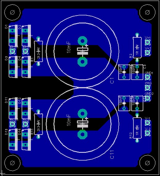

1. I still think R3/R4 should be to the side of the filter cap as it gives you a more compact design.
2. Also to make the design complete, why don't you add a "power on" LED and resistor. This LED would indicate power on and the charge status of the cap. It would also help the cap discharge process. This could be located close to R3/R4. Allow people to have the LED on board or run wires to the front panel.

Board now supports 30mm caps as well

Here is a screenshot of the board with R3/R4 on the side to allow for 30mm caps. I will look into adding the resistor for the LED. I had planned on doing this a while back, but forgot about it.

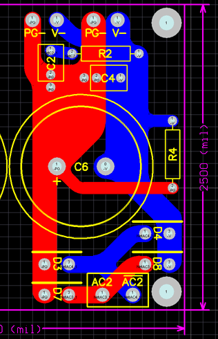

I reworked the layout again, and here is a version that would support 25mm, 30mm and 35mm caps (snap-in type with 10mm lead spacing and 2mm holes are provided for mounting leads):
BLUE = bottom layer, RED = top layer
I didn't add any heat-relief traces yet for the components mounted to the main planes (or beefy traces), and I am considering this now.
I am now leaning more towards making the LM3886 pcb set the same size as the LM3875 pcb set with normal rectifier boards, and offering the "snubberized" pwr supply pcb seperately, to allow for more flexability. Any comments?

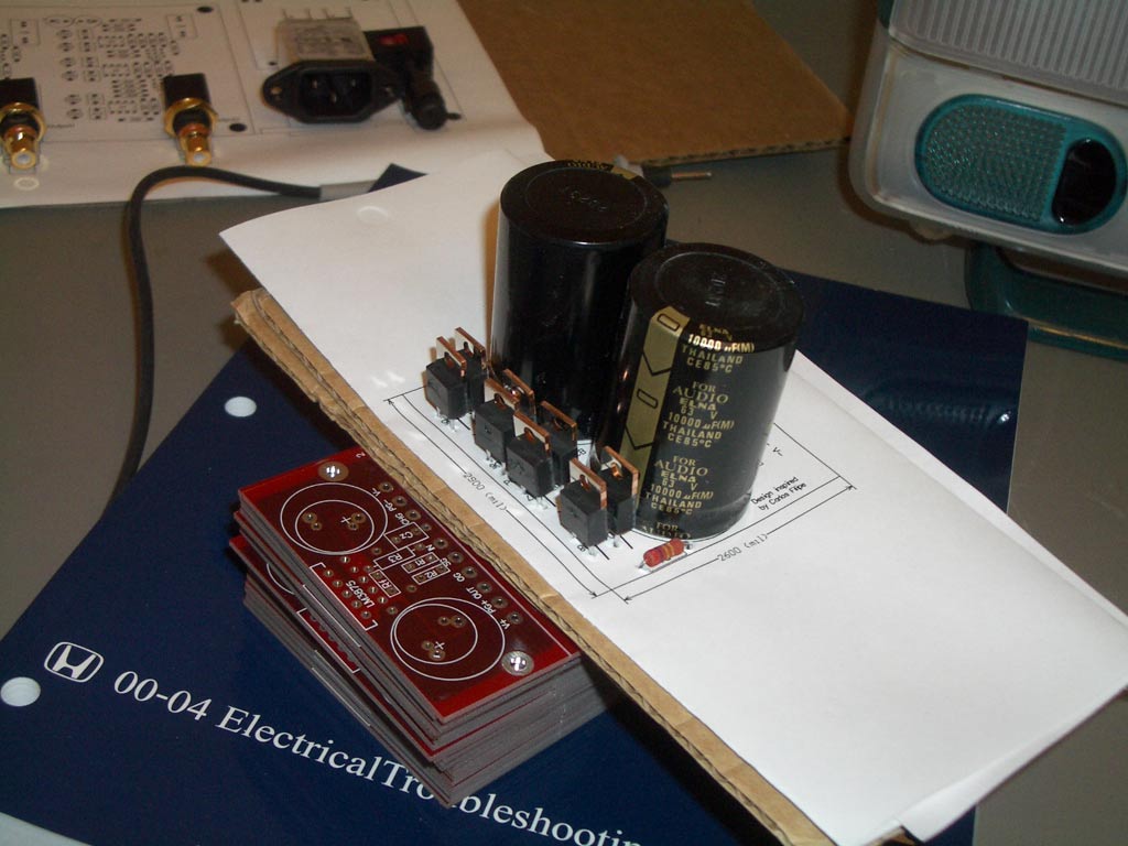

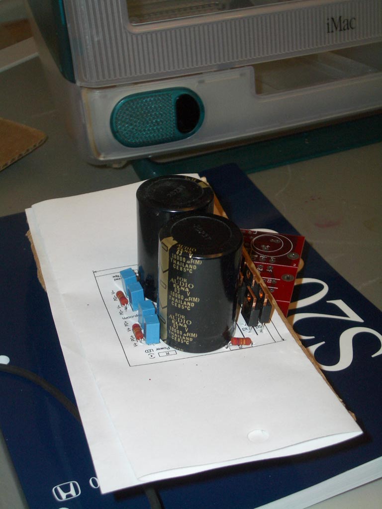

Here is a mockup of the pcb in the actual size with 35mm caps installed on the pcb. Board width is the same as the current LM3875 boards:

To Brian : Why are you using two rectifiers ? It have sense only in case, if you can use voltage regulators and have only one polarity one. With center tapped and center grounded transformer you get the same ripple effect by better efficiency. " Ringing " on both rails you can in this case dump by +/- bypasing capacitor, 'cos " ringing " periode is on both rails in opposite polarity.
BrianGT said:I am now leaning more towards making the LM3886 pcb set the same size as the LM3875 pcb set with normal rectifier boards, and offering the "snubberized" pwr supply pcb seperately, to allow for more flexability. Any comments?
I think that is a great solution, much easier for you than custom matching boards. So i guess the LM3886/LM3785 would be similar to the kits offered in the past. Which means one could buy a single snubbered supply board with the components not offered on the standard kit for an extra cost.

The last PCB looks really nice 😱 😀 Thanks for upgrading for 35mm caps 😎
