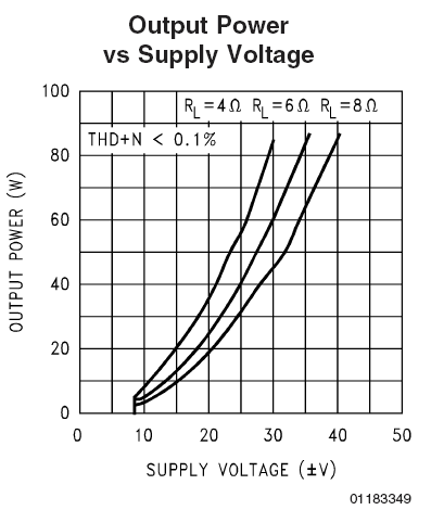

The limiting factor for the power supply board is the heat dissipation for the diodes. Without heatsinks, 1 board can power 2 channels of the gainclone without the diodes getting too hot. I have not taken any measurement to see how much current this is. If you were to put heatsinks on the diodes, the power supply board would work for most applications. Also, I am currently not selling the power supply boards seperately from the pcb sets.
National has some suggestions on power supply voltages in the LM3886 data sheet:
"68w cont. avg. output power into 4 ohms at Vcc = +/- 28Vdc
38w cont. avg. output power into 8 ohms at Vcc = +/- 28Vdc
50w cont. avg. output power into 8 ohms at Vcc = +/- 35Vdc"
I attached a graph from the datasheet as well.
Link to datasheet:
http://www.national.com/ds.cgi/LM/LM3886.pdf
Brian

Thats right but does that mean if you are running higher than +/- 28V then you cant run 4 ohm loads as easily or at all? or with less power?
I have read the datasheet, im just not sure how to interpret it.
BrianGT said:National has some suggestions on power supply voltages in the LM3886 data sheet:
