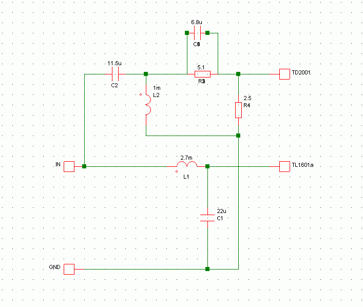

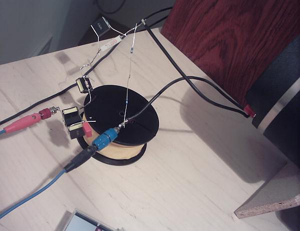

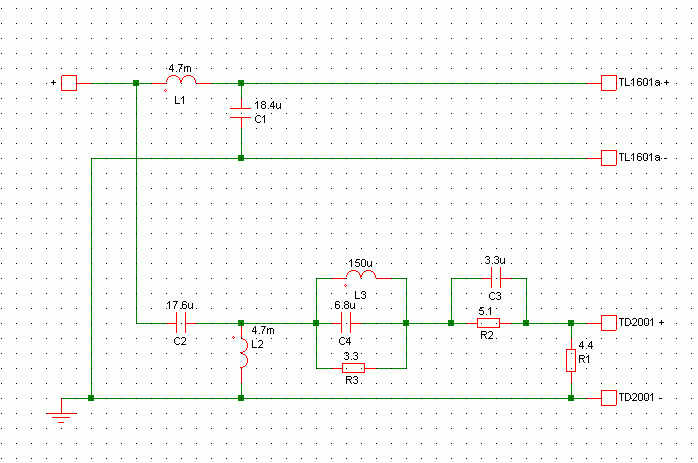

ok, i don´t know enough about crossover design. What i did last month i fiddeling with the crossover, change parts, descide sound is wonderfull now, and find out next day ist worse than before.
At the moment the crossover looks like this, i don´t know if this is a sensible design, it grew by trial and error, not by calculation.

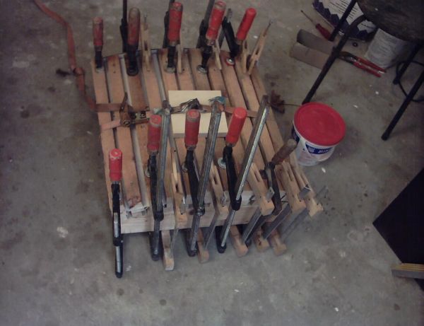

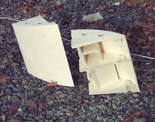

material i needed so far:
- 2 TL1601a
- 2 TD2001
- cherrywood, about 0,1 m^3
- aluminium, cylinder of diameter 100 and lenght 120 mm
- about 300 screws 5*50 torx
- 2,5kg PVAC glue "Bindan P"
- some m of 32*32mm wood for the corners of the box
- 3m^2 of 3mm birch ply
- 3 pieces birch mulitiplex 20mm, each 1.5m*2.5m
- uncountable parts for xover trial and error

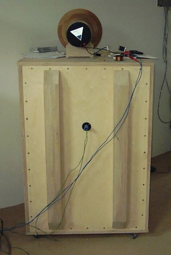

backside, stiffended by 80*70*970mm Multiplex. Neutrik connector.
- 2 TL1601a
- 2 TD2001

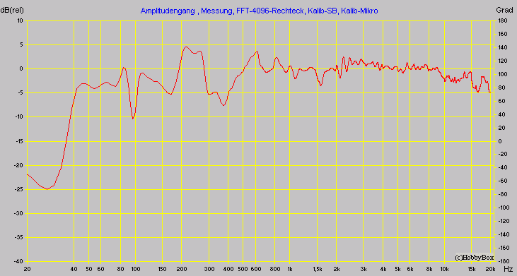

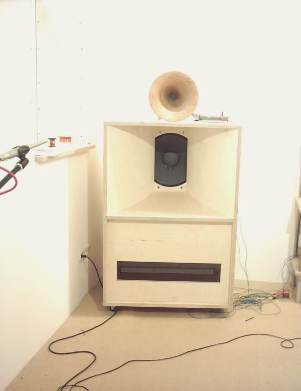

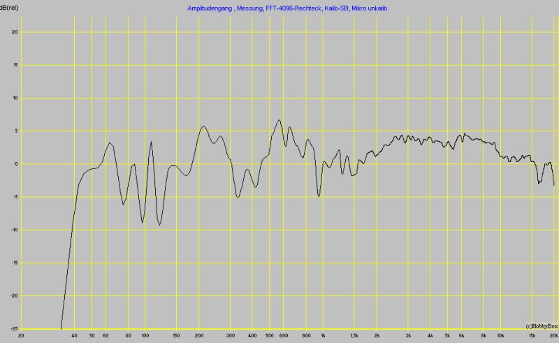

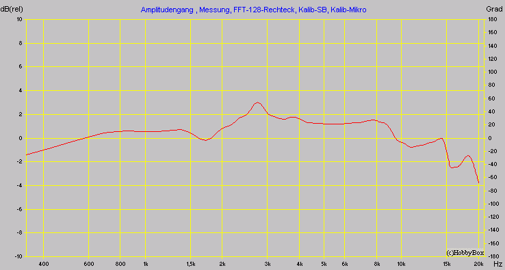

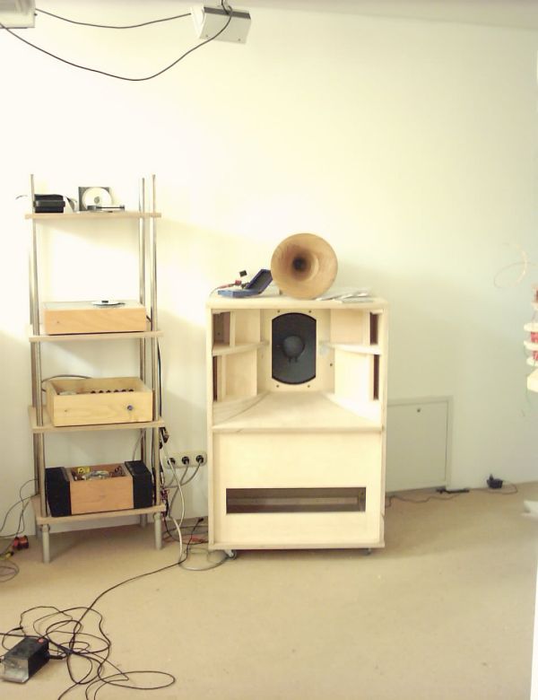

Now the 828 - horns have a real flare made from wood, i made hundreds or thousands of measurements, swaped parts in the crossover for uncountable times.... The horns look like this
now. The crossover at the moment is simple second order low pass 2,7mH / 22uF for the TL1601A and for the TD2001 first order high pass with 15uF and padded down 10dB.
There is no damping material inside the box.

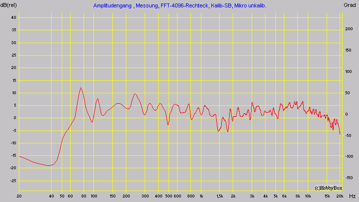

This was measured 85cm in front of the speaker, 8cm below axis of the TD2001. The room is very small, about 3,5m * 3,5m
