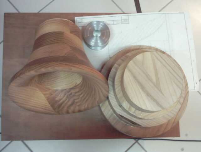

What kind of big lathe do you need to turn these. I have always been fascinated with the idea of doing similar things.

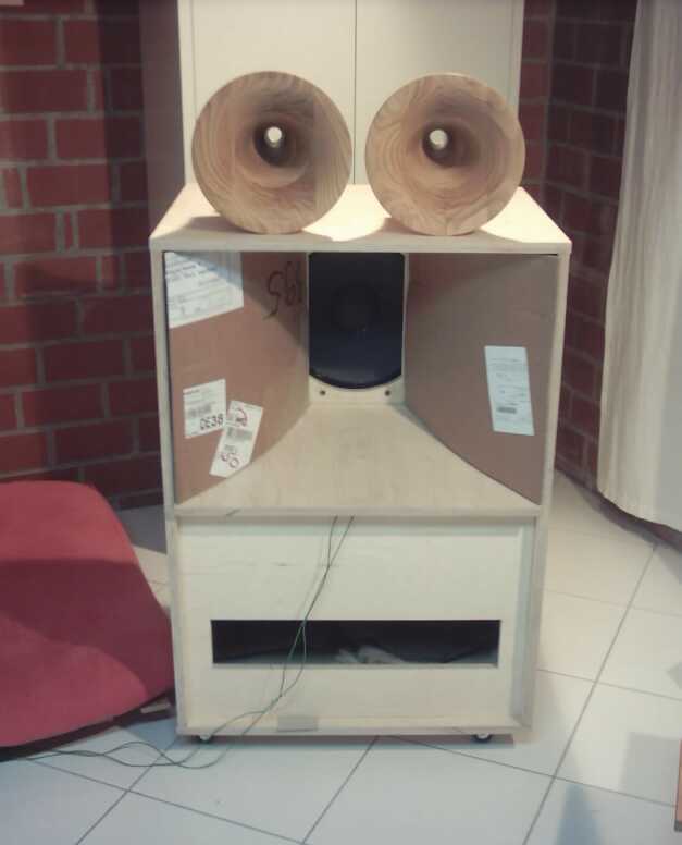

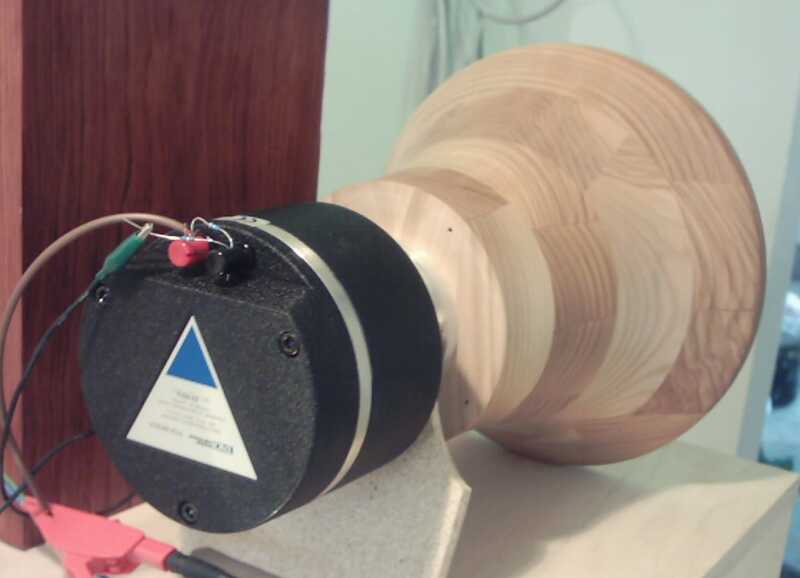

planet10,
you don´t need a really big lathe.
I use this: http://www.killinger.de/km2000s/km2000s.htm
OK, i would like to have a bigger one, but they get very expensive.

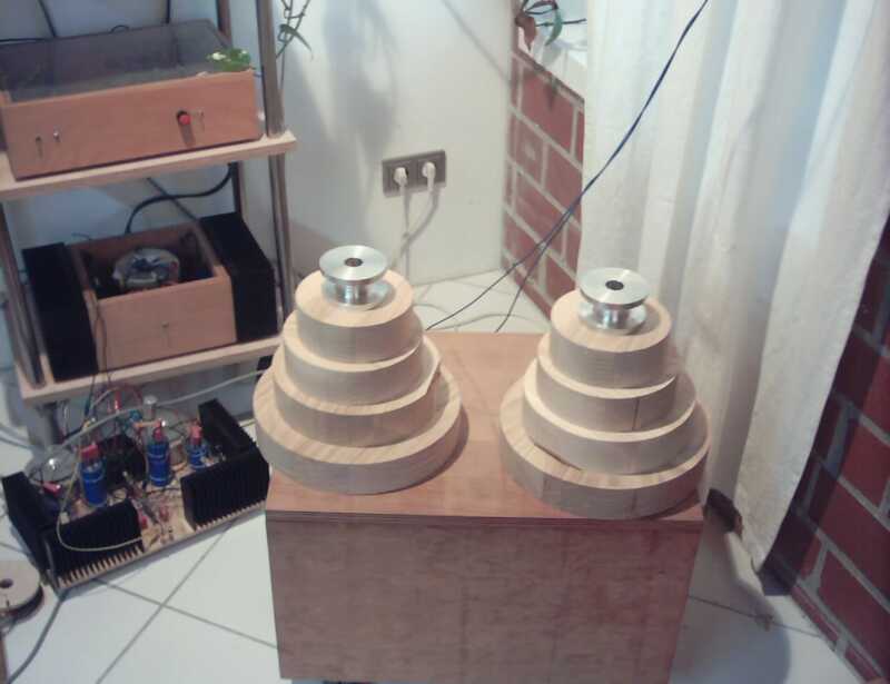

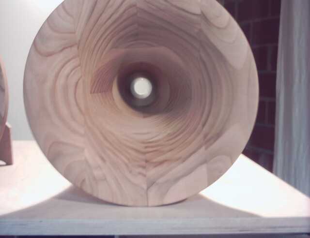

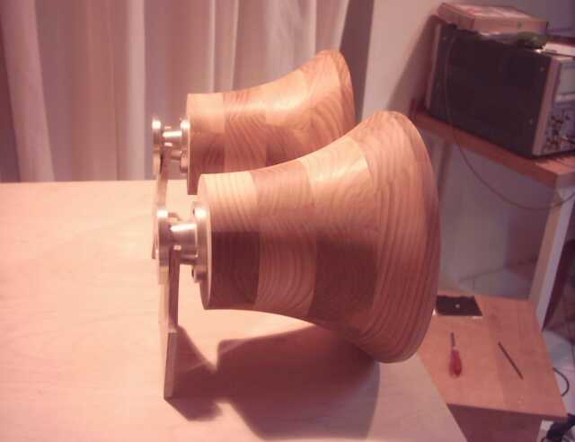

The problem if you want to turn a wooden horn is only the inside. How to get rid of the material in the inside that should be away. You can´t work with a hand - holded tool very deep inside the piece you turn. So if you piece of wood is too long you have to make some parts and glue them togher - like prototype one. Two will be one part wood, one aluminium. An other way would be to make a special drill to drill out the material, but this counts only if you want to build a lot of similar horns.
I would also like to make some not circular horns, but i have no drawing at the moment, and i´m not able to do the calculation . I wan´t to build one like this: http://www.pioneerelectronics.com/Pioneer/Images/IndustrialTADProduct/TH-4001a2.jpg
anyone want´s to make the drawing?

Brett, yes like that. I know the pdf. For me the pdf contains not enough information to build one. Only way would be print 1:1 and use it as a template.
There is no drawing of the fins inside the horns. I don´t know whats hypex. A hperbolic shape?
I will go on with my circular tratrix and if there will be a good enough drawing of something like the Arai 290 / TAD horn, fitting for TD2001 driver, i´ll try that too.
I used to have another set of better drawings before my recent HDD failure. If I find them I'll email them to you.till said:Brett, yes like that. I know the pdf. For me the pdf contains not enough information to build one. Only way would be print 1:1 and use it as a template.
I calculated the fins dimensions. Rotten job I don't want to do again.There is no drawing of the fins inside the horns. I don´t know whats hypex. A hperbolic shape?
Yes, hypex=hyperbolic
The A290 and A300 are for 50 mm drivers. The A480 is for 25 mm.I will go on with my circular tratrix and if there will be a good enough drawing of something like the Arai 290 / TAD horn, fitting for TD2001 driver, i´ll try that too.

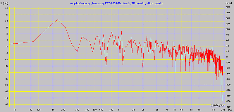

hmm. i tried to do some measurement with hobbybox 4.0 to make a frequency respone plot, but the plot looks very different each time i change something. There is a lot to tune like fft 64,128,...,2048,...,16384, egalistation no, 1/3 octave, spline, recangular, blackman, Hanning, Hamming etcetc. To make a compareable plot what should i choose? else i think the response of microphone and soundcard is not good enough for real measurement. This one is with my croco - wired estimated xover, no egalisation, in a much to small room for this speakers. I fear it contains not much infomation.
