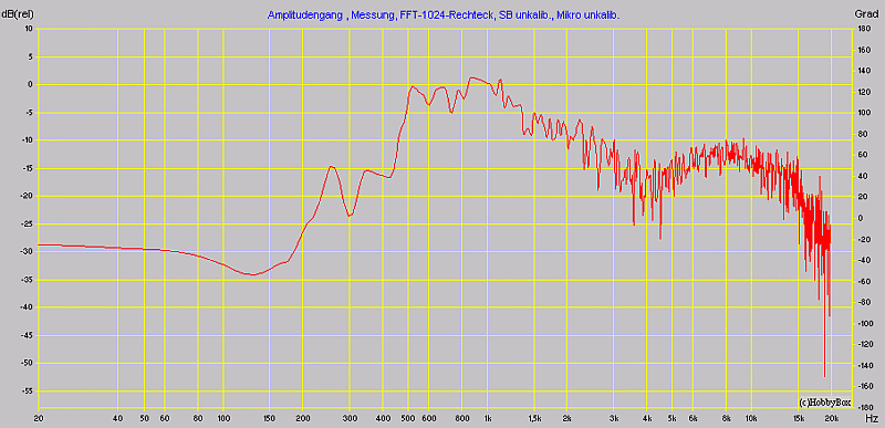

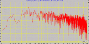

much smaller means 8 or 16 thousand, right? repeat it measured in some meter distance, and make a step response plot only of first few ms. I will do so in the evening. All recomendations until then welcome.
I just started my Hobbybox to see what FFT window-size would be apropriate.
I think that 128 would be O.K.

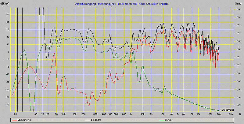

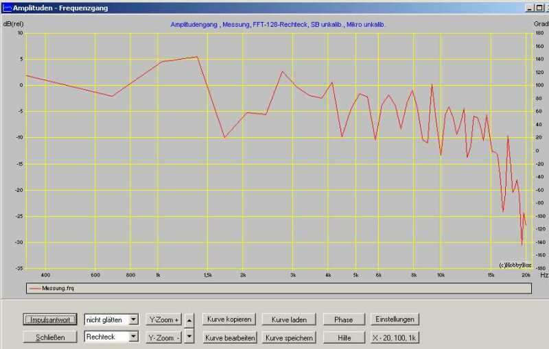

Did I get it right that post #63 is the whole VOT with the HF horn connected via 1st order crosover ?
In this case a measurement length of 128 samples is of course too short. What I wanted to say is that you should try to measure the HF horn alone (preferably outside, with the better mic preamp) with a measurement length of 128.
The fine peaks and throughs of +- 2.5 dB from the last measurementare look very good for a horn !! What bothers me is the "whole" around 4 kHz. But this could be caused by room acoustics and/or the large measurement window. It is always difficult to distinguish between irregularities of the drivers and such of the room/measurement setup ("Wer misst, misst Mist!").
Have you ever tried to feed the speakers any pink noise and looked at the "real time analyser" that Hobbybox offers ?

Yes, 63 is both speakers and first order. The last one i feed my mic preamp with more voltage and measured 1 meter distance. Horn and mic laying on the floor here, next wall about 2 meters away. My impression is in fact the room i´m working in at the moment is too small for measurements and its not so good with a unknowm mic. For outdoor measurement i need the right day (silent and dry) and time too cary all the equipment ouside. I will investigat if University provides my a better mic for this puposes or so.

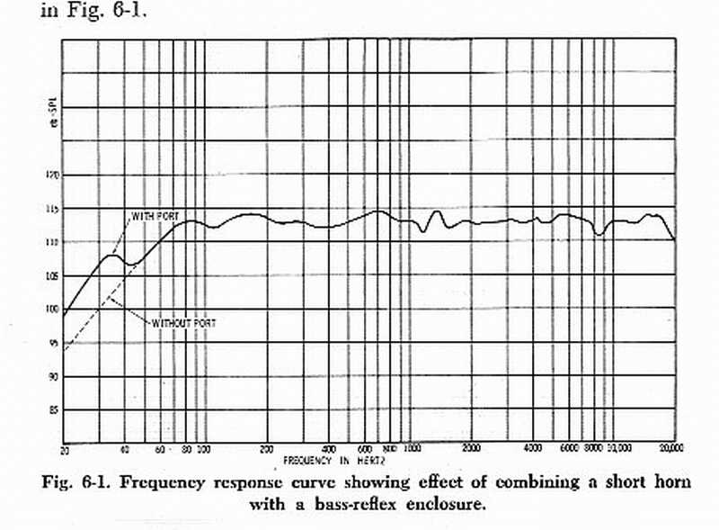

till where did you get that graph showing ported vs nonported results?????

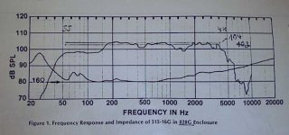

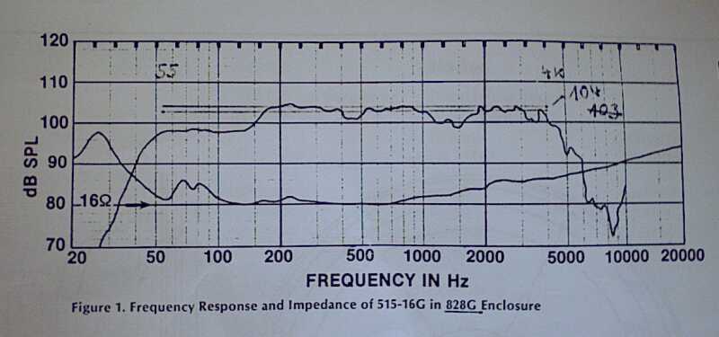

>The original should look like this (?) says the internet.
This is a 'doctored' early A7 published FR from the Badmaieff/Davis book "HOW TO BUILD SPEAKER ENCLOSURES" that's been smoothed to the point of near uselessness below 1kHz, so I wouldn't use it as a guide to judge your own measurements. Also, I didn't read the whole thread, but unless you're driving them with an OPT with ~4ohms output impedance you won't get much of a match with any early OEM Altec published specs.
Really, if you reverse engineer the 825/828 you'll see that your measurement is quite accurate.
