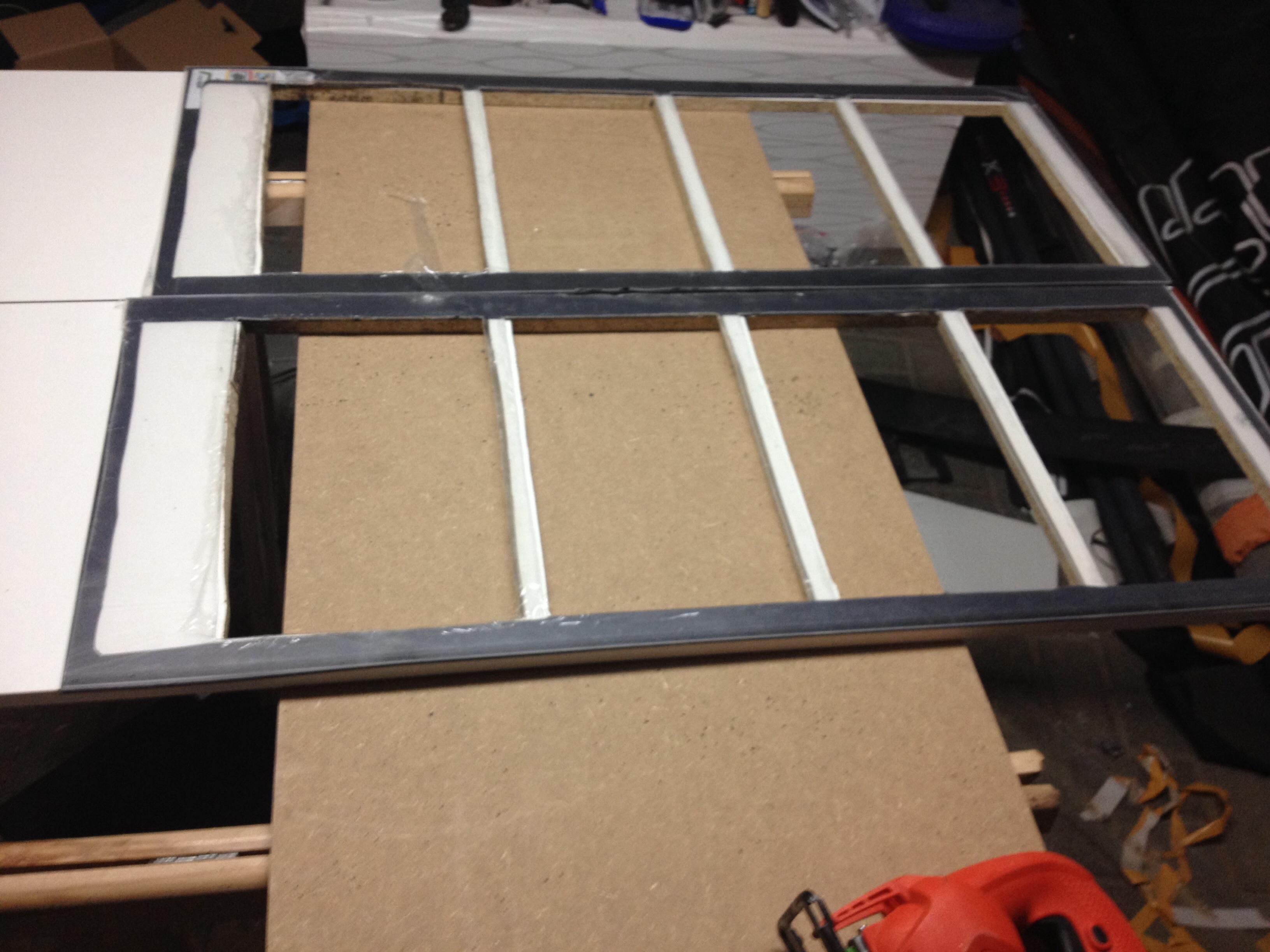

again some nice Input 🙂
i thing, i need to go some processing steps back!
my living room:
wide ~5m
length ~6m
high ~2,4m
the speaker will be placed in a distance of 1m to each corner
the listening distance will be about ~4m to both of the two panels
what width of panel is recommended in my case?
and the high i guess should be as high as possible! right??
i also was getting a very nice idea how to build the frame but i was so endless busy this days... i will do a drawing
however now i will enjoy my weekend and i hope you do the same
with that words CHEERS
Paul

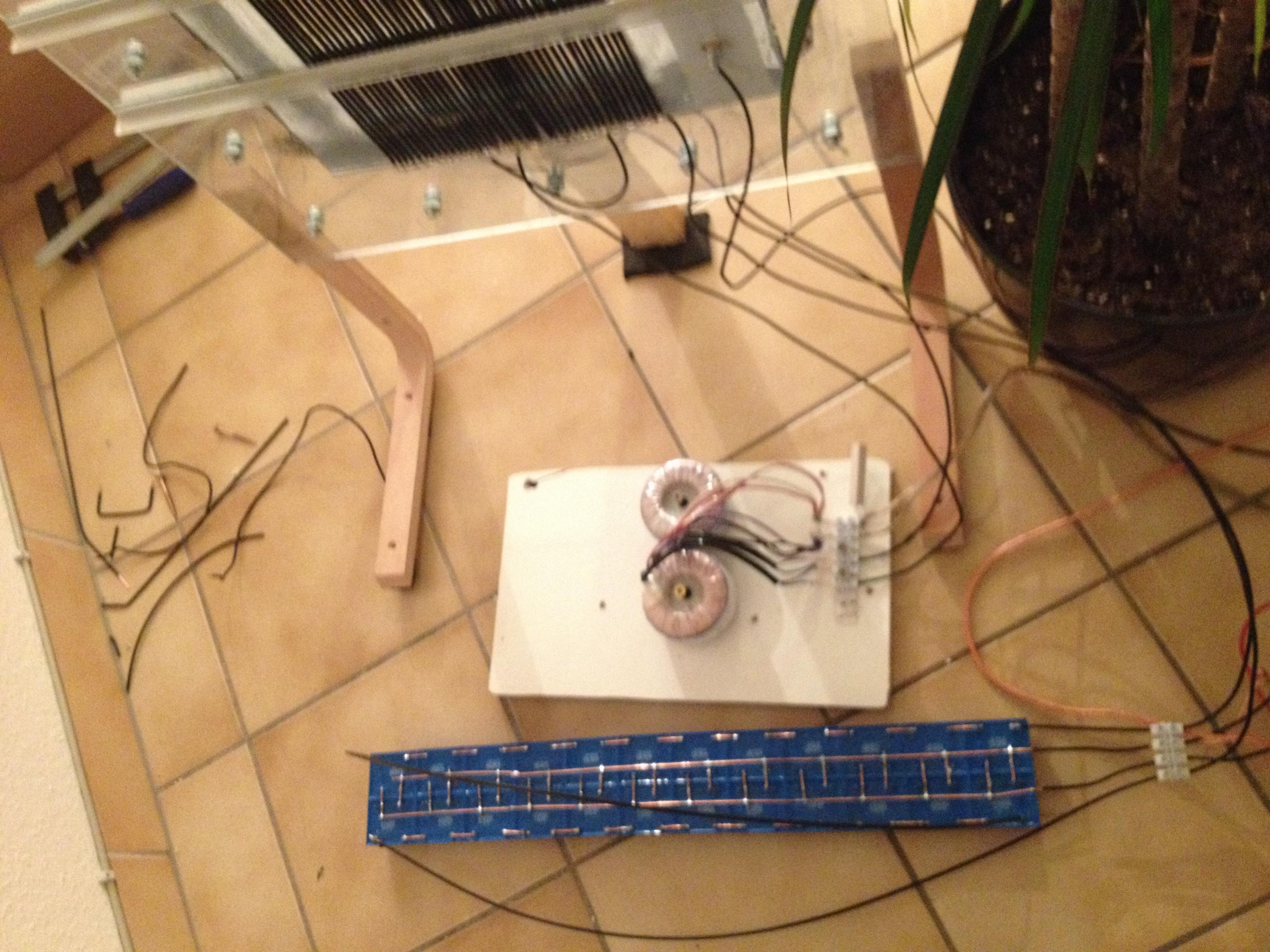

Transformer
I got a question about transformer.
As far I have understand I can calculate as follow
If I use one transformer 230v/12v @50Hz
Then I can feed the transformer
12v @50hz
24v @100hz
48v @200hz
And 6v @25hz is this correct?
Also how is the behavior if I use more then one transformer?
I using a lot of smale 5va 230v/12v trafos 12v side connected in parallel and 230v side in serie I get zero output below 50hz is there a simple reason why?
The actual panel size is 20cm *70cm d/s 1,5mm
Attached a picture
Best regards Paul

Yes, You are correct at the feeding the transformers at the voltages you have stated as per lowest frequency before saturation occurs.
Using 5VA transformers may work only to a limit and not at all very well for the lowest frequency's.
It takes a lot of iron to get decent performance in THD at low frequency's.
Also since the primary's inductance depicts what impedance the amplifier will see at those frequency's it will quite low as well and even lower every time you add another primary winding in parallel!
Two things that can be happening providing that the transformers are still working and are not shorted or open, is that the performance at 50hz is so low that dipole cancellation is causing you not to hear the signal.
As I mentioned the impedance may also be so low at that frequency that the amplifier can not produce enough voltage swing to make a difference.
Even a single Antek AN-1206 has an impedance of less than 1 ohm at 60hz using the 6v winding as shown here,
http://www.diyaudio.com/forums/planars-exotics/161485-step-up-transformer-design-6.html#post3404300
So to parallel another primary this impedance would be cut in half again not to mention the onset of core saturation at only 12Vrms.
It is also likely that with a 5VA transformer the windings will be of a very thin gauge wire and will not last long (if at all) for such heavy current surges from the amplifier.

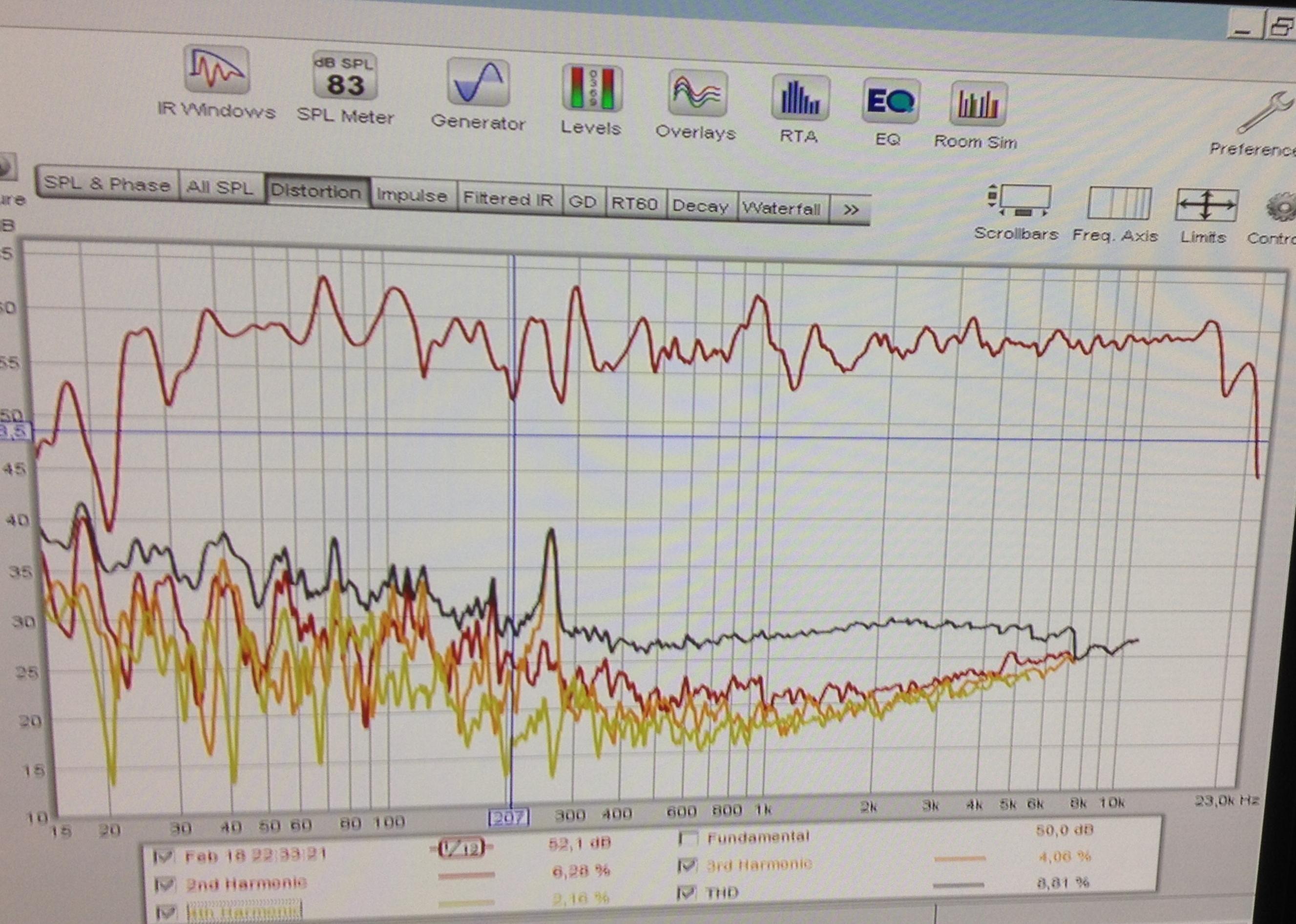

Hi, 🙂
I was using a multimeter to measure the output voltage
But the multimeter was so rubbish that it was not able to measure a voltage lower than 50Hz
However I do get some output
I using 24 of this smale transformers (230v/12v 68%) waht will give a step up about ~300
This is working ok up to ~2000hz
Also I was able to equalize the dipole cansellationn but for real depp bass the film was running into the stators at about ~20/25Hz
Has ever build someone a real tow way esl?
Regards

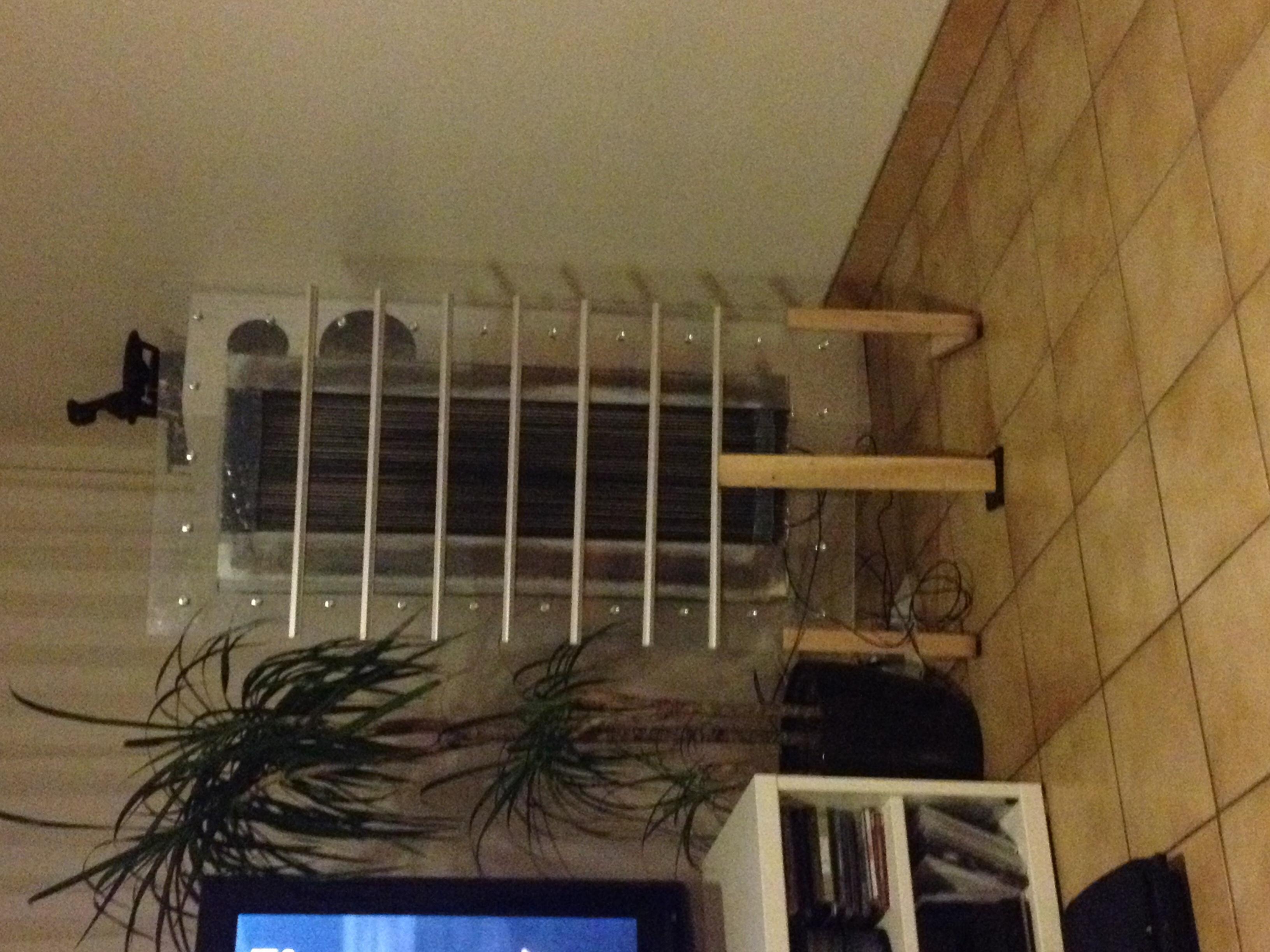

thanks for info
i will not use this small trafos for high frequencies it is cut off about 1500hz
above this frequencies tow 230v/6V 50VA ring trafos are used
it was just a test how it works...
however my idear is to combine both
as fare i get it:
if you want bass you need a high stepup and large D/S
if you want a tweeter you need low stepup and lower D/S
if you do it with one transformer it will get very expensive and also it will be limited with bass effective
are my thoughts stupid?
so way not doing a tow way ESl?
has ever someone done one?
what size does you recommend for tweeter and bass section and also what individual D/S?

Hi Actimel
The two-way solution does not solve your main problem. The transformer requirements are determined by the step-up ratio and input voltage rating at your chosen low cutoff frequency. Taking the top off and driving it from a second transformer does not change the problem at low frequencies.
It does however, take the heat of the transformer design in respect of bandwidth.
One practical solution (what I did) is to stack small toroids - secondary windings in series, primaries in series or parallel to get what ever input voltage rating you want. I used 16 small toroids in each ESL. Do NOT use transformers with twin 115V windings! - you'll have problems with breakdown and bandwidth.
A cheaper alternative is a custom transformer, but you do need to know what you are doing. If you have a segmented ESL, do not buy commercial ESL transformers - they will have too high a capacitance for a segmented design.

it might be unclear what i was talking about or it is lost in my translation 🙂 ...i´m sorry i will try to be more accurate.
what i mean is one ESL
feeded by two amps
each amp is connected to one transformer
so a full active physical segmented tow way ESL 🙂
feeded by two amps
Changing the D/S spacing doesn't change the transformers requirements for the lowest frequency's except that a higher ratio or more drive will be required.
Or to compensate for a larger D/S you can just simply raise the bias voltage.
Increasing the ratio effects the load impedance that the amplifier will see and can be sometimes to much ( Too low of ohms) for your typical amplifier.
Theoretically it should be easy to drive an ESL at low frequency's but it is the transformers primary inductance and core size that will determine its performance as i had already mentioned.
When i was experimenting with multi-stacked toroid cores I had found the the more iron i used for the same voltage level and transformation ratio the lower the THD got for frequency's at 30HZ and lower.
But using many many cores compounds issues for the higher end of the bandwidth as well.
Read through these sections for more detailed info,
http://www.diyaudio.com/forums/planars-exotics/218107-els-transformer.html#post3130853
http://www.diyaudio.com/forums/planars-exotics/161485-step-up-transformer-design-5.html#post2168434
This system here is a Two-Way system and he used some Oil Burner transformers for the bass section,
http://www.diyaudio.com/forums/planars-exotics/181041-my-2-nd-esl-attempt.html#post2431460
jer 🙂

so you recommend me to do a square wave test to qualify my bass step up transformers
i´m using REW what settings should i put in to the spl Generator?
i can measure only Sound output dataset
also till know i could not find were i can measure like an ozilluskop is this possible with RWE?
Regards Paul
thank you for the link´s
the 2:nd ESL-attempt tread is very informative and present a handsome built
Regards Paul
