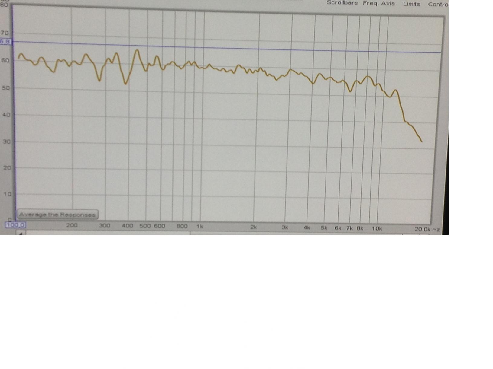

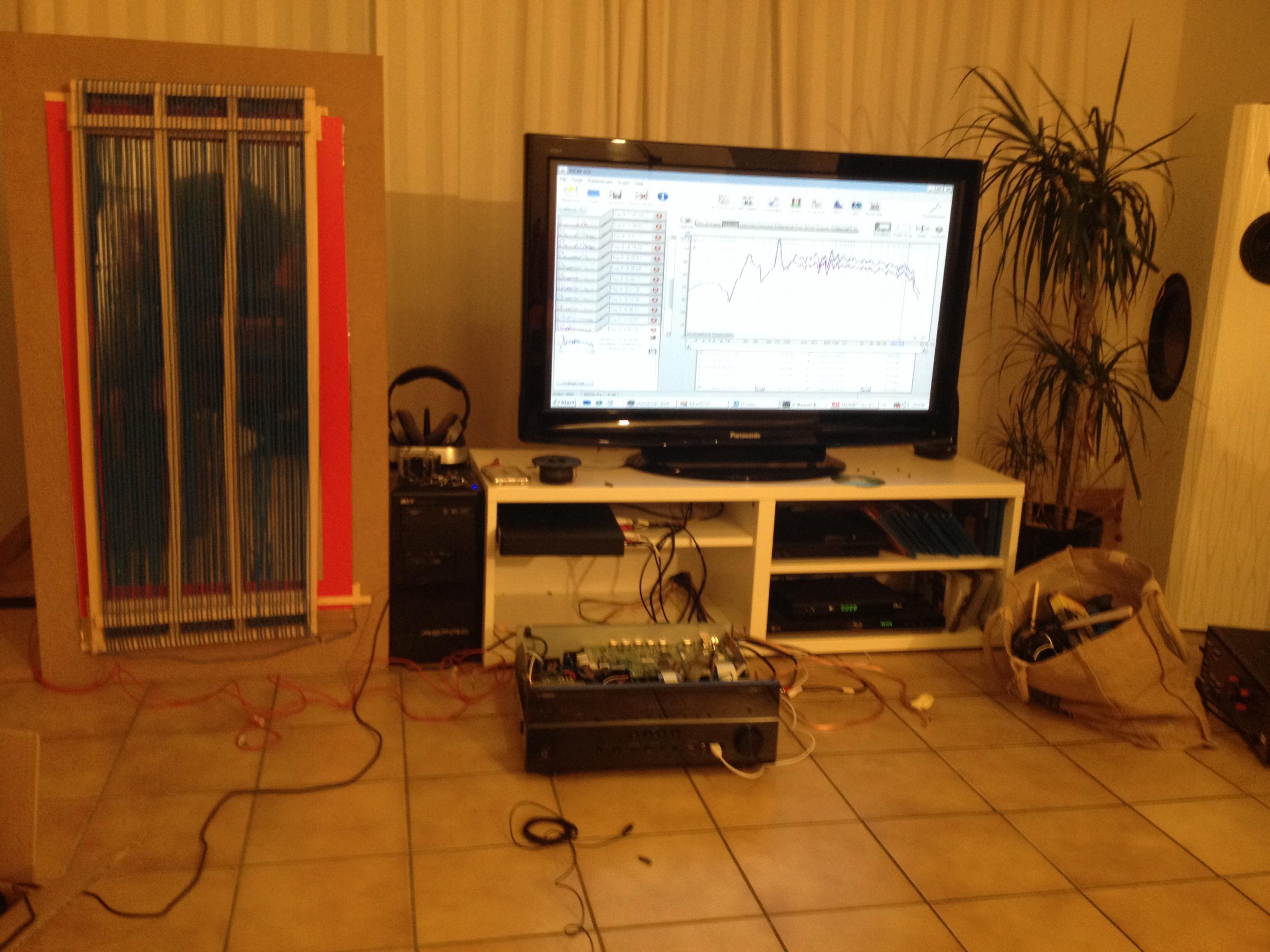

I had build an ESl:
size 84cm * 38cm
each stator tow Transformer 230v/18V voltage amplification about 160
foil voltage about 5Kv
stator distance about 7mm
all is kept in low budget ~250€
During my measurements I had detect some strange behaves were I'm not sure were it comes from.
I guess it is the Transformer but maybe I'm wrong!

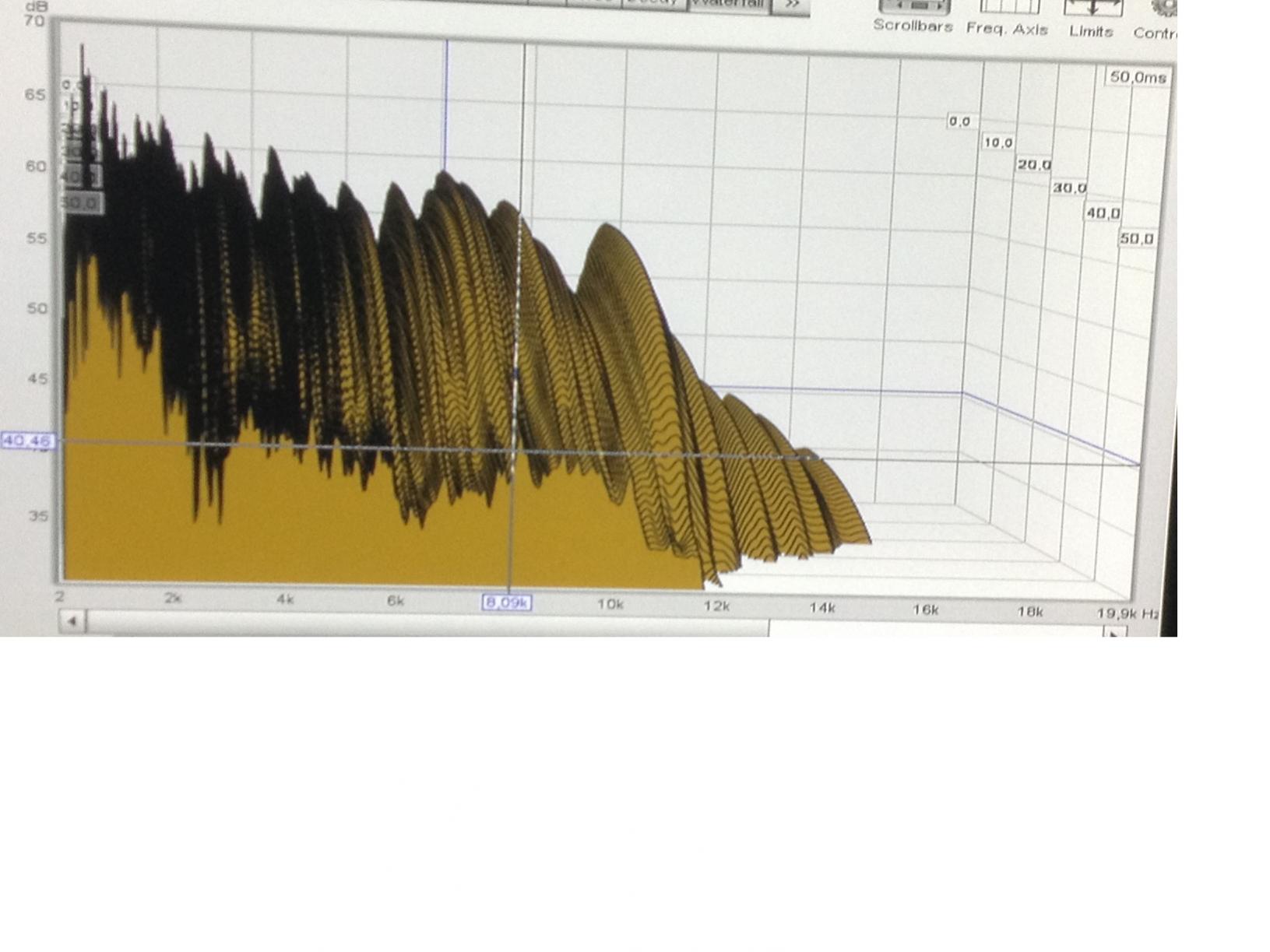

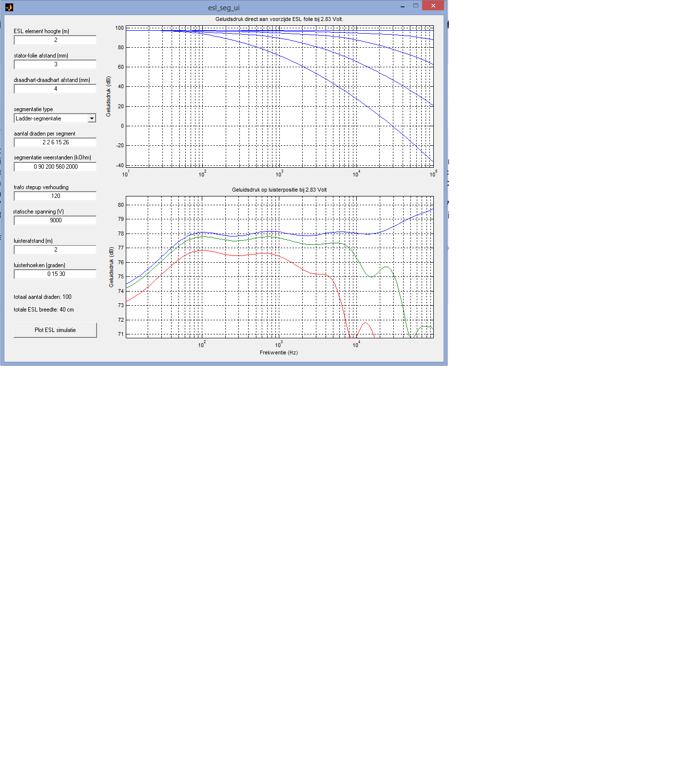

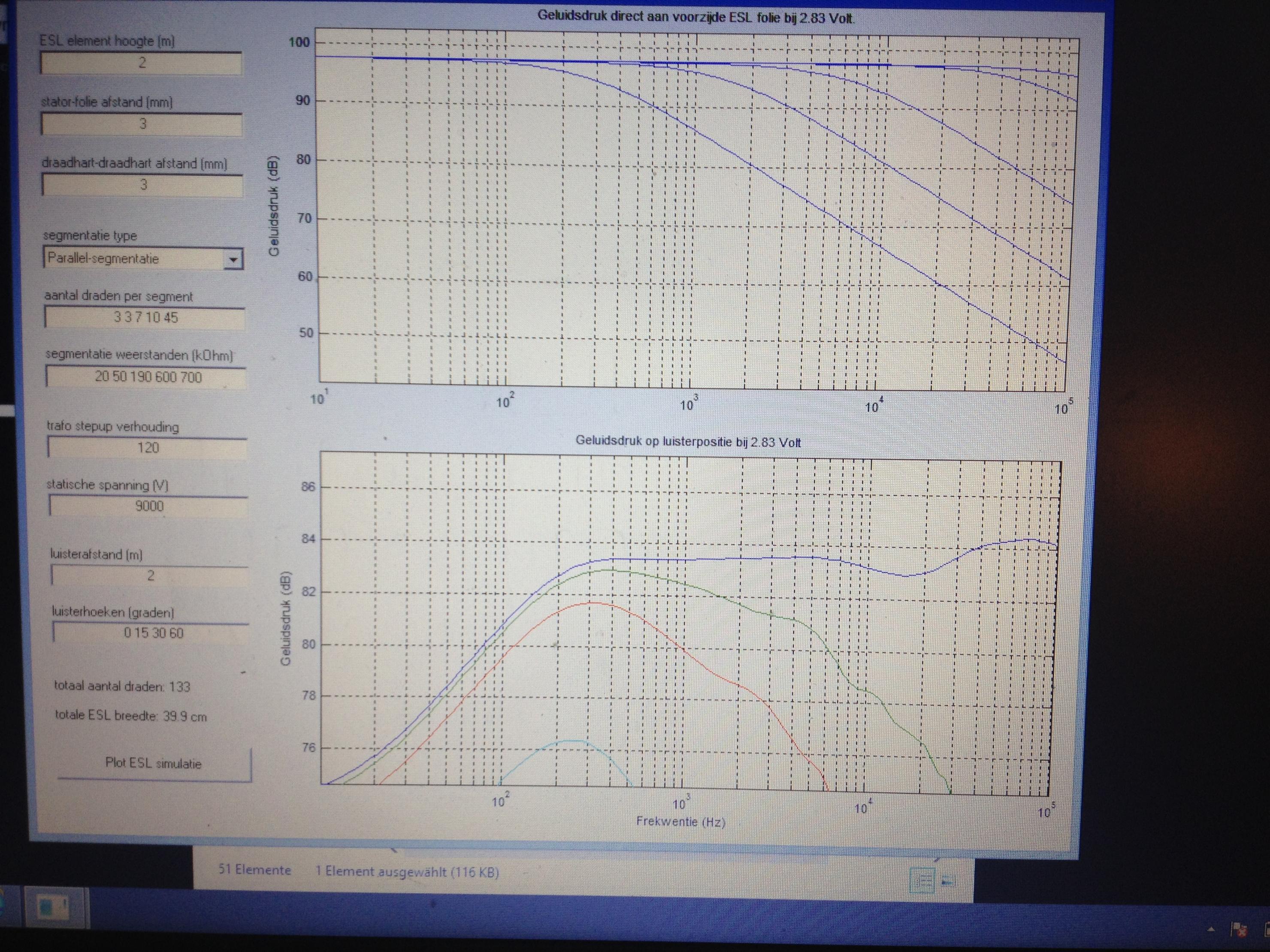

Can someone explain me were the waves are coming from (attached picture "original smoothing 1/6)?
the level of sound was going up and down
Also I'm wondering about the waterfall diagram! I can´t understand it is this a normal locking for a dipole measurement what was done inside a room? ( attached picture "wf" )
All measurements was done inside my living room
The ESL distance to the wall behind was about 1 m
The microphone distance was about 2 meters from the ESL
measurement software RWE
Microphone UMK1
The final result is locking ok but I believe there is a lot of improvement possible!
Best regards Paul

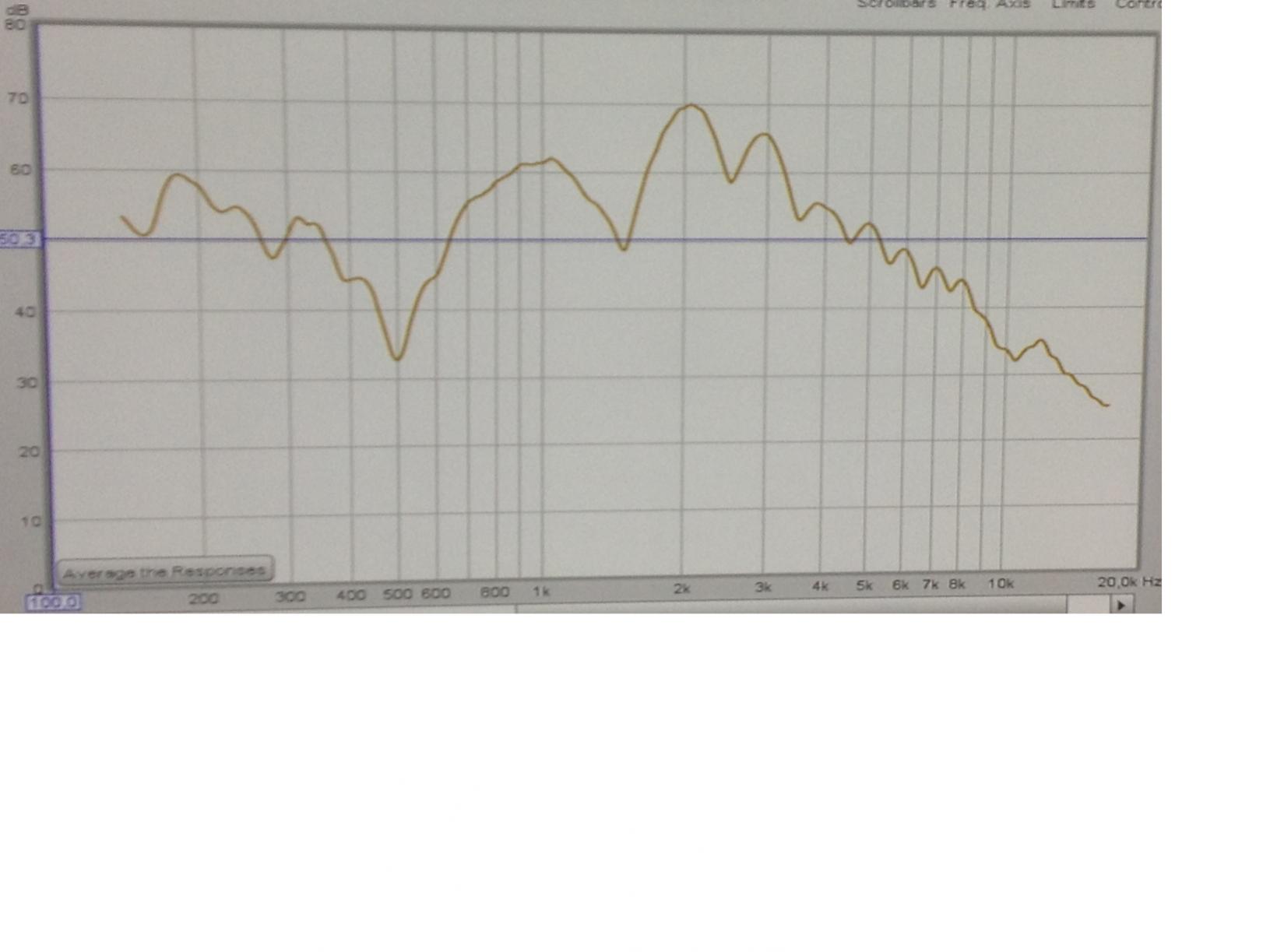

it remains unclear what You´ve measured.
What are the differences in setup between the 1st and the 3rd graph??
To get the real behaviour You need a nearfield measurement in close proximity to the diaphragm <=10cm.
Your measurement system probabely allows for setting markers for a ´room-free´ measurement.
If not set properly the room response spoils the graph.
The velocity of sound in air is ~340m/sec.
From that You can calculate the wavelenghts, by simply dividing by frequency, or the Frequency, dividing by a distance or dimension.
With an 38cm wide, and close to double that value high, panel the free vibrating distance of the diaphragm will probabely be between 30-34cm (75-80cm), which coincides with ~1000Hz (~500Hz).
Standing waves on the diaphragm will show up at those frequencies and their multiples.
Also a measurement distance of 2m and a back wall distance of 1m coincide at frequencies of 340Hz and multiples.
So the chosen setup already must lead to a ´rough´ response graph.

the difference of diagram 1 and 3 is that i was using an equalizer to smoothen the response curve

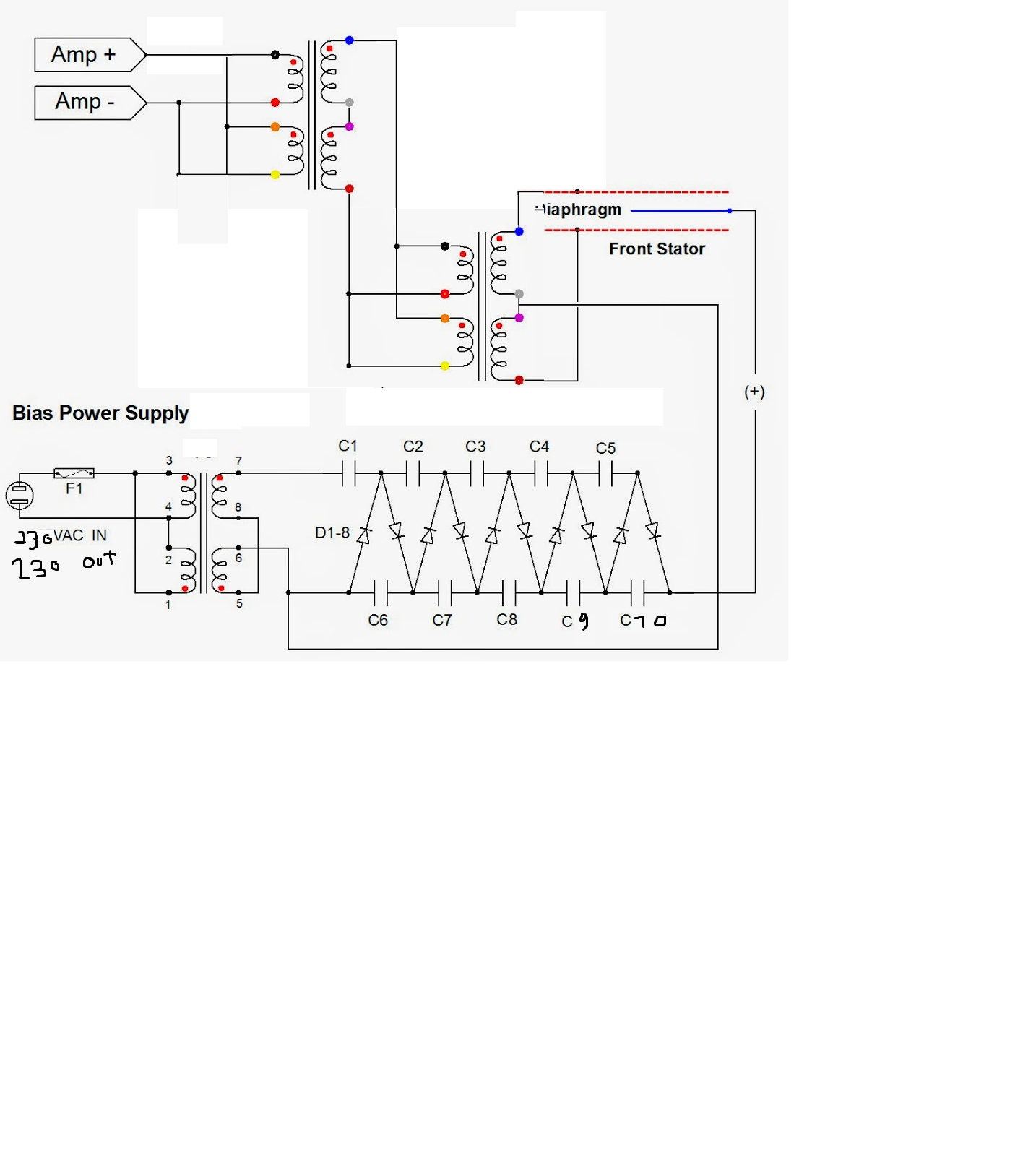

Can you post a schematic of exactly how you have it wired?
They should be wired like this,
http://3.bp.blogspot.com/-G-ojgdj16zs/U4_Fia2CovI/AAAAAAAAA4k/SsA8ompBhtk/s1600/traids+10.bmp
From CharlieM's pages,
Jazzman's DIY Electrostatic Loudspeaker Page: The Electronics Package
If you have one transformer feeding another transformer this will not work good.
This will compound the add extra transformer capacitance's overall lowering the high frequency impedance to the amplifier to a very very low level.
Probably about 90% amplifiers power is wasted in the transformers capacitance and also since the impedance will be very very low the amplifier is not able to maintain the same voltage level at the higher end of the bandwidth.

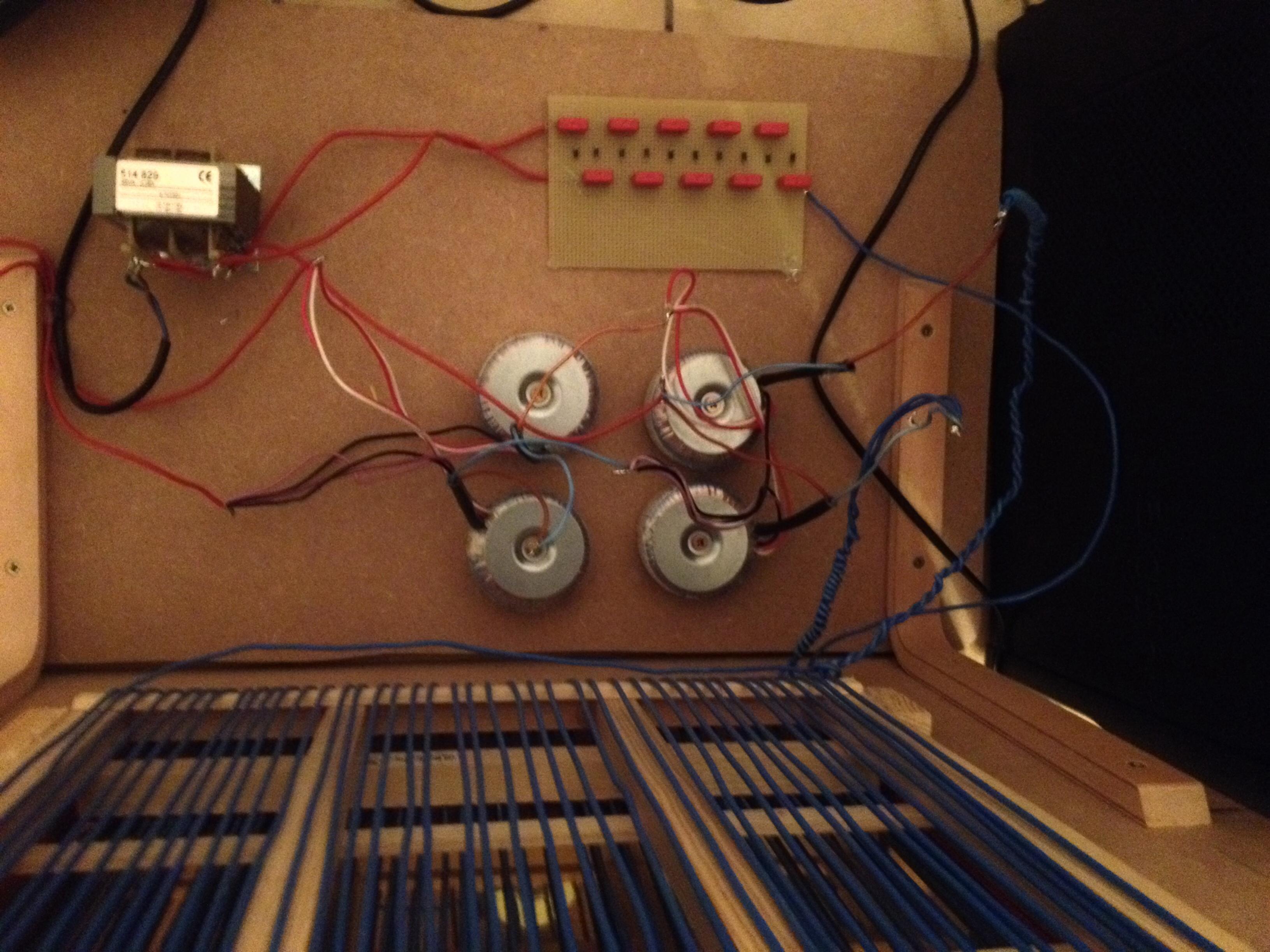

hi,
Attached you will find my schematic also my setup.
The picture is done last week with my mobilephone and i´m not at home so it is not in detail.
You can see currently it is only about function and not about a nice construction.
Thanks for feeding me with the transformer Information i Need to think about it the transformers i was using are very cheap 17€

The ribbon pleater is of no use for esl's.
Are you trying to run them Full Range?
Full Range won't work with your current transformer setup, and still won't very well given their design.
You would have better luck getting two more of those cores and wire them for 18/960 at 1:51 ratio.
Even at this would be half of what you need unless you have a big amp than can produce a large voltage swing.
And what is your bias voltage?
You should have somewheres around 3Kv if not more too at least 6Kv in order to get a decent efficiency from them.
Your current setup shows to be only about 3.2Kv.

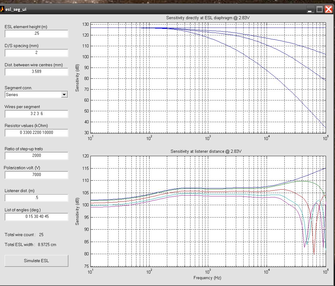

Also have you considered doing a electrically segmented configuration of your stator, since you are using a stator made out of wire?
This will help with a few issues if you do,
First, It will provided for a lighter load for the amplifier at the highest frequency's.
This also will let you run a higher than normal step up ratio as well, this increases the overall efficiency as long as the impedance to your amplifier doesn't get out of hand.
Second, It will widen and even out the horizontal frequency dispersion so that you don't get the beaming effect at the higher end of the audio band.
This beaming starts to occur once the wavelength of the frequency being produced is equal to the width of the panels.
Typically at 1 to 4 octaves and above this is when it is really noticeable.
Third, This technique also automatically EQ's the panel to be flat as well, instead of having the normal 6db rising response caused from dipole cancellation.

as i was listening musik and cleaning up my room the beaming effect was clearly indicated
I thought already about electrical segmentation
but i guess this might be too difficult to get an success
also to be honest i do absolutely not understand this
and so far i understand the beaming is in relation to the wavelength and not in general
it would be a dream if a ESL is constructable with an maximum and minimum beaming factor like´s example 0.3-0.4rad
or is this possible?
😀 and with my first prototyp is a wire segmentation not possible because it's just one 100m long wire coiled on the smaller wood frame 😀
one more question
what is the reason of an diagram segmentation??
you get a not so strong fs but several
isn't is better to have just one fs to get a clear cut off frequenz
or does i miss something??
regards

Physically segmenting the diaphragm works well to a certain extent, This is the method that most use.
However it has its limitation of the widths being set to one size, as electrical segmentation allows the driven area's width of the panel to vary with frequency.
This type segmentation also raises the resonate frequency of the diaphragm, this is okay if you panel is meant to be used in a hybrid system and is okay as long as your crossover frequency is kept at lest octave above this resonate frequency.
Then you have the issue of all of the sections with the same resonate frequency as well, again this is not much of an issue for the hybrid system.
But for full range many use a method of varying widths between the spacers to distribute the resonance's in a wider bandwidth rather than having them bunched up all at one frequency.
This has been under huge debate in a very recent and past threads, but commercial units have shown that this too does work and is quite logical.
Here are the links to a thread discussing a Calculator that is used for predicting electrical segmentation performance in my build.
http://www.diyaudio.com/forums/plan...tor-esl-simulator-esl_seg_ui.html#post2908293
And here is a version that was converted to english,
http://www.diyaudio.com/forums/plan...tor-esl-simulator-esl_seg_ui.html#post3192348
Later on in the thread the writer of this program was kind enough to post the script to this program as well.
There are many more programs and spreadsheets that I used to to predict the dispersion of my panel as well and I have them all listed in my pages at ESLdiy.
If you have any problem finding them or if the links are broken I can send them to you as well.

It takes a bit of fiddling with the resistor values by the time you get a decent result.
The more sections you have the flatter you can get the off axis response.
Using many equal sections seems to work well for some, this way you only need one value of resistor for all of the sections.
I used a width doubling per whole section in my design and the simulation results were quite good.
This is the reason I used 3,2,3,6 for just a 3.5" total width this tames the midrange bump you get in the simulation (see picture).
This cut down on the amount of resistors I needed for such a small panel with 25 rod sections.
Then I did a few simulations using this pattern with added wider sections of 12 and 24 for some much wider panels like yours and the results looked good as well
I also opted to omit the First resistor used to feed the panel at the center section.
This raises the on axis high frequency response slightly but helps flatten out the off axis response were I will be doing most of my listening in my setup.
Then I will also employ an active filter for tailoring this added brightness manually if needed.
This helps to keep the cost of the added resistors down and their power sizes down and the sensitivity up.
You can use LTspice or any other spice simulator to examine the power requirements of the resistors for your worst case scenario, I used Circuitmaker2000.

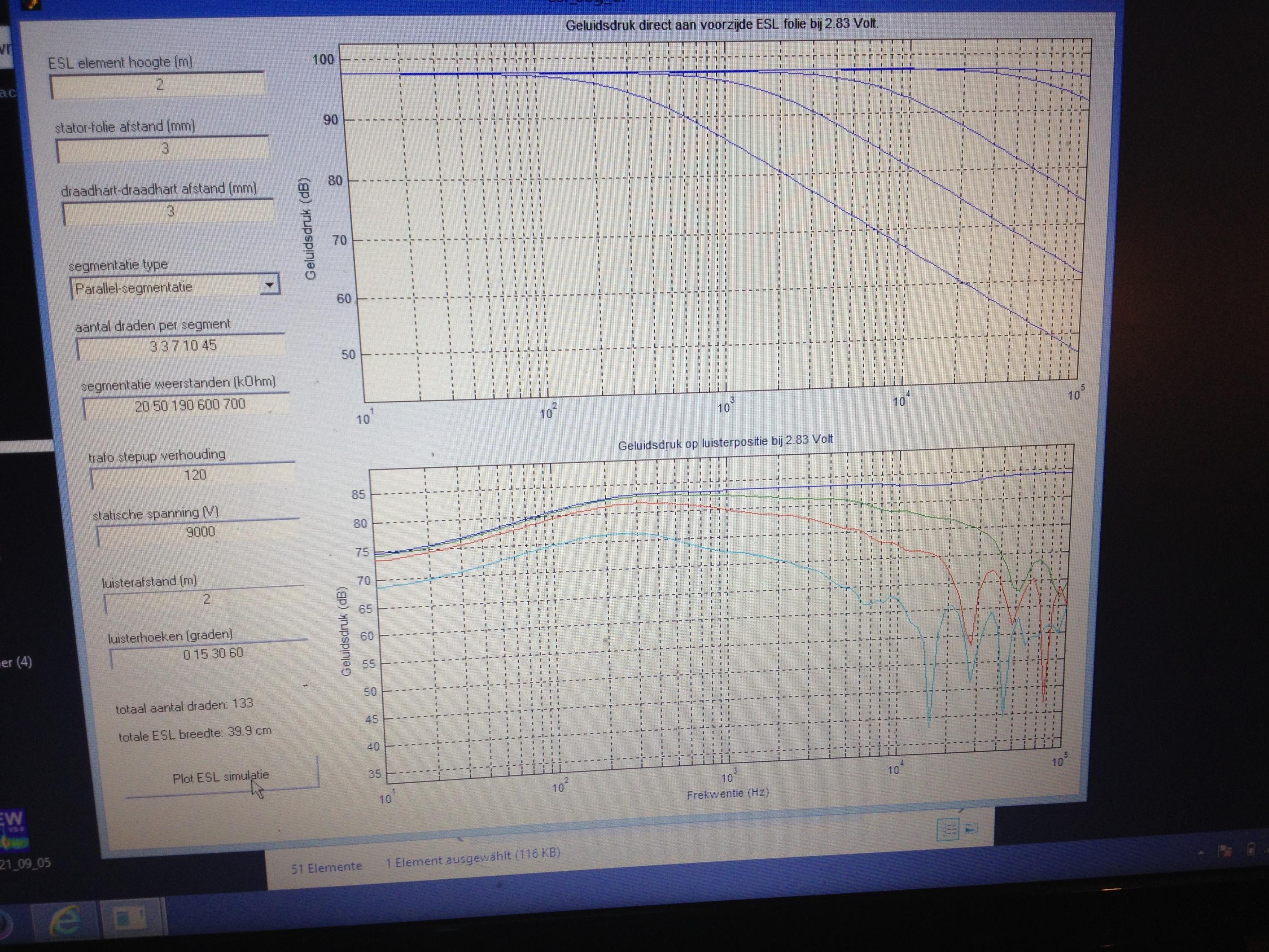

the foil is already ordered and it is sticking at customs i can pick it up tomorrow.
Also i have decided how wide and tall i will build it ( attached Picture)
how you think about that?
i will build it again with wires and there i got some question:
which Kind of wires are recommended?
in my first built i have used H07V-U 1,5mm² and i was not that successful with it i guess it is to stiff to tension it 100% flat and to soft to be like a tube
how about woven wires?
is there a simple trick how to get it super straight?
best regards Paul

the number of wires per width in #12 is way too low to achieve a devcent efficiency.
Increase the number of wires so that You get 30-50% of open area.
The H07-VU is the wire Acoustat used.
You may orientate on their design, apart from the ridicolously high stator-stator distance.
With H07-VU the free distance between assisting supports may bridge 10-15cm.

😡 a lengthy comment about the sim paras went into the off 😡
just in short.
The chosen sim params are not very practical.
2m height: alot mire than required and sensible, esecially for a hybrid panel.
Width and number of segments: too thin, too many. 2-3 electrical segments suffice, for example 3cm + 2x6cm + 2x12cm.
d/s of 3mm: criticically much for reasonable efficiency.
bias voltage: way too high. 3-5kV will be the maximum You could achieve as true bias in the airgap. You can't use the figures of the supply's output voltage here.
The sim sims unrealistic high nearfield Spl values.
On distance the sim results look plausible for the chosen impractical simulation values.
It seems You want to try to test Your skills and patience on a fullrange project. Why?
Problems just rise with every Hz below 150Hz and all important parameters deteriorate. Chances for success are alot better for a hybrid design.
You know that You can't use the simple power toroids for fullrange useage?
jauu

I have done some test🙂
Once i tension the wire till it brocken
And once with a driller
!!!Driller is Perfect!!!
This is how i will do it ( picture )
