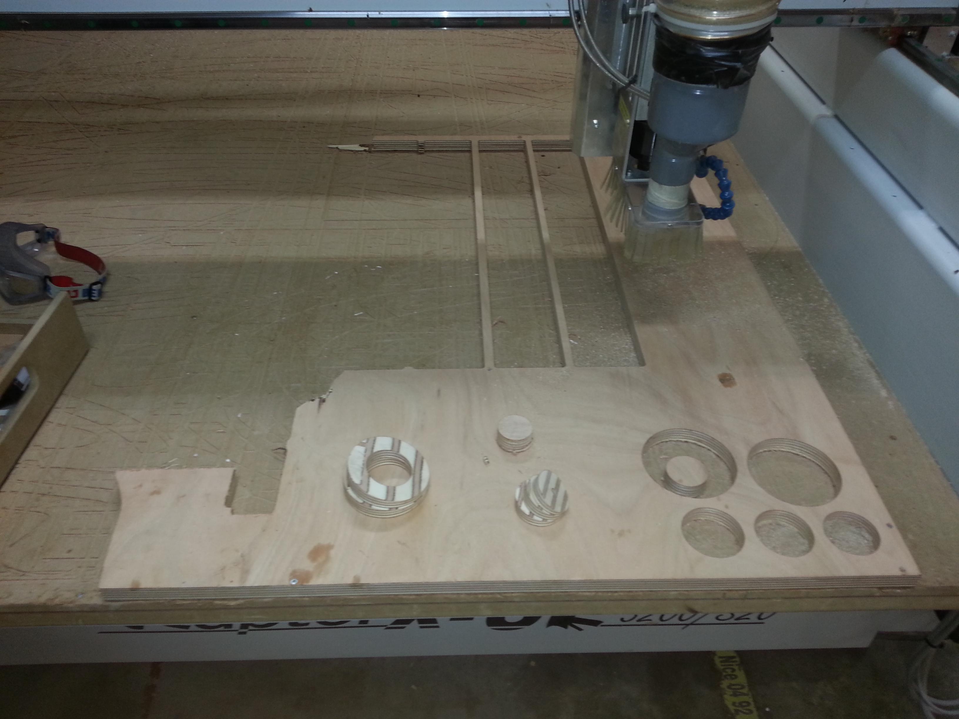

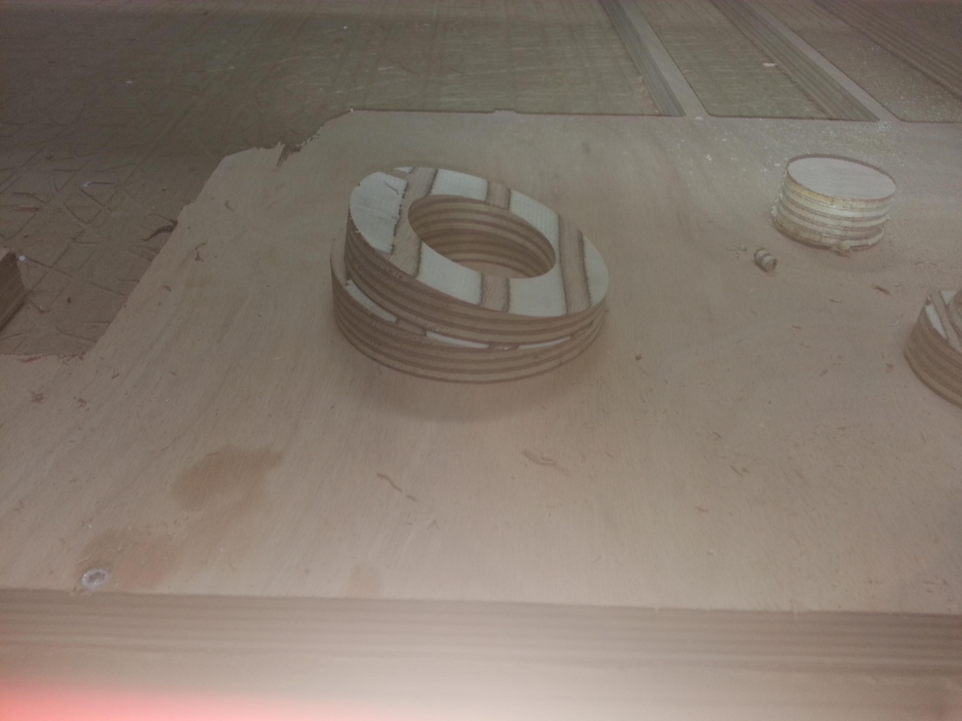

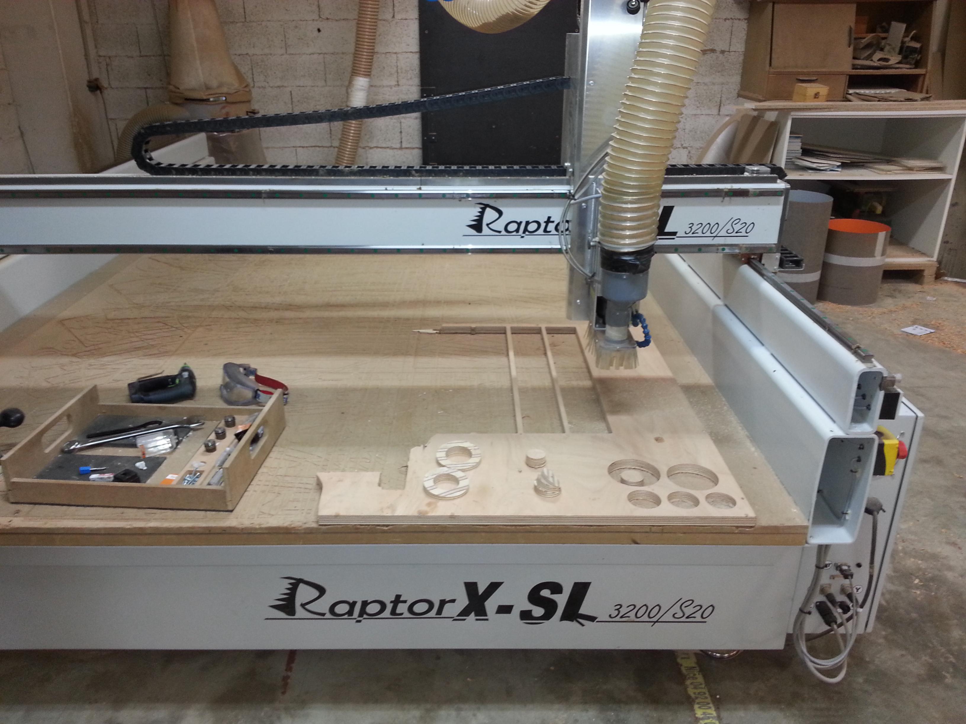

Step forward - my CAD design needed no alterations on the CNC router. Worked like a charm.
Two steps back - Given some sound advice and realised that there is no point make something that looks great but sounds awful. Like everyone, I don't have money to burn.

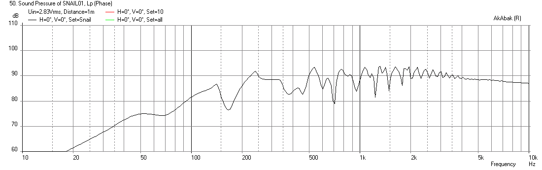

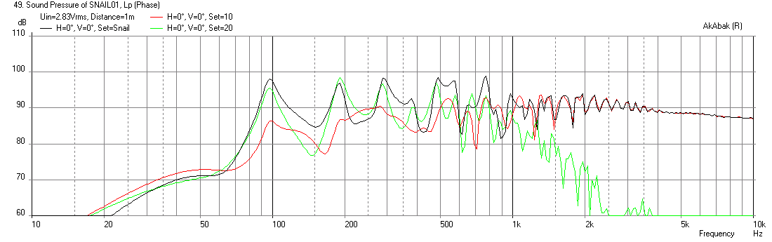

Sim of Snail with FR13
Here is an AkAbak sim of the 173 cm long Snail TL. I assumed a rectangular cross section starting at 6 in (H) x 6 in (W) and tapering to a 1.5 in (H) x 6 in (W). I used moderate stuffing inside the whole line and speaker is positioned 36 in from back wall, 40 in high above floor, and depth of cabinet is assumed to be 16 in deep. The Visaton FR13 is a 6.5 in class high Qts driver (Qts=1.25).
Here is the SPL vs Freq for the sealed tail end:
Here is the SPL vs Freq for the vented tail end (vent exiting to the side), black is overall output, red is driver direct radiation, green is vent output:
As you can see, the sealed version has no bass, and the vented version has bass but it is very peaky and rough, and extension is not very deep. Switching to a low Qts driver doesn't help much. Given these results, I am not sure if I would proceed with building this speaker.
