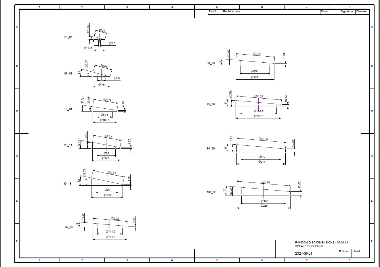

Due to the nature of the design, I had no intensions on shaping every individual section by hand, (theirs 102 on one cabinet), but I wanted to use a CNC Router.
This has been just as slow which was a surprise. I have been approaching many companies in both the UK and France, but everyone wants crazy money for the use of their machines.
I have now made a router jig to be able to get the angles, though this is a backup plan.

Even doing it by hand can add up. I've used up 7 router bits of good quality. 10 saw blades, two routers (my first cheap router failed after only a week) 🙂.
The design has been done, as well as been tested. I've had 10 sections cut already with little issues. That was the easy part.

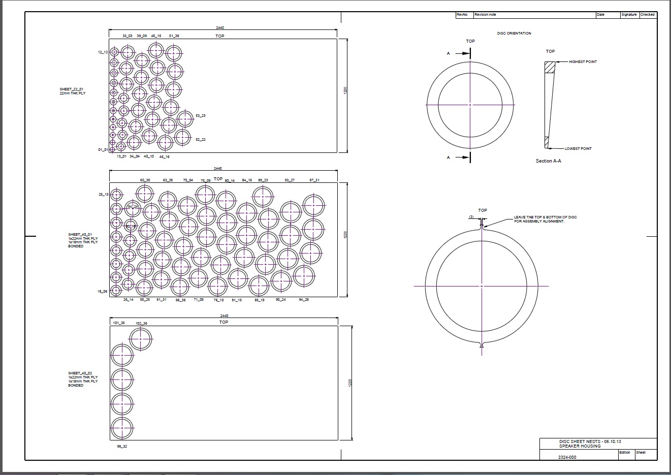

With regards to nesting, I have managed to get the pair nested on 3 sheets of ply, 2x 38mm and 1x 22mm.
The UK price was including materials, but I would rather have this done locally.
