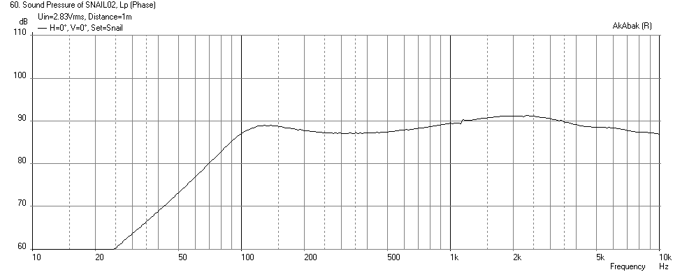

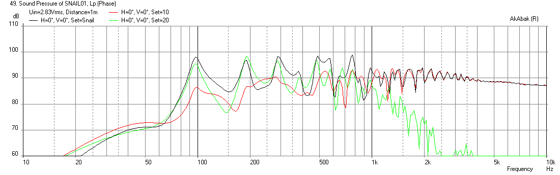

I am still trying to figure out the proper way to implement damping. There is a term that allows me to simulate non-adiabatic compression - which is what I think happens in the fibers as they absorb heat of compression waves so that the energy is not released on expansion.
Here is an AkAbak sim of the 173 cm long Snail TL. I assumed a rectangular cross section starting at 6 in (H) x 6 in (W) and tapering to a 1.5 in (H) x 6 in (W). I used moderate stuffing inside the whole line and speaker is positioned 36 in from back wall, 40 in high above floor, and depth of cabinet is assumed to be 16 in deep. The Visaton FR13 is a 6.5 in class high Qts driver (Qts=1.25).

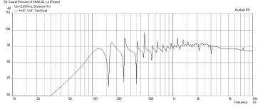

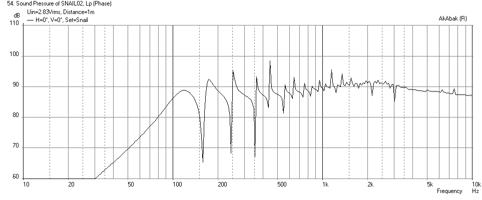

Are you talking about the open ended tail or sealed? If open, the 100 Hz is consistent with the sim results:

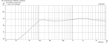

I am tweaking the level of damping and I removed the effects of nearby walls and floor to see what the contribution from the TL alone is. The tail tapers down to essentially zero (cannot have a zero waveguide throat/mouth). If you imagine the peaks smoothed over, it looks like this TL will provide a flat response almost down to 100 Hz. So playing with the level of stuffing is critical. It doesn't work at all without any stuffing - looks very bad.
Sealed Snail:
Equivalent 44 liter (volume you provided me) sealed cabinet with Qb/fo=0.1 (well damped)
So if you will have a sub or helper woofer augment the bass, this can work out.
Closed. I took the length, and calced a 1/2 w/l. This is the frequency that the line will act as a half-wave, it tells nothing about actual response once a driver is added.
