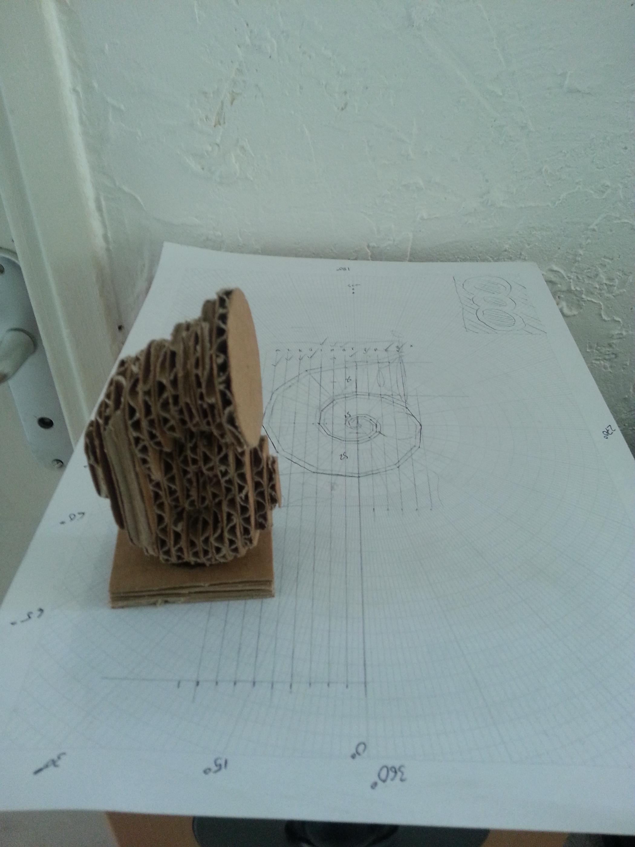

Taking a closer look at your CAD sketches, it's apparent that we've so far overlooked one obvious point - such a spiral is based on each individual layer's piece being tapered, with as I make it from the second drawing, at least 5 separate angles. This is not something that all CNC routers are capable of, and to provide a glue-ready surface on each would take a huge amount of run time on a 5 axis machine, plus quite possibly wear out some tooling. You can ramp a vertical cut bit to reduce tool stress when plunging, but even with many passes the result would not be smooth enough to provide a flat glue joint area.
With that in mind, the cost of additional material to allow for tool bit correction and efficient cutting paths is rather insignificant.
There's an abbreviation in the woodworking trade; " CCM" - curves cost money, and that's more than squared when you go in all 3 dimensions.

The test samples have been done on a 3 axis machine, though it did take a little while. But the results where great. I'll take some pics tomorrow.
In total, there are 20 different angle. This was to help get a 3m transmission line with a 5" opening.

20 angles? I only measured 5, but you have all the drawings.
No matter what, I could certainly imagine the cost would be significant, if the estimate you gave doesn't get revised once the CNC shop pushes the go button, it's actually quite reasonable - but who am I to say what the result would be "worth"?

I thought about doing this when I initially started the design. (See Pic) Though the wastage would have been immense.
Also I want to have both a smooth interior and exterior...
Or the other option is to glue up lots of mdf as a solid block, and get the CNC to machine out the internal snail shape to form a mould, from which you could take a fibreglass cast.
Would only be one CNC operation, with a lot to remove...
I also looked at doing this, but as the project states, this is meant to be an affordable logarithmic spiral speaker. And milling out a solid block of mdf would cost loads. Also, living in the south of france, mdf cost £100 per sheet. (22mm)

If you add labor costs to do it by hand it will never be affordable. The CNC prices will start to look mighty cheap if you start counting hours to do it otherwise.
Be sure to figure out a good way to glue-ing everything together. That is also a very time consuming task with lots of ways to go wrong.
But the most important part (for me) would be finding the right driver to work with the enclosure. Did you figure that out yet? The enclosure has to work with the driver, not against it.
I'd pick a driver first, then work out enclosure dimensions such as total length etc. Would be fun to find something similar to the Manger for such an enclosure.. You have to make certain it's going to work with a job as big as this.

The most affordable way to do this is to prototype it in foam core (or even rolled-up EPS home insulation sheating) first (cost $5 dollars of materials and 3 hours of work) to hear how it sounds before investing any serious time or money on cutting wood. The foam core will give you a very good representation of the sound.
Btw, did I miss it but there has yet to be any mention of a particular driver or T/S parameters? I can easily model the response for this in AkAbak before any physical cutting needs to be made. Need T/S params for driver and approximate dimensions though to do so.
