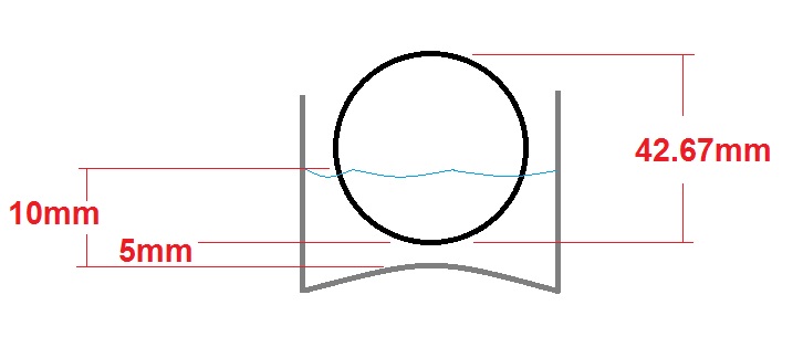

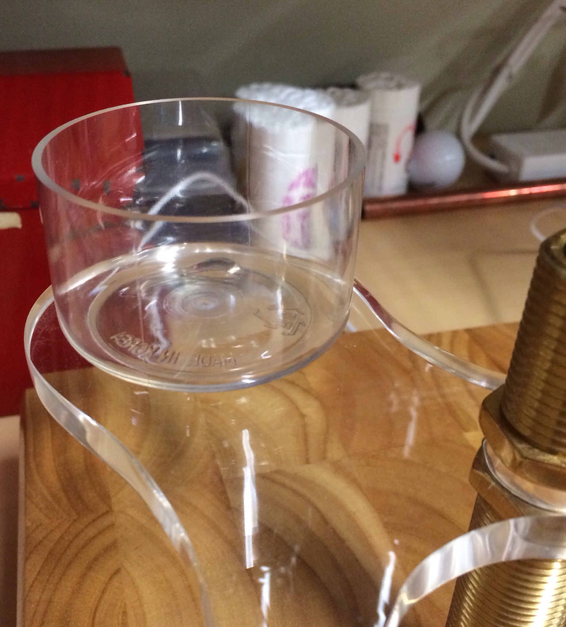

If that's the case then i need a new cup. the pic shows I would only get about 10mm suck into the fluid.
1. Get a new cup
2. Cut down existing cup
3. And by another $12 bottle of silicon

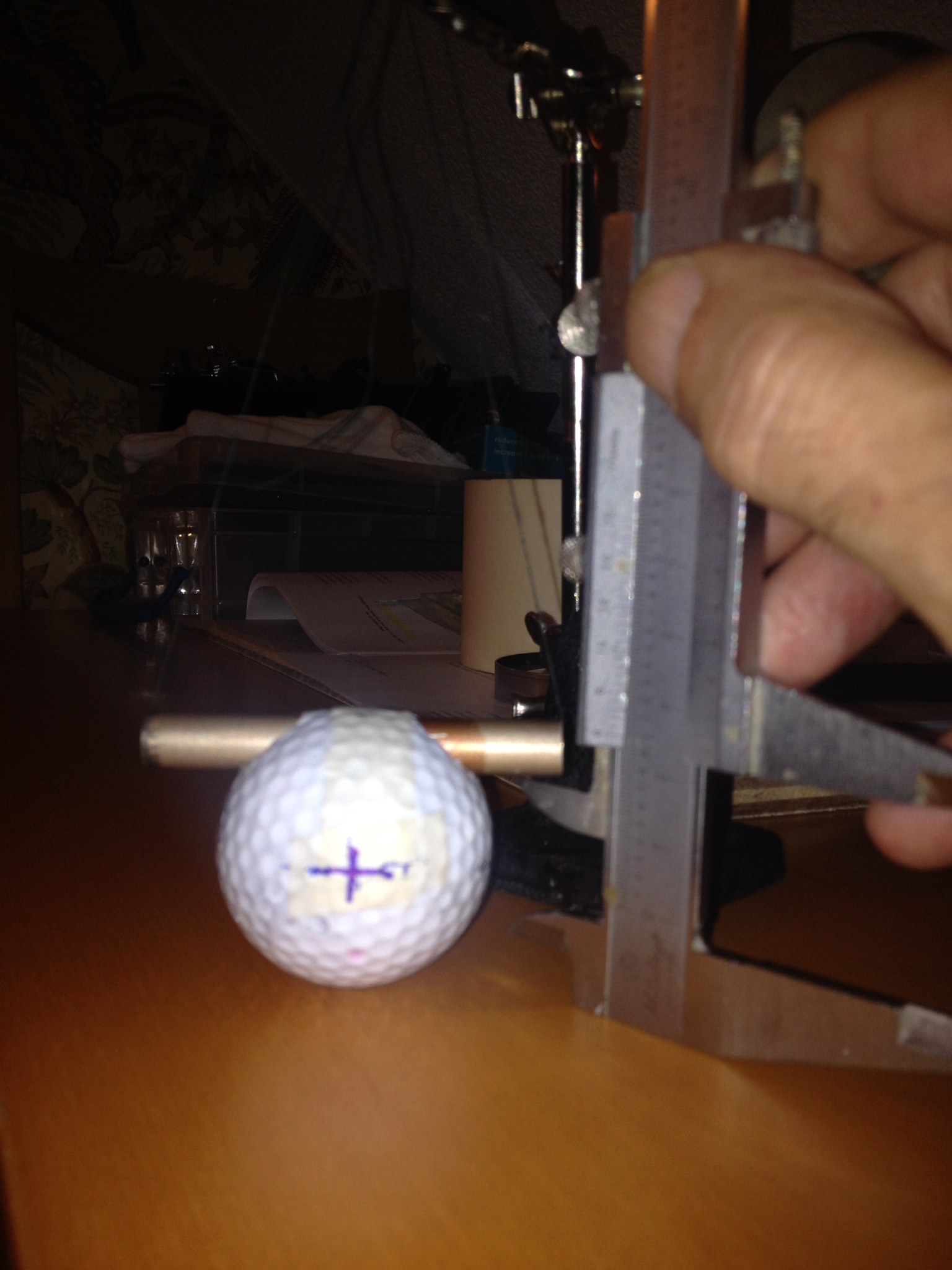

Ball marking
To mark the ball….
Once I had drilled the ball one drill slightly smaller than tube i.e. it just fit inside tube, then one the same size as the tube.
with a short piece of tube inserted into ball, I hung it on a thread.
This allowed me to centralise & level the Ball, in order to mark it about its centre where it will be hung from.
before I drill these two quite small holes, i need to find out if they are indeed opposite one another i.e. 9--3 Equidistant or if they are slightly forward of middle 8--4 which i think they might be.

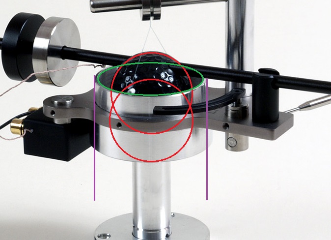

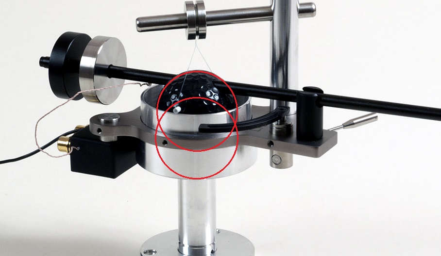

My next question is regarding effective length. Do we need to find the centre on top to use as the pivot point?
This would make for very easy set up later on. If you going to tinker around with the ball position inside the cup then how are you going to ensure you have correct effective length?
Unless you marked a point on top of your shaft from which you are hanging the ball?

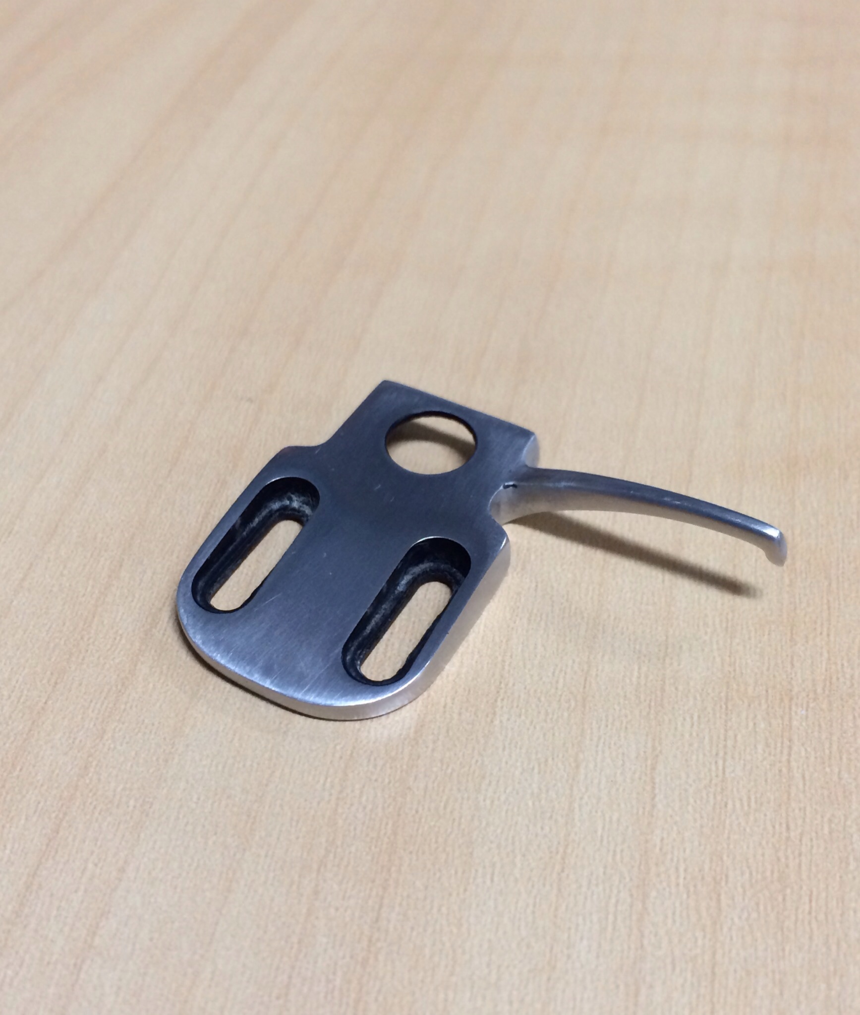

Looking good, Its getting more see through by the day !
That shell should work fine, will you be epoxying it to the tube? & the angle, what have you decided on ?
Also just get the orientation right for the cable hole. as all other adjustments are done from the threads
