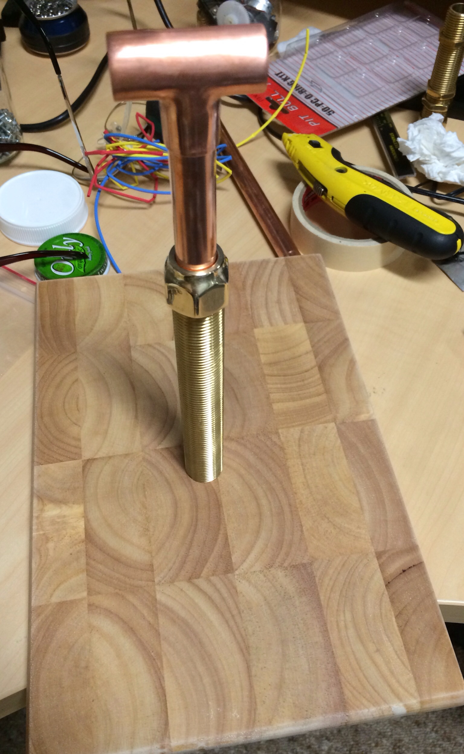

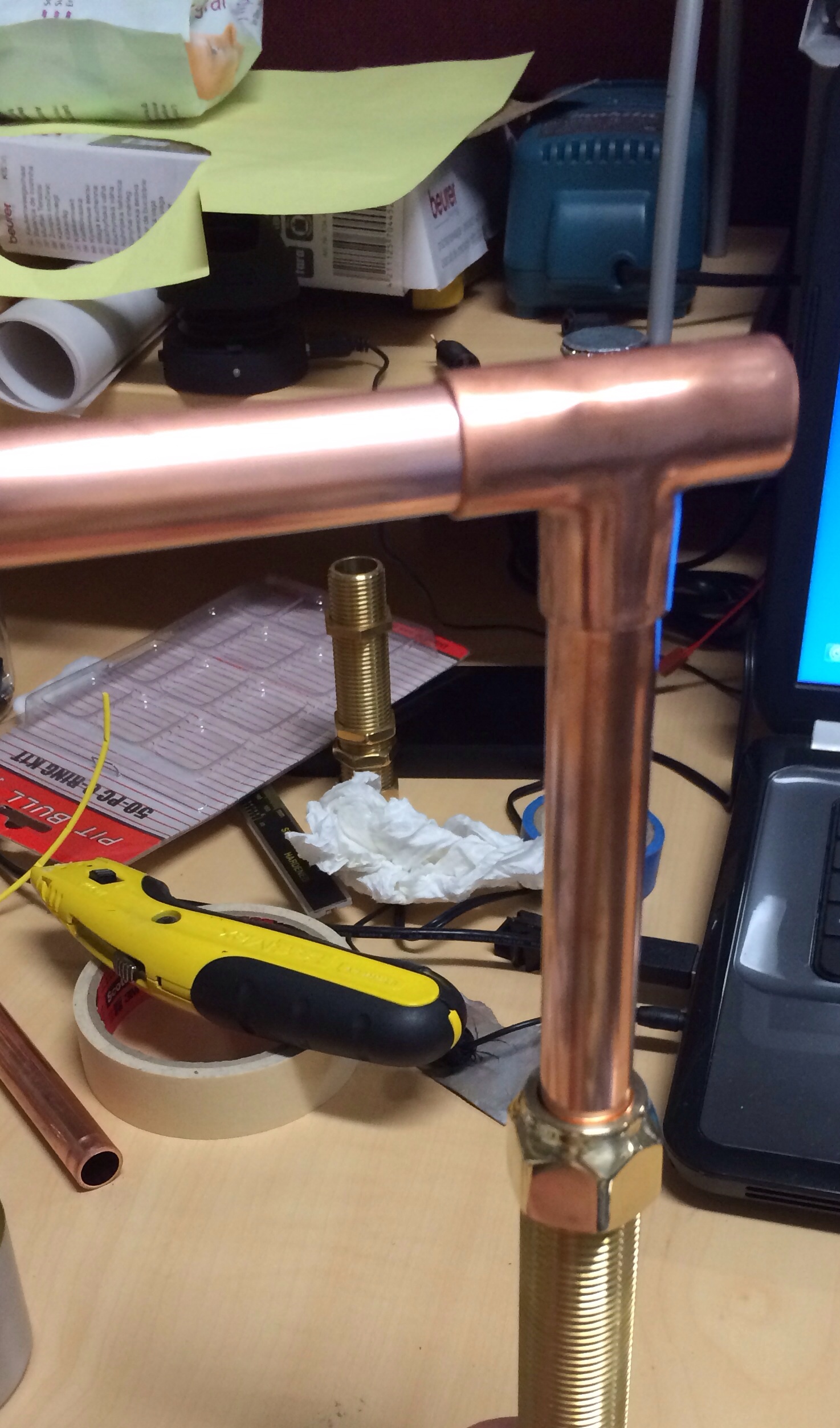

I will be using the brass fittings so I can adjust the overall height of the complete plate with bowl and all. The copper tube is held in place with a nut and 'o' ring which will then allow me to adjust the height of the cross beam/and golf ball.
I'm using this as that's all I have. I'm going to house the whole thing on a separate board, which will not be attached to the plinth.
Specs
I too am struggling with the detail of the ball. I may be wrong here but having the string running through a small tube that runs right through the ball IMO would allow for better movement? As opposed to screws?
Tone arm: I will not dampen down the tone arm at this stage, will wait and see how it goes.
String: I'm just using fishing line. Something that is rated at a couple of kilos surely wouldn't stretch under this load?
Plans: hmmmmmmmm what's that? I just dream it up as I go along, I will draw out a plan for the main plate that holds the bowl(which will be made from acrylic) but that's about it I'm afraid.

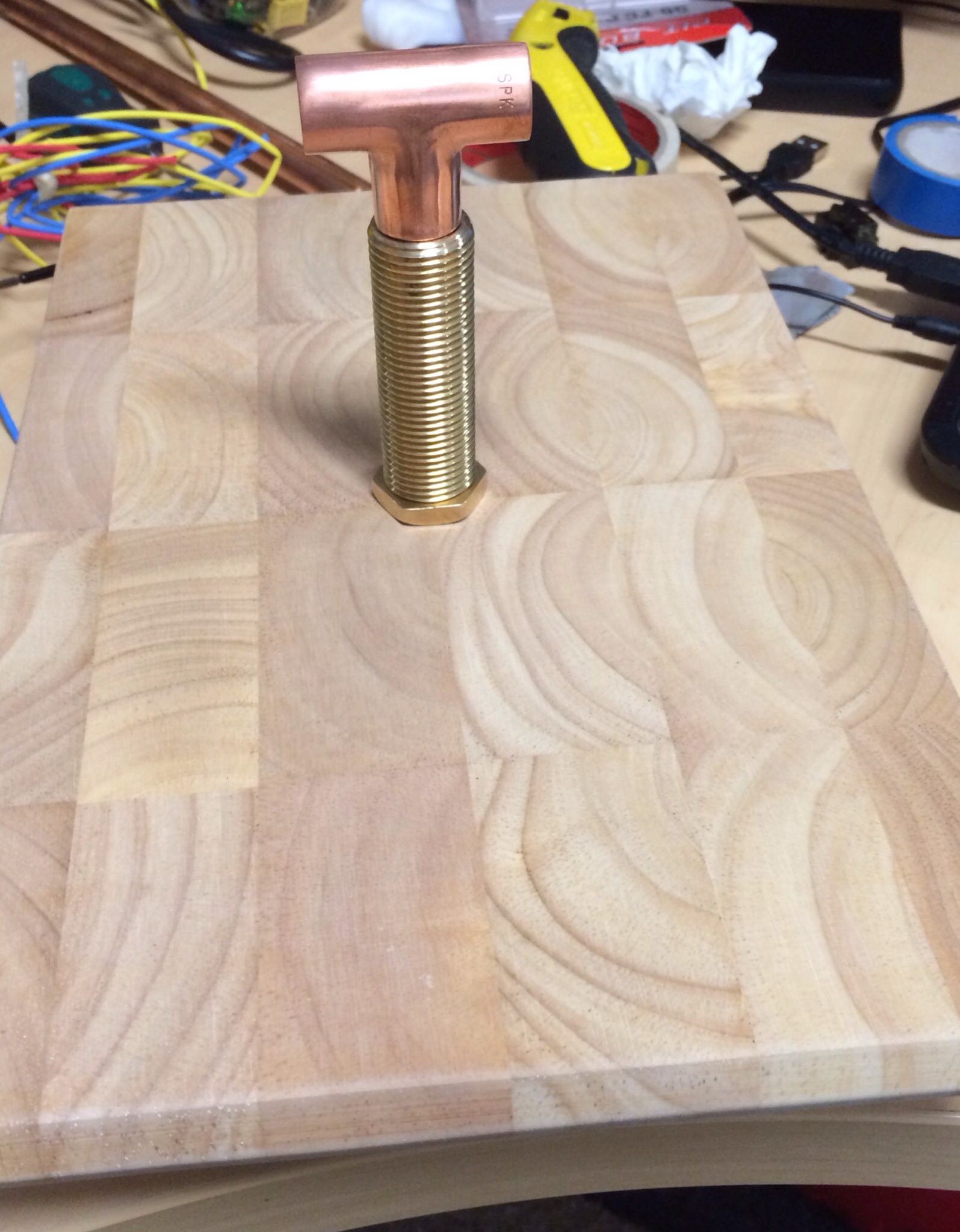

And this is it assembled.
Will never be that high of course, but just to give you an idea of what it could look like.
I will cut a short piece of that thread and use it to run the string around. It will be held in place by two o rings, one either side to stop it moving, but will still be adjustable.
I see now how your doing the pillar.
Mine will be a bit chunkyer.
Good to see a pic though.

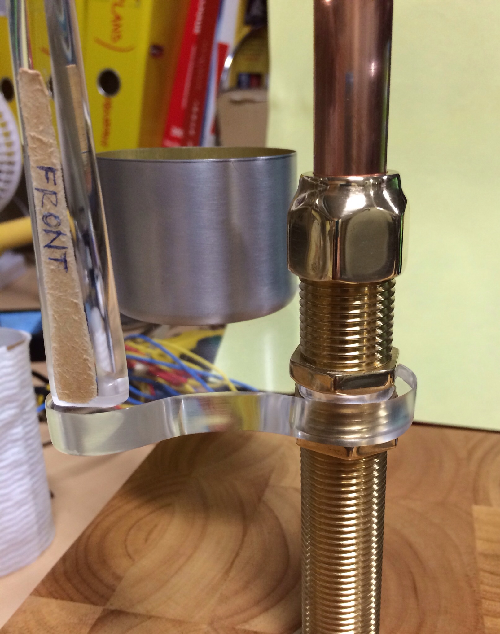

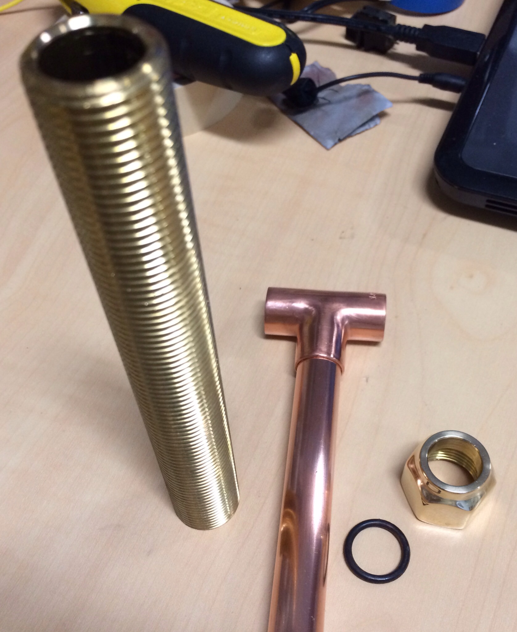

Will the nut tighten an olive onto the pipe without digging into the copper to allow adjustment? I guess a nylon olive?It should look neat .
Never seen a nylon olive.
My intention is to Not tighten the nut more than about finger thought for that very reason.
Their may be another solution perhaps large O rings or lots of PTFE tape.

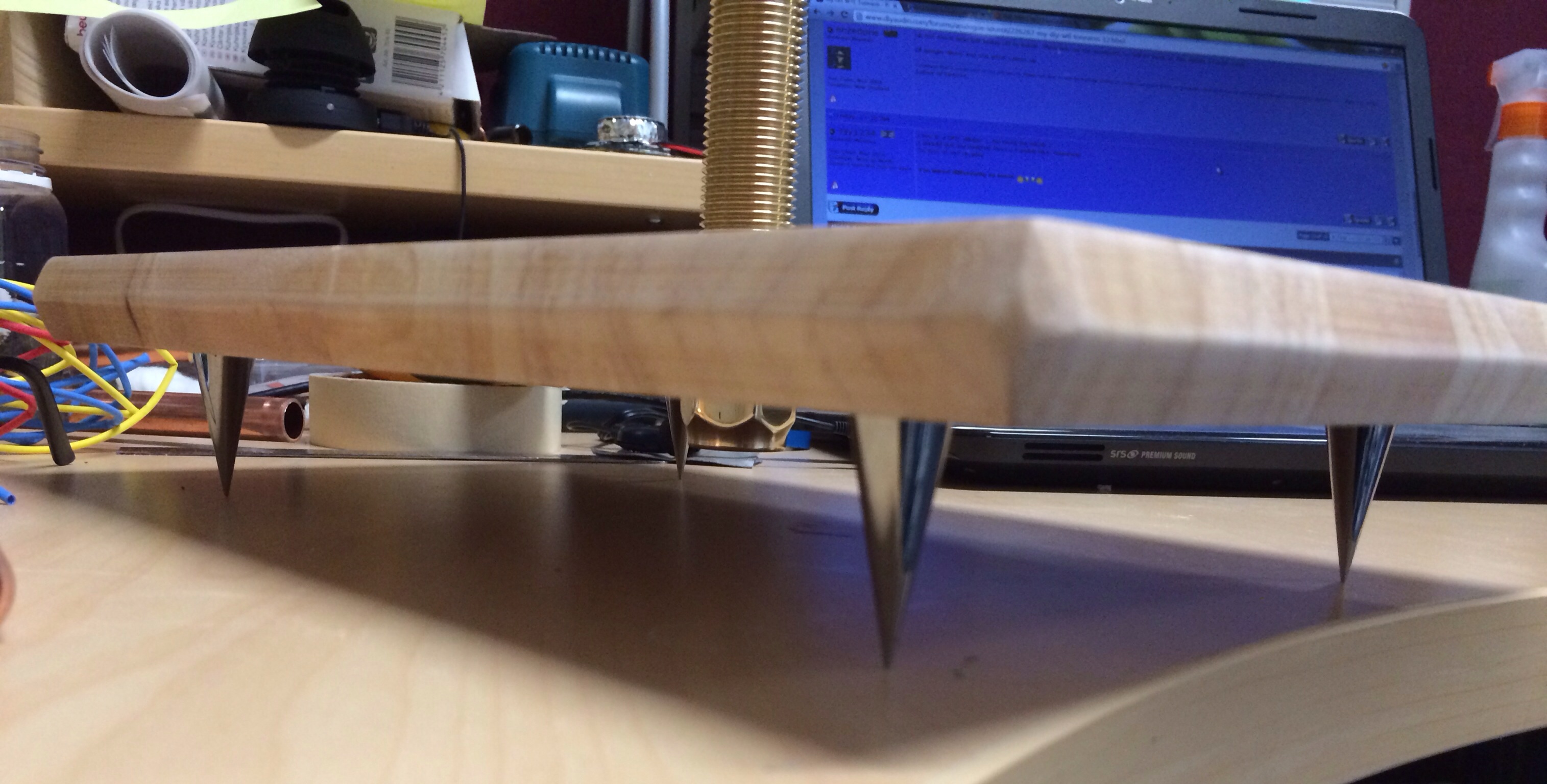

Here is my board. This comes from a highly regarded and very we'll respected audio company that's been around for years. They are based in Veitnam and have been making these very expensive 'Audio Grade' bread boards for years 😉
$8
