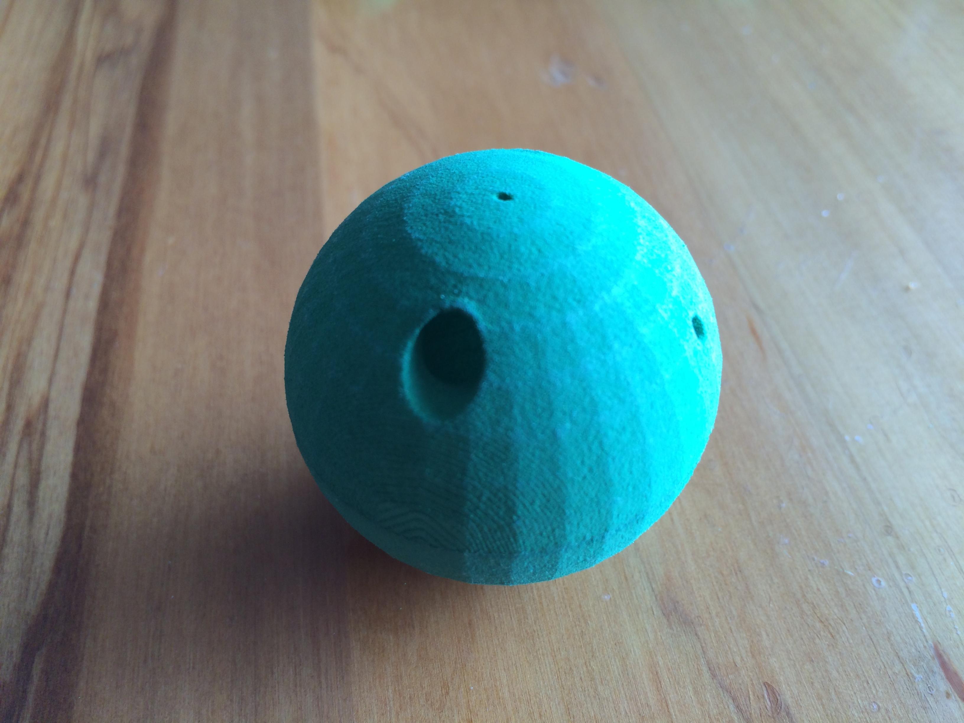

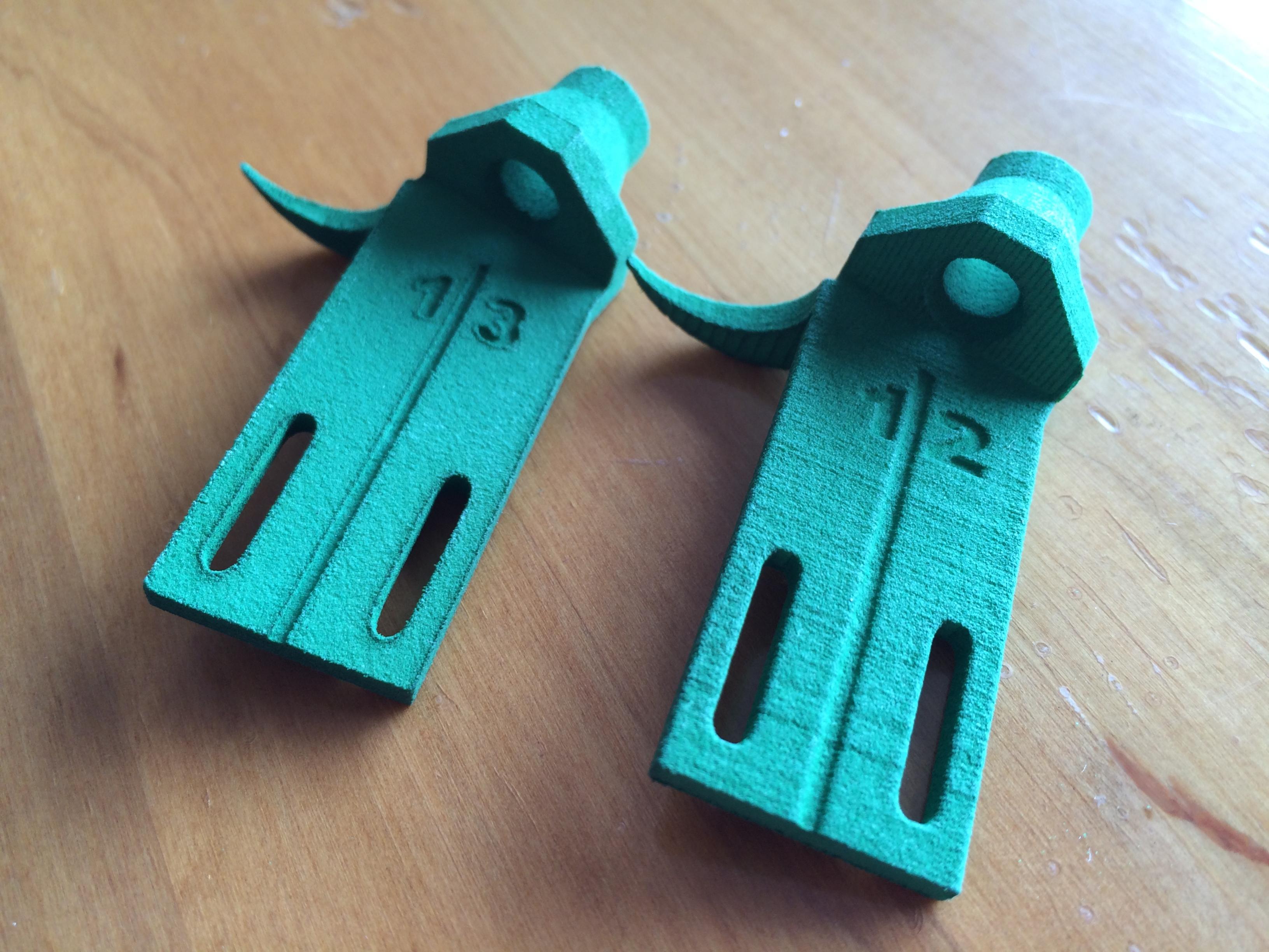

3D Printed parts
Here a couple of pics of the parts that arrived this morning.
Head shells and golf ball.
This is not polished as stated by shapeways.
I will have to give it a buff, the finishing is not to good. Golf ball I'm not worried about, but the rest I would have liked a little better finishing. But yeah! Don't believe the hype around this Technology, it's not that! Amazing.
But, I will see how the product looks after some wet and dry.
The holes are good though as the shaft is around 5.96mm and the holes in the Head shell were made to be 6mm. It's a tight fit, but will go in OK.

Wow thats very cool. I think a different type of printer could do a cleaner job, it's a great start tho!
This is through shapeways in US. Sometimes due to design you can't get a polished finish, but I will go over with wet n dry.

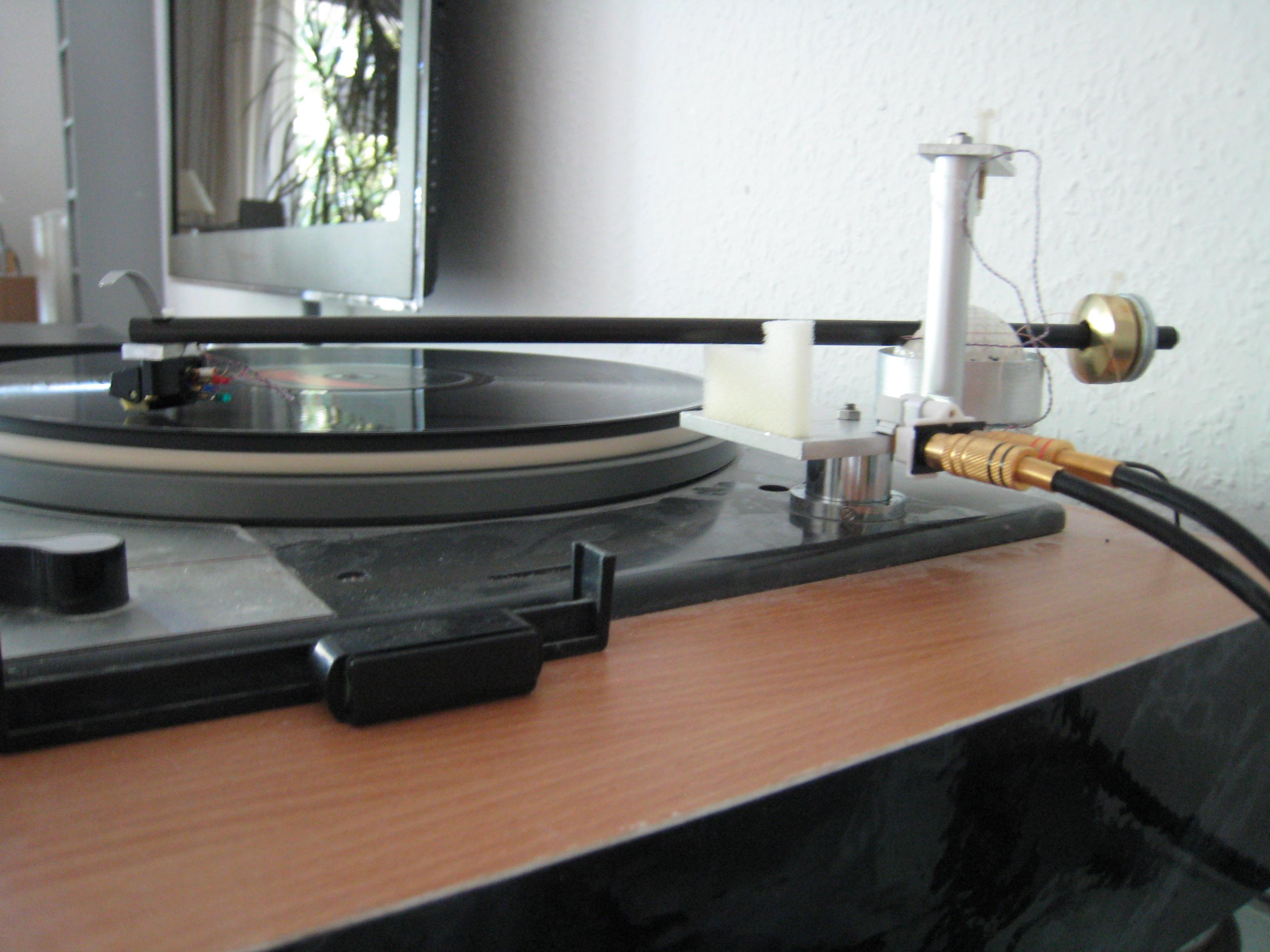

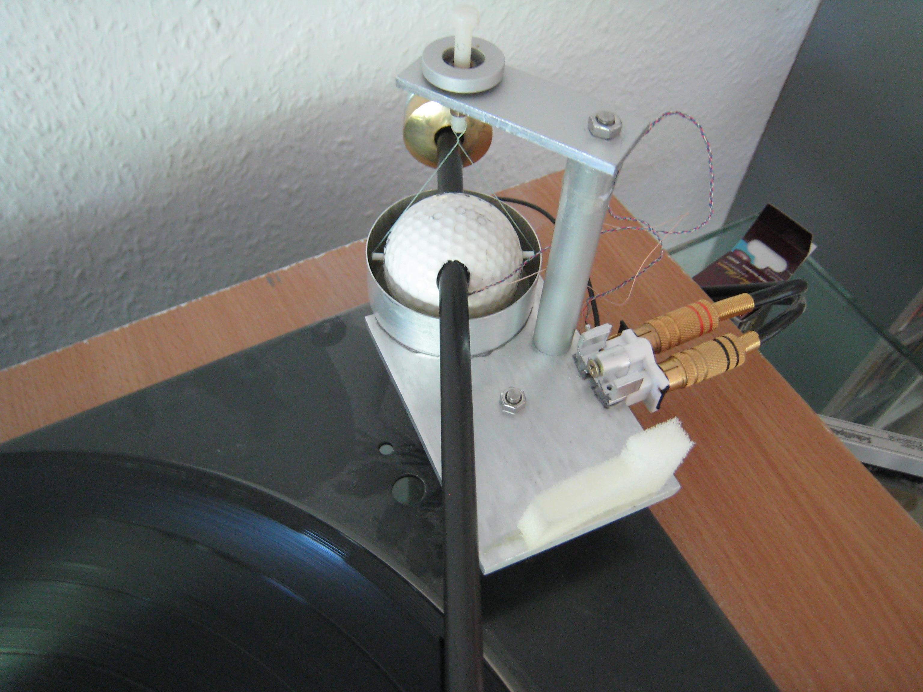

DYI WTL - how does it sound?
I do not know if this thread is much read anymore, but as I just have completed a WTL Tonearm clone and am going through the first tests, I would be glad to have some opinions from other DYIers. I have a Shure M95 ED cartridge (high compliance) mounted on it and have adjusted the tonearm correctly (overhang, VTF, TVA), at least everything looks OK. Silicon oil is 100.000cts. My first listening test since one week show a sound with no major treats except that it's like smoothed in the high frequencies. The surface sound is very low but it seems that the micro-details are missing also, therefore it's kind of lifeless. Any opinions or hints to what I should look at in order to bring some more life to it?

Did you set the vta properly? What cartridge are you using?
Possibly dampen the arm with balsa wood down the inside of the arrow shaft? It cant hurt and is cheap enough to do.....
You can also think about putting something like blue tack on the head shell. It will add more mass to the cartridge end of the arm.

I have set the SRA (stylus raking angle) to about 92°, as recommended. The tonearm is tailing a little up, but if anything this should not lower the high frequency response.
The cartridge is a Shure M95 ED. As it is a high compliance cartridge, I would not increase the mass of the toneram.
The arm is made of an 8mm carbon fiber shaft, filled with fine grain sand as recommended for damping. My thoughts concerning the "ironed" high frequency response would go more towards TOO MUCH damping. Either through the silicon oil or through the soft coupling of the shaft to the golf ball (made of some rubber) or due to the sand in the shaft - these are all assumptions.
Someone also has had similar problems with lack of micro-details? Any comparisons made with other arms? (I did compare it to another arm, a DYI Schroeder clone, and it was rather obvious).
Or maybe the internal wiring? I'm using some very fine wires wound together - too much capacitance? Any thoughts?

Had you tried the cartridge on a different arm before the WTL?
Do you know the sound has changed because of the move to the WTL?
As I'm using Decca carts that require a mass loaded arm, the arms I used before Ie SME, Audio mods, & a Uni Pivot. None could really cope properly. So the WTA works best & brings out everything Very fine details in the Mid, Treble & Great Base.

To russc: Yes, I've tried the cartridge on another tonearm. As a matter of fact, I tried a second cartridge (AT 440 MLa) on it, it sounds also as it's missing the life I hear when mounted on my other tonearm. So it's tied with the WTL. But, as I see that every DYIer having used their WTL is very pleased with its sound - or more, enthousiastic -, it must be something in my WTL that doesn't fit. I'll try first to change the inner cable (easiest move) to see the change.
I am indeed using a Lenco L75, which is a fantastic turntable. I would love to come to the LH meeting, but that's too far. I'm in Germany.
Any hints regarding the damping with silicon oil? Can it be that too much damping could lead to a decrease in high frequencies, on micro-details? My bass and mid-treble is good.
