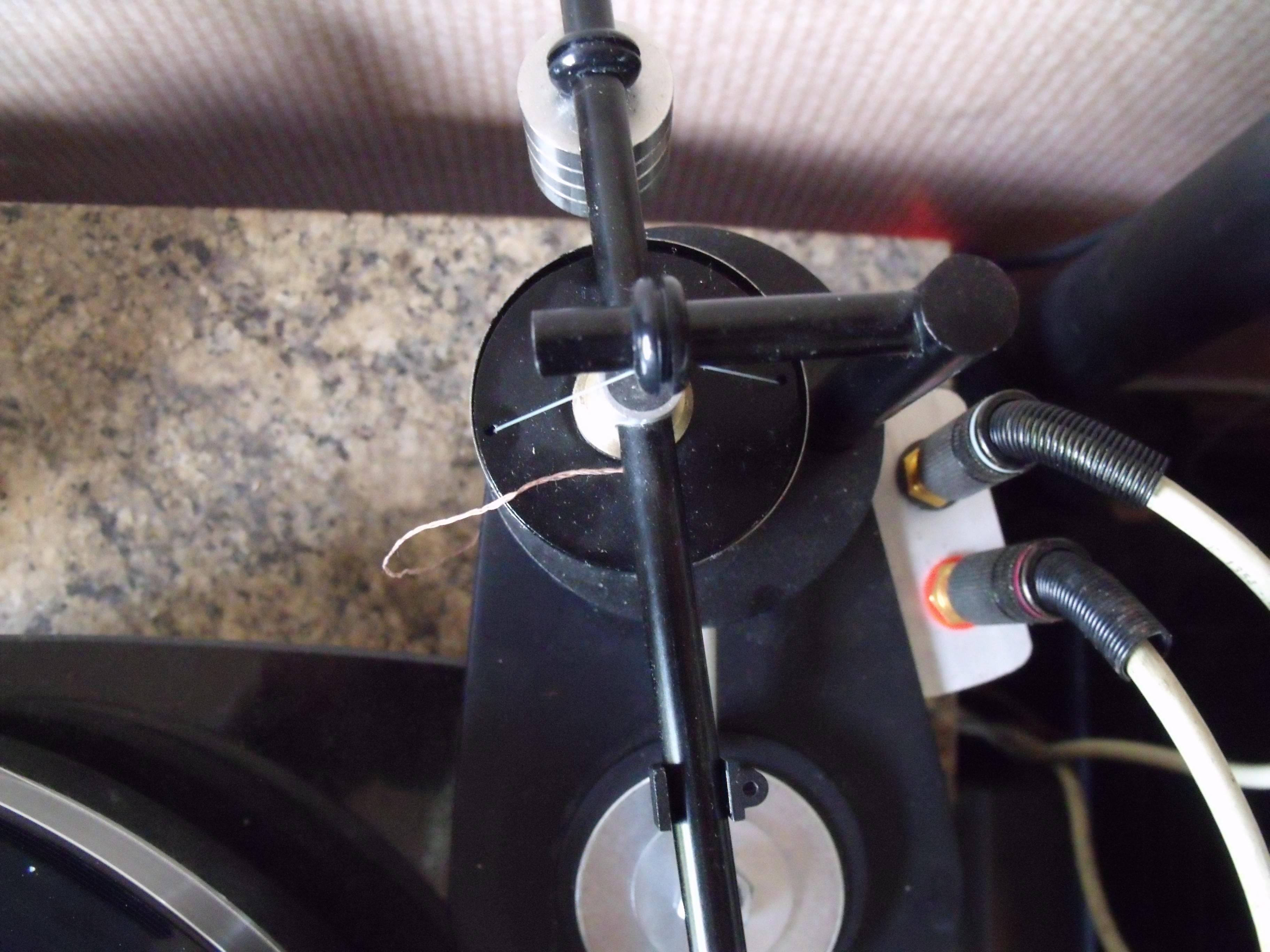

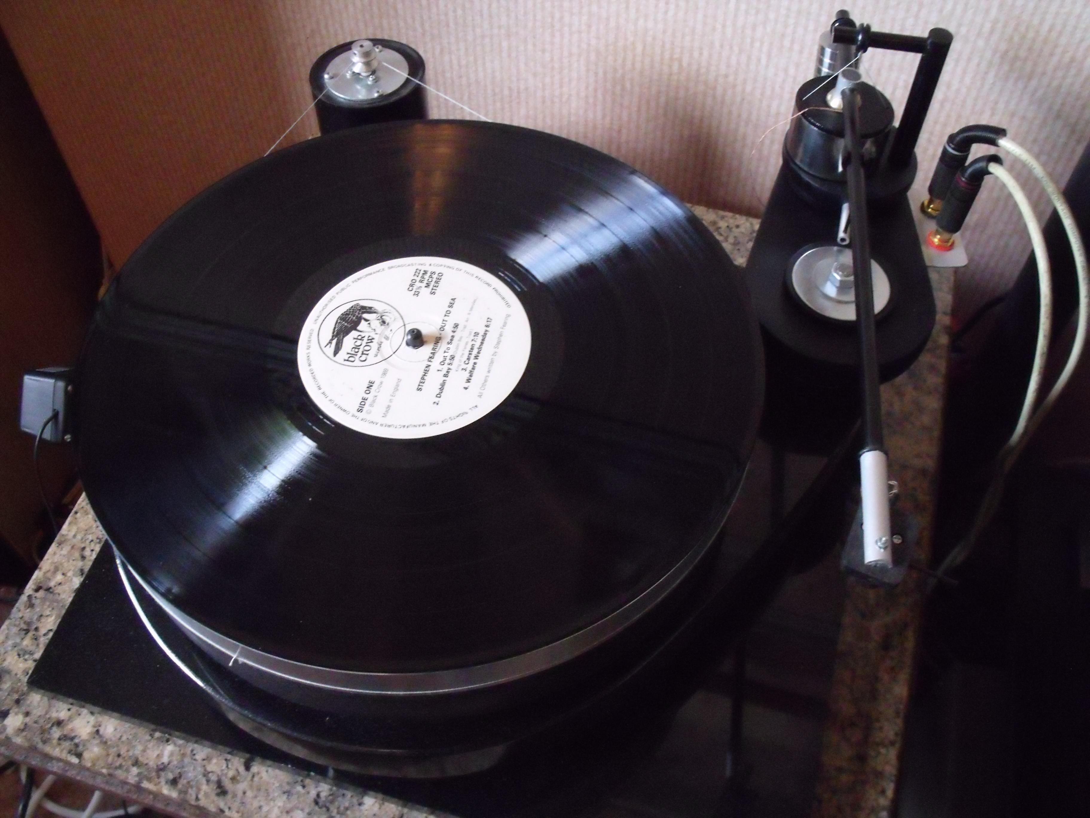

Tried first run of new turntable (based on Bushman) with WTL arm. Motor is a (ex-printer) stepper with Arduino & DSPIN microstepping driver. Temporary drive is Meccano pulley & fishing line. First vinyl I've played without rumble (previous turntable was Project1 - enough to put anyone off vinyl). Something to look forward to after my holidays.

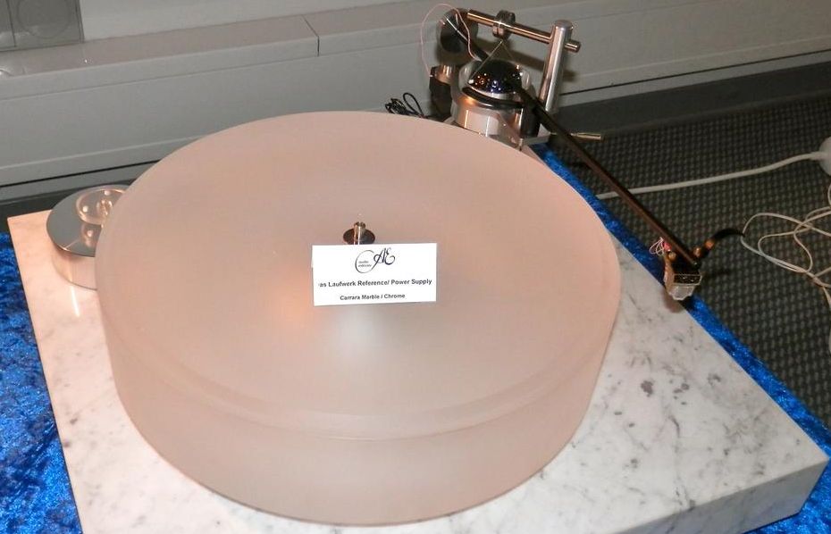

Does this 2013 Munich audio show picture look familiar? I get the feeling there were some patent fights over this design 🙂

Turntable plinth is based on Bushman as much for appearance as anything.
