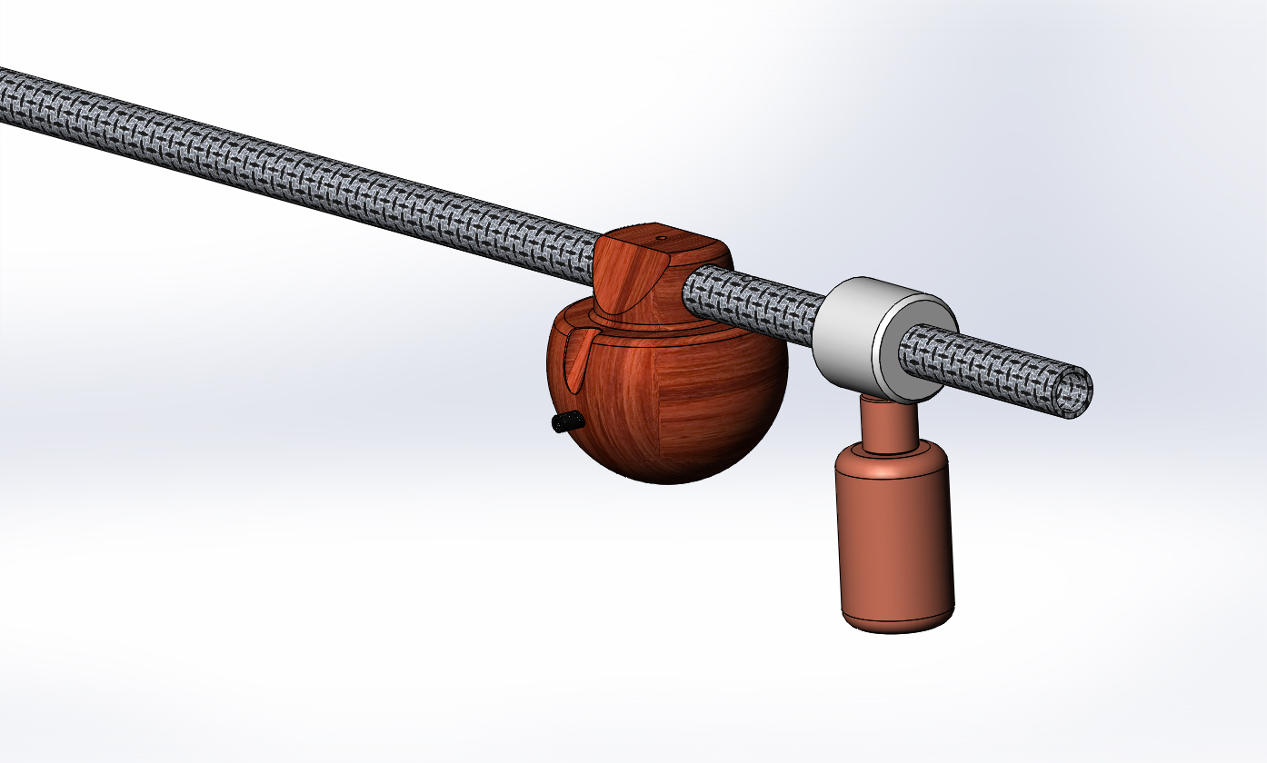

Thanks bcc1955, I have reviewed WTL manuals and see the doughnut counterbalance weight on the tone arm tube. Easy enough to turn another though I will need to source some large diameter material first.
Regarding stability, bgruhn suggested adding a magnet. I find that rotation (Tracking record) and raise/lower of tonearm, the fluid is in shear and (hopefully) not too difficult to move; while the fluid must flow from one side of the pot to the other in order to move off centre and this is much more difficult. So location should not be an issue with ~ 1/3rd ball depth.
Sorry for the late reply as the diyaudio.com site was down yesterday. I have considered a magnet as well but am not convinced it is desirable. It would fight against vertical pivoting of the tonearm which is already slowed by the dampening fluid. I have yet to read a single review that detects any audible effect from the small movement you would expect from variable drag at the stylus. I plan on doing a lot of listening before thinking about adding that feature. As they they say KIS!

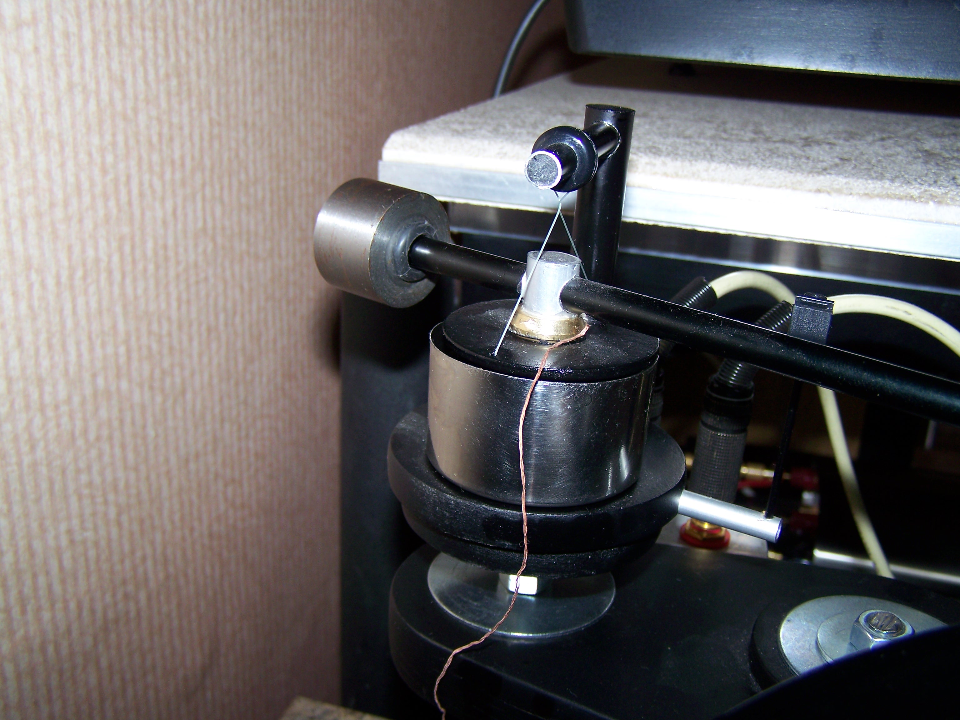

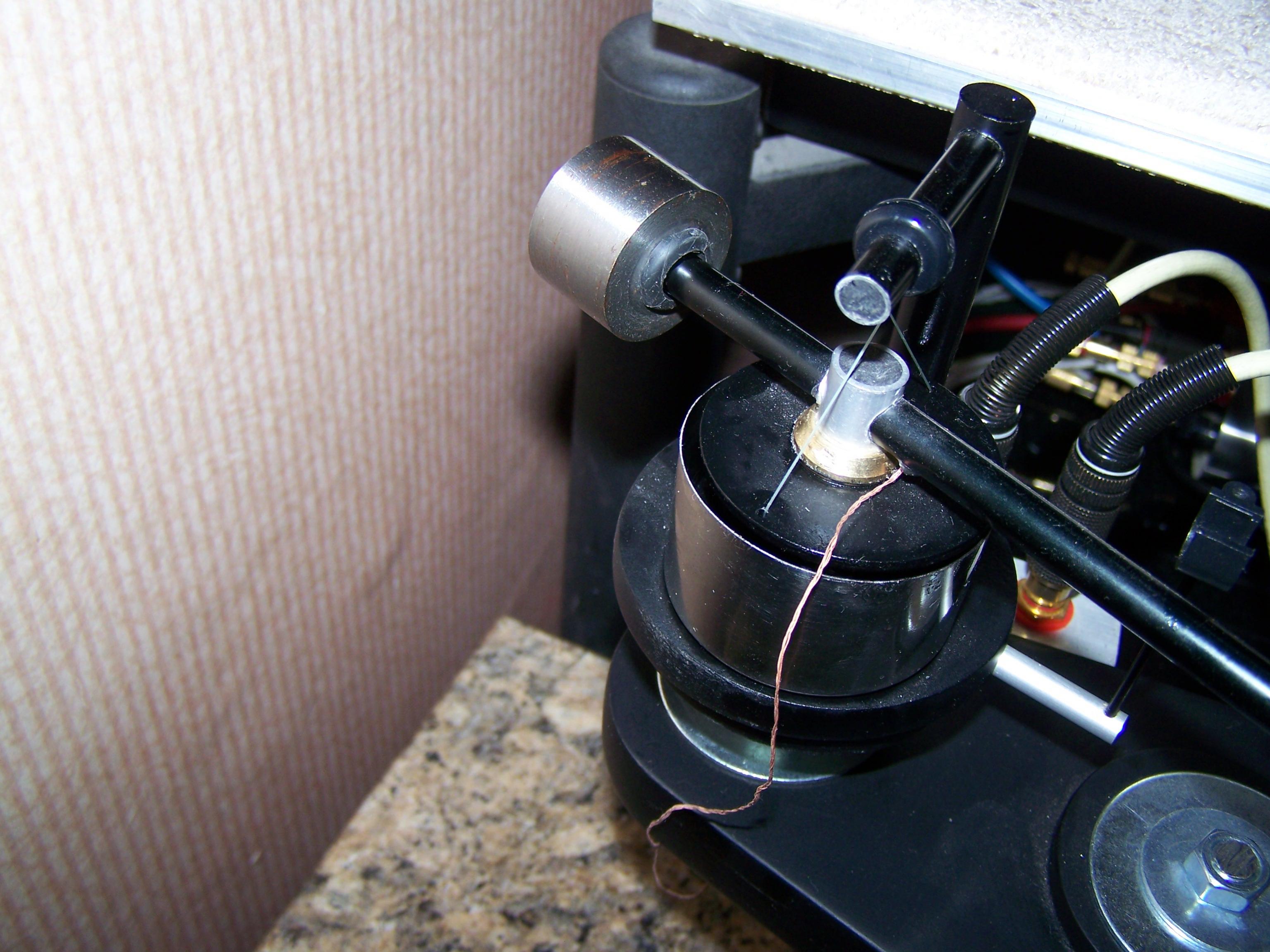

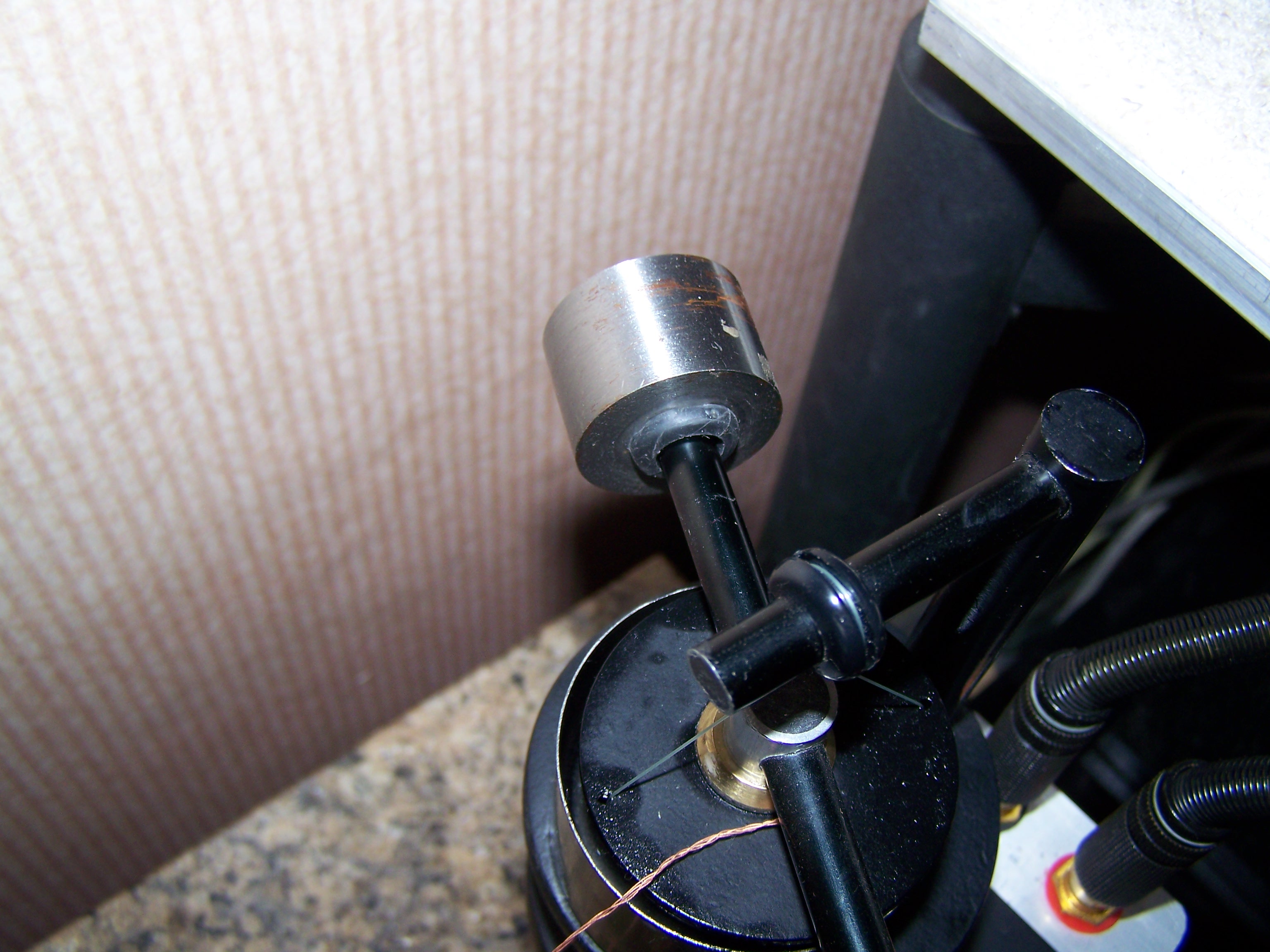

Hi Everyone
The issue regarding the counterweight and centre of gravity hadn't occurred to me as the arm performed so well with the 'dropped' counterweight. I'd merely used this design as I had used this type of counterweight on my unipivots as they were easy to source (drawer handles), were easy to adjust and looked good.
After reading the recent inputs, I've made another counterweight which keeps cog above pivot. Initial impressions don't immediately seem different to the other arrangement. Watch this space. Pictures included.

In theory it should be better on your least flat records. It should also allow equal tracking at slightly lower VTF. So you have some playing around to do to detect a sonic difference. I am just going with theory. For fun put the end of the tonearm on a scale when flat, when tilted down, and when tilted up. Do it with both your counterweight configurations. You should be able to measure what I noted.

Nice counterweight. Did you turn it on a lathe yourself? I am just getting a lathe together and will hopefully post some pics in due time. When I went about making my own tonearms I found unipivot configurations with their CG well below the hinge point perversely caused the opposite of the tracking dynamics that I sought. As always the CG is forward of the hinge point to give the cartridge a couple grams of down force. If the hinge point is above the CG downward movement of the cartridge reduces the lever arm of gravity's force. If the hinge point is instead below the CG downward movement of the cartridge increases the lever arm of gravity's force. Best to sketch it out yourself to get a firm grasp on it all. So without listening to the effect I have concluded that getting heavier for dips and lighter for hills is a better dynamic for cartridge VTF. This is impossible to achieve with a unipivot as it becomes unstable. However, the WT tonearm with its V-string pivot stabilizes the tonearm and allows this configuration as does your typical physically hinged tonearms. Hopefully, someone will chime in here and offer a defense for unipivot tonearms. Other than having cheaper manufacturing expenses I see zero benefit to the design. Particularly with the even cheaper to manufacture WT style tonearms that overcome its deficiency and others.

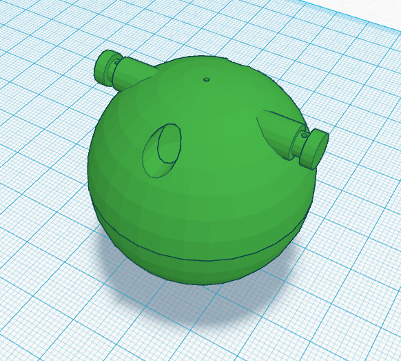

Maybe something like this?
Would come in at about 4grm lighter than the original golf ball.
Small hole at top to align pivot point marked on shaft (if you wish to do so)
External tie points so you don't have to thread through ball and everything is squared off perpendicular. Total volume about 24.4cm, so I think compacted sand would come in at about 4-5 grams light than standard.
This would take an Easton Arrows Jazz 1516 or is it 1615? anyway its 6mm diameter.

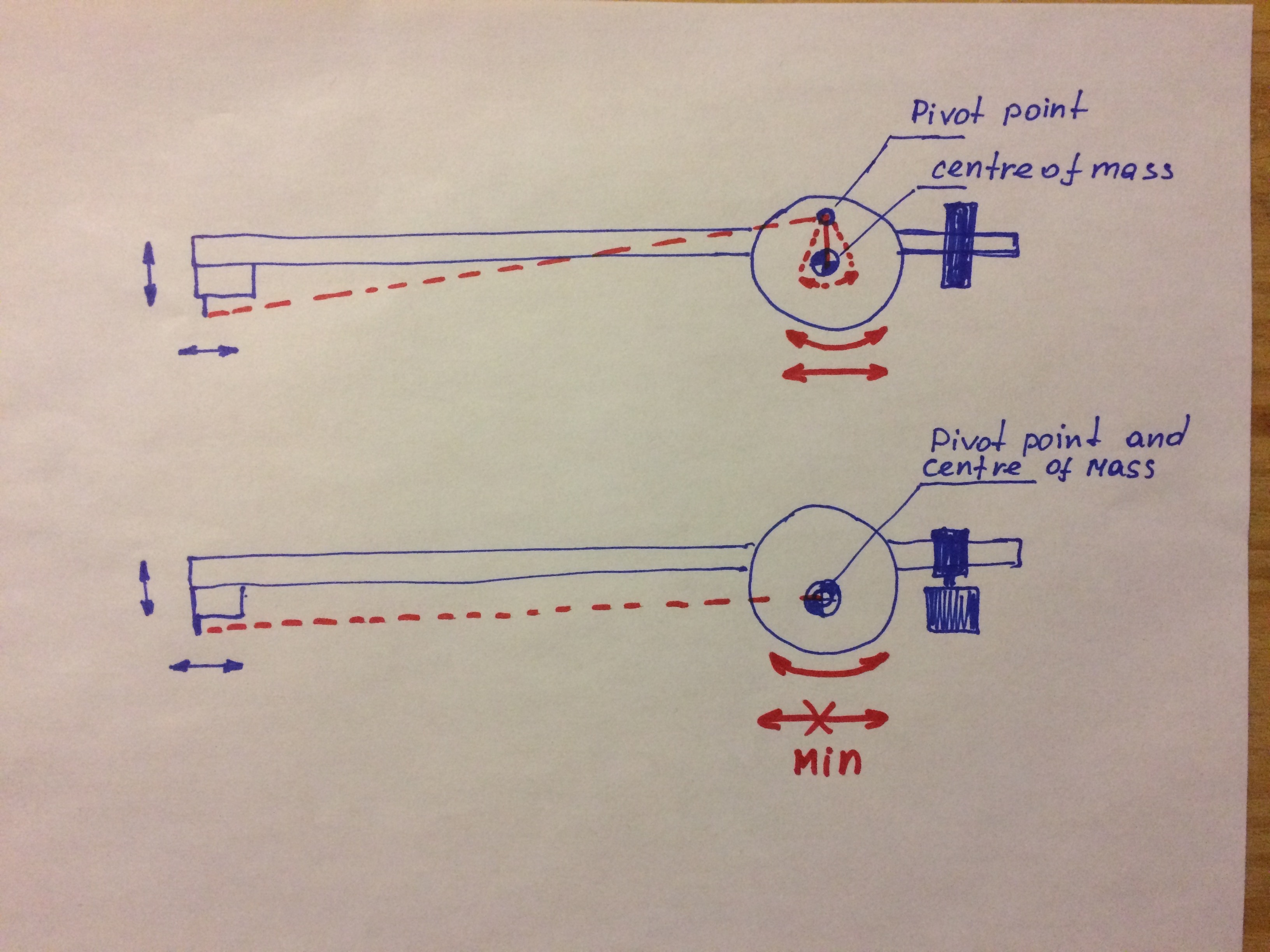

If you move the center of mass of the needle area will be a very good effect.
I have read the opposite. What has been your experience as to the good effects? thank you.
Centre of mass and pivot point.If you move the center of mass of the needle area will be a very good effect.
