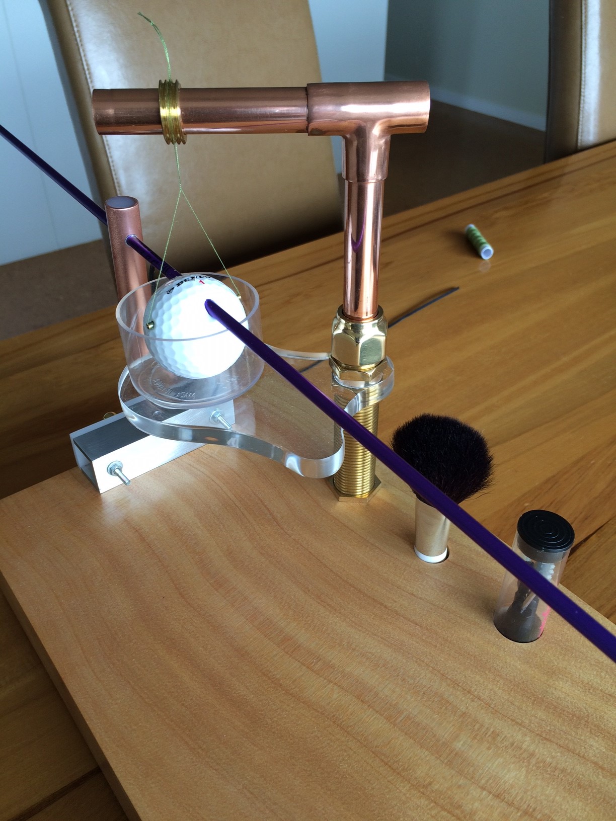

Wow one year since Iv'e been back here!
Life/family.................
I saw this arm sitting in my garage all alone collecting dust yesterday so i thought I'd better get it finished(or try to).
Tried making a counter weight but failed as it was too light, bummer. It was filled with sand and seal up with silicon, back to the drawing board.
I managed to get the head shell sorted and fill the arm with chalk then fill the ends with silicon.
cotton used just to hang it and check count weight.
The arm rest will go up onto the platform after I get it cut to the right length.
could have made the base heavier as I still thinks its too light, but will wait and see.

c/w
Enze,
Just slide it further away from the 'pivot' for now - for testing purposes!
Arguments exist for c/w nearer or farther away from pivot but I would imagine the effect on sound would be minimal whilst seeing how good the arms is😉
My twopenneth anyway
BTW - it looks real good
G
Enze,
G
Can you share where you got the brass 'grommet' on the suspension arm? I'm using rubber grommets on mine for now...
It's just part of that threaded pipe cut down. But I do have concerns about it moving about while the tone arm is rotating or while I'm lifting it into place. Yes I too was concerned about the counter weight moving too far back away from the pivot point?
