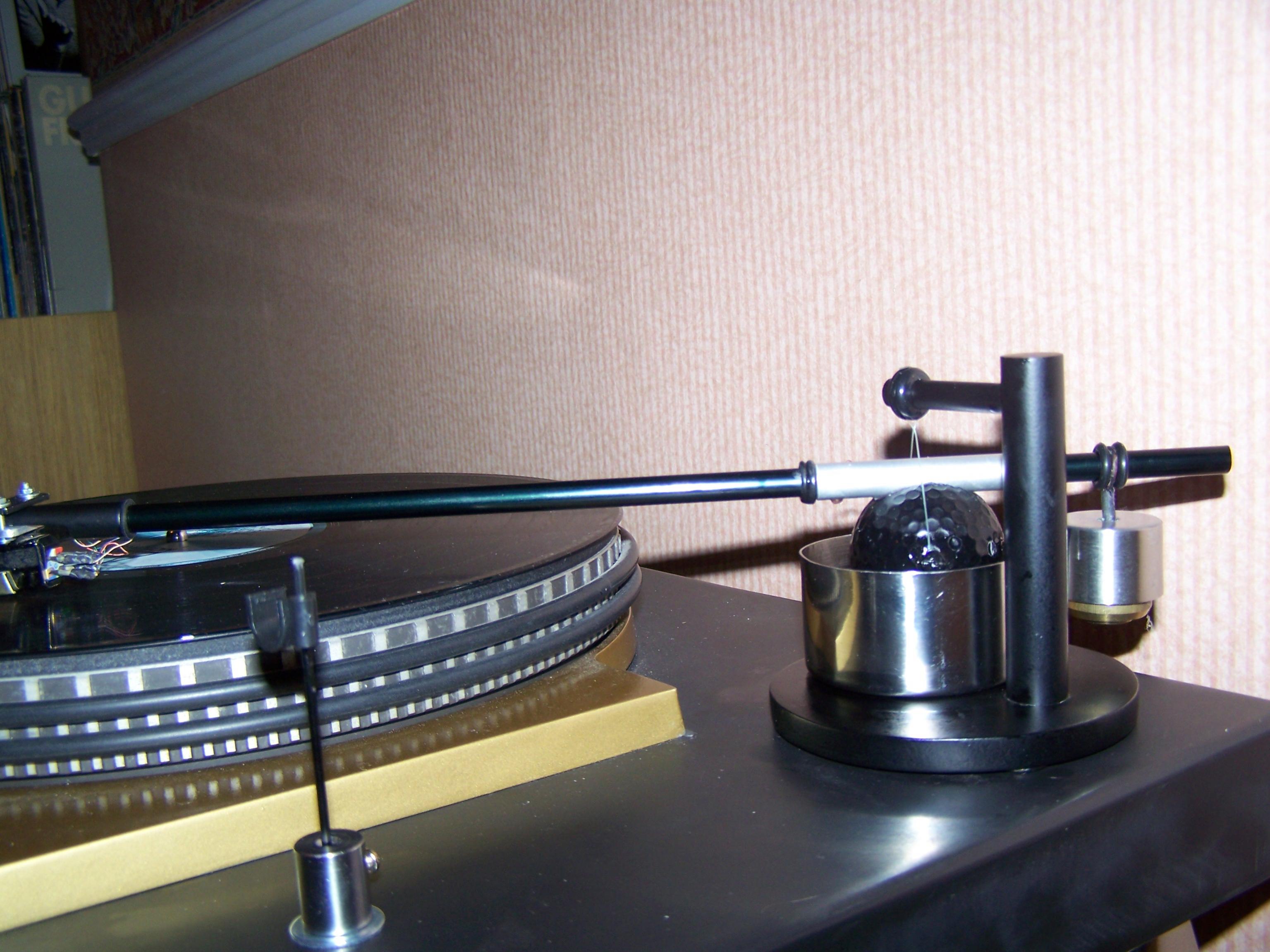

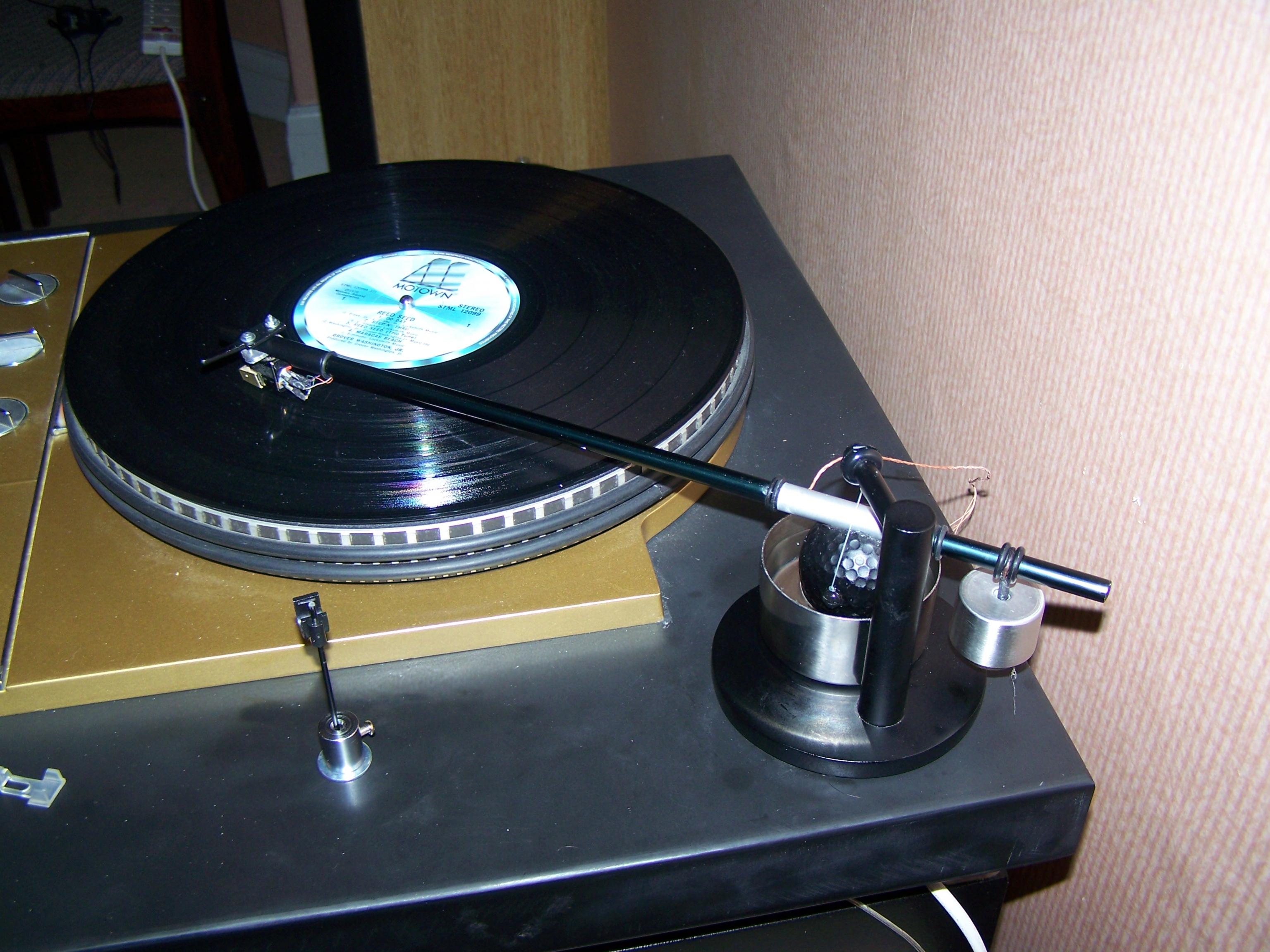

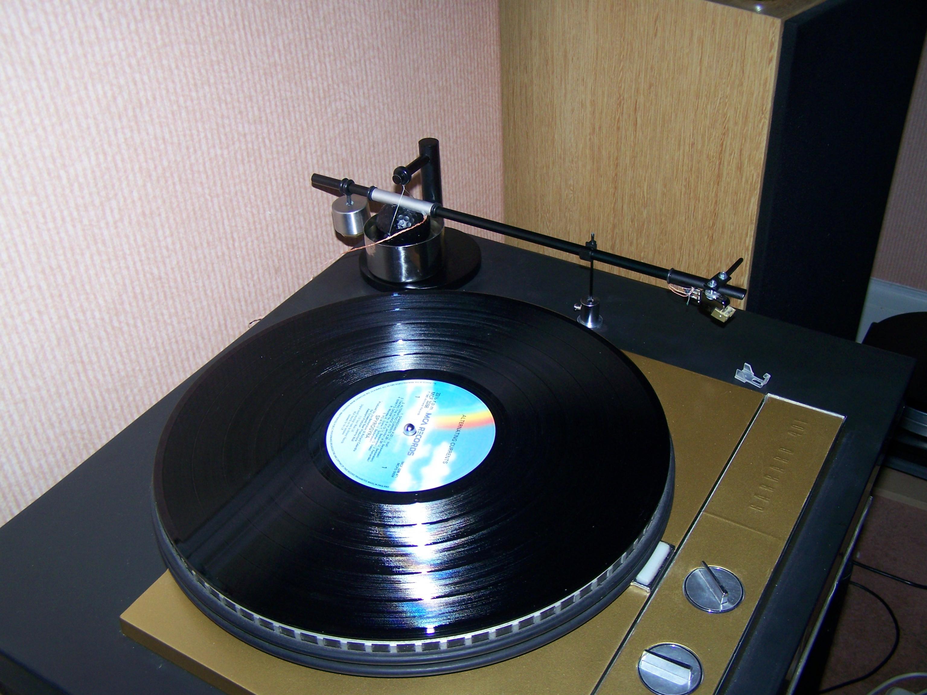

Latest Incarnation
Here are pictures of my latest version. It's mounted on a Garrard 401 with slate plinth. I'm really very pleased with the results-not only aesthetically but also sound-wise. This is my pre-production model.
Regards
Chris
Regards
Chris

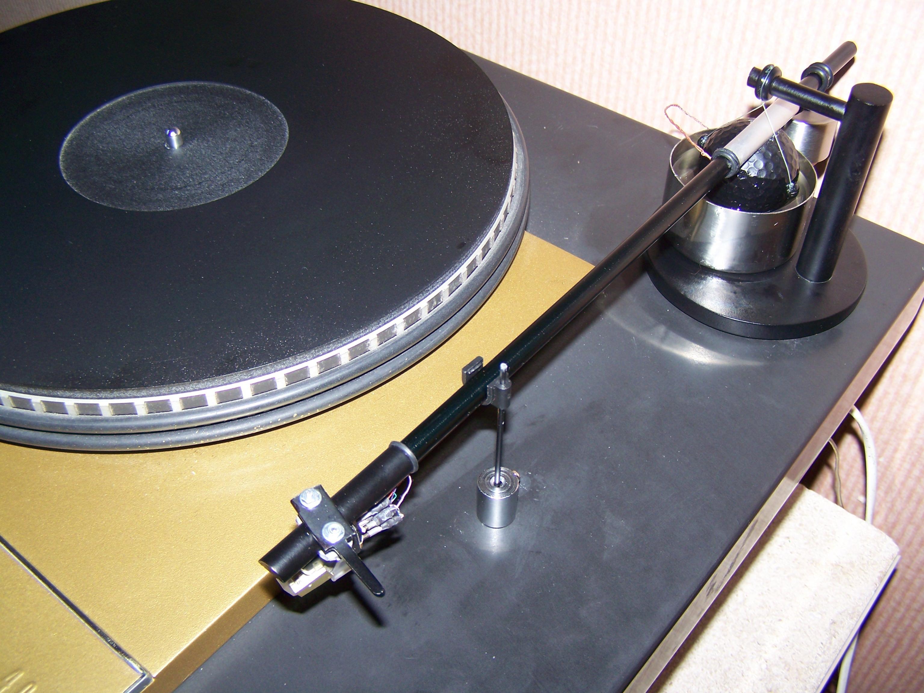

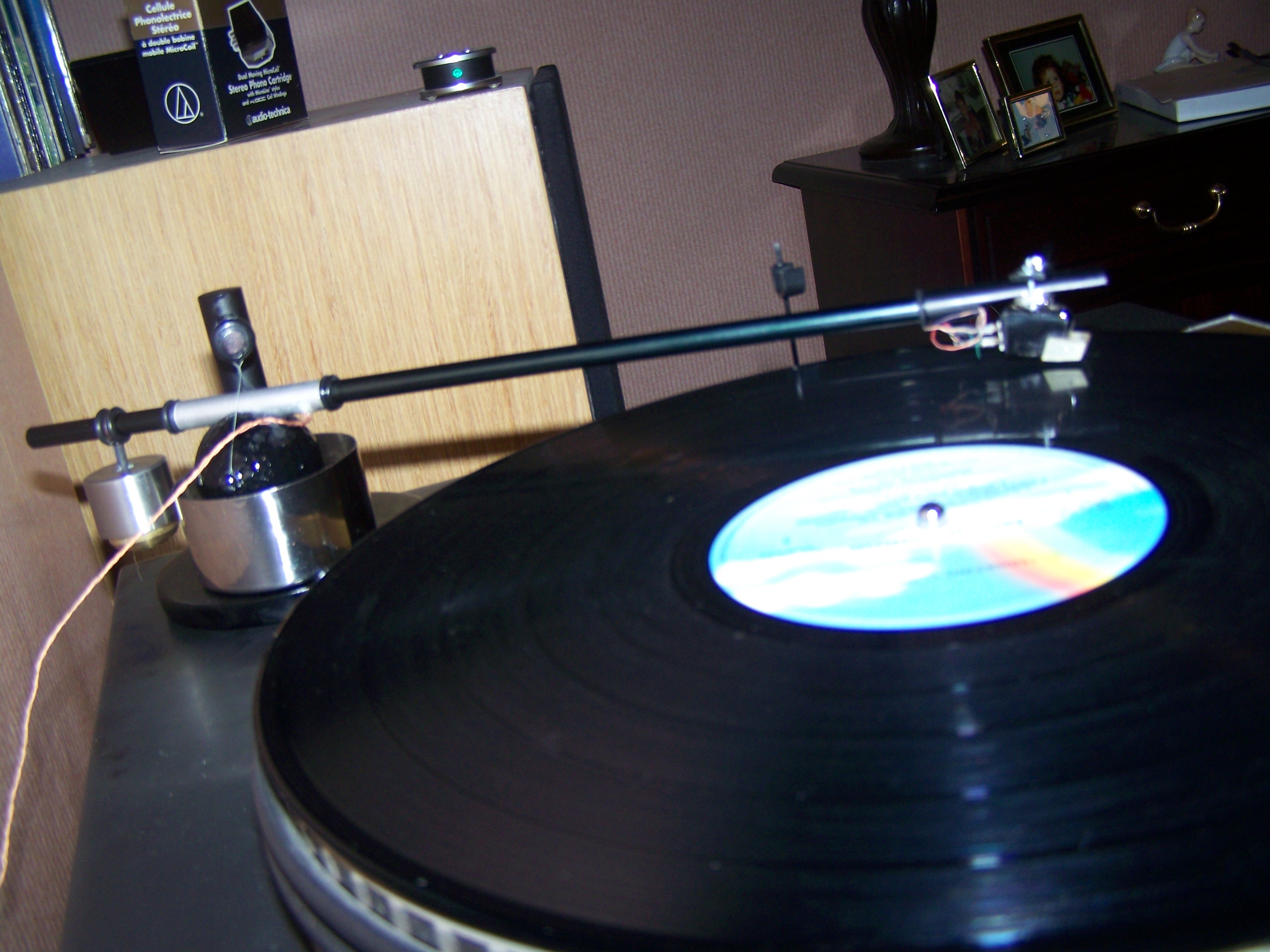

More pics of my arm!
Here are more pictures of my arm which hopefully show up some of the design features. I've been testing it out this week. Sound quality is of the highest standard-details that previous arms only hinted at come through loud and clear now. Additionally people often comment that the 'technical' performance of arms appearing on this site is often absent. I can happily report that it sails through every band of HFS75 with no break-up whatsoever. I've never achieved this level of performance previously.
Regards
Chris
