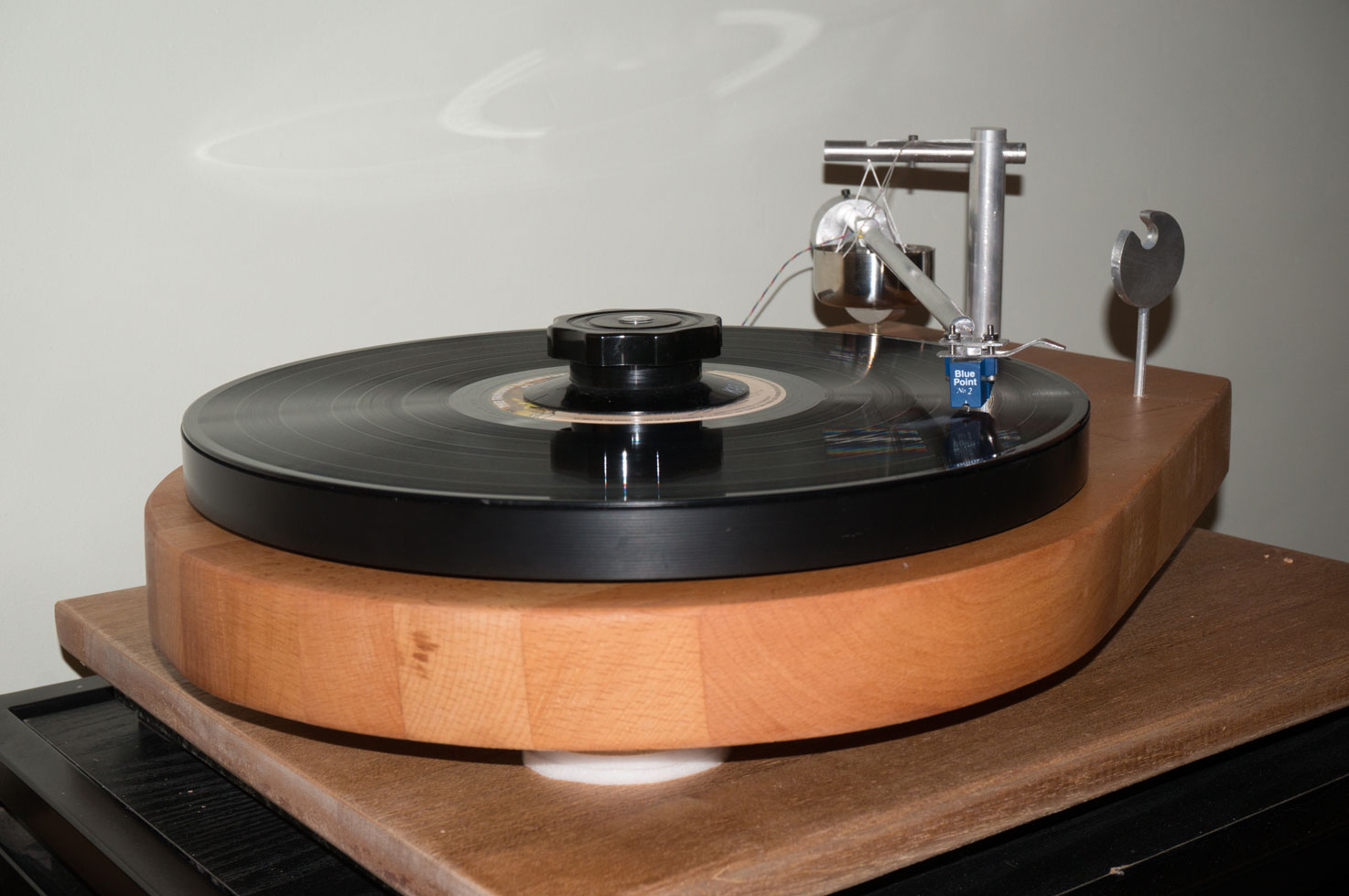

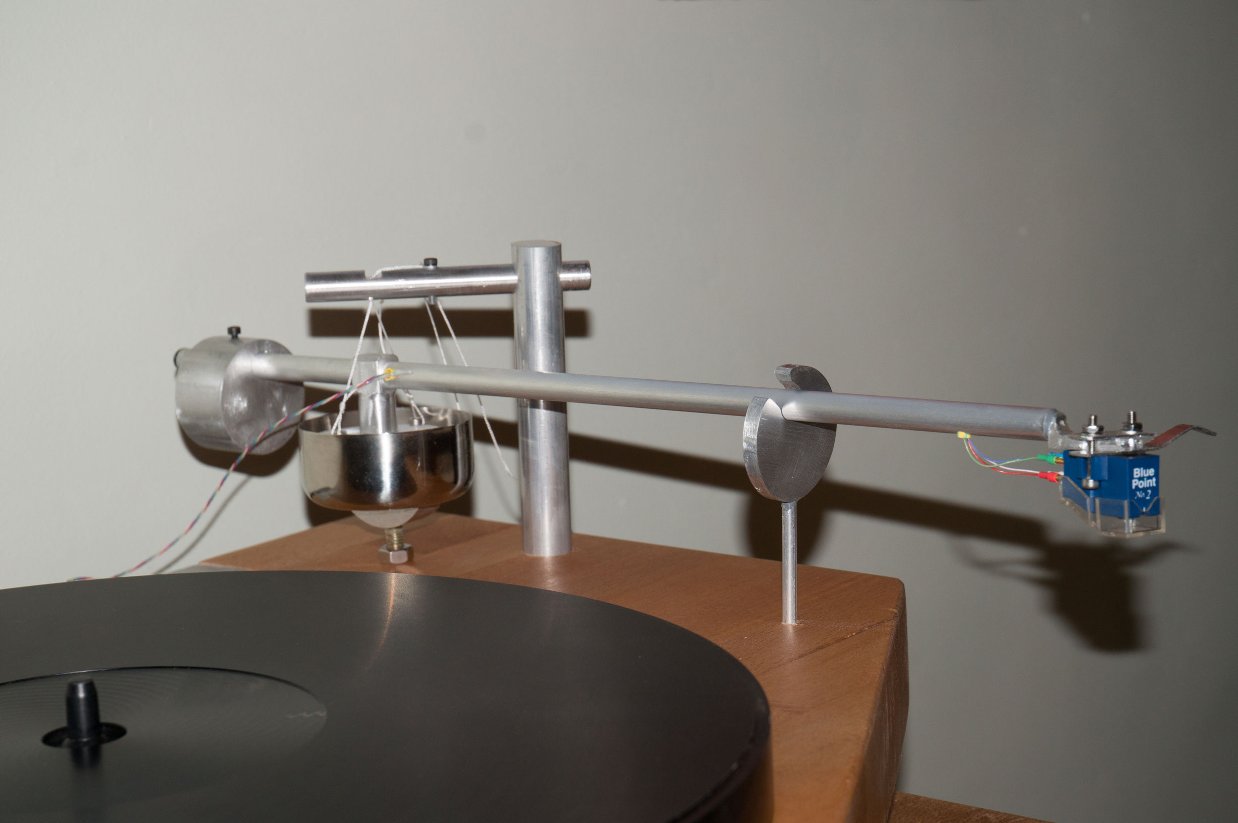

Here's my attempt built from bits and bobs found down the shed.
And in situe on the Home made "Turdtable" 🙂

Just for completeness sake the rest of mine is made up of:
a broken carbon fibre tent pole (the main support stem)
a piece from a dead steam cleaner (the arm, the main chrome shaft of the cleaner was used for the legs of the 'Turdtable)
fishing line
Nike golf ball (Just Do It)
a tie pin
a couple of bits of scrap wood
an aluminium arrow shaft (18 inches)
mouse wire
the counter weight off an old TT arm
a couple of rubber grommits
a quantity of Lynx shower gel (according to the adds the girls will love it 🙂 and it smells lovely )
an old cartridge head that fits perfectly into the arrow shaft
A couple of hours playing on the kitchen table and another project ticked off the list. Oh and it sounds lovely. The fluid will be replaced eventually, it's just an experiment at the moment but it seems to work ok.
I have it plugged into a 5 into 1 phono selector and it's interesting to have the WTL and the Linn Basik running on the same record simutaneously then switching between the two arms to hear an instant comparison on how they play and sound. The WTL is slightly louder and definately more 'open' (the best way I can describe it).
The biggest plus that I have is that I tried it on a Rod Stewart album that I bought but had the worst warp in any record that I have. No other arm could deal with it. The WTL took it in its stride and Rods gravely raspings were heard once more.
It's different, it looks great, it plays very well and it adds a new dimension to the 'Turdtable' that I love.
If anyone is thinking about a DIY project then give this one a go. It's worth it.

Jay,
The original WTA had monofilament lines hanging the arm and arm support disk from the top of the gantry. Line was fastened to one side of the disk. Fastened to the underside of the gantry top was what looked a lot like a circle drawing compass. There was a hole in each of the compass legs through which the suspension line went. The line went up through one leg and down through the other leg and then to the opposite side of the disk. The amount of antiskate force was set by the distance apart the two compass legs were set. The lines really didn't cross each other, just got further apart for more antiskate and closer for less. A clever idea which didn't work out too well. No matter where one set the legs there was always too much anti-skate when only a very small amount if any was required. I redesigned it to eliminate the compass leg thingie.
Good luck with your WTA.
BillG
Thanks, Bill. I used 10000 cSt fluid and the disc is almost identical to the original but the descent is quite quick on my arm (i.e. I can't let go of the arm and let it descend on its own). Looks like I need to try some higher viscosity fluid.

Arch,
I can't give you an actual angle, it will vary with the other parameters of your arm and setup. For starters rotate the disk so that at rest (Park position of the wand) there is no rotational force exerted on the wand. Moving the wand inwards to the center of the record will wind up the spring (string) causing the wand to return to rest when released. The closer to record center you get, the stronger will be the unwinding force. On an arm with an angled headshell the need for antiskate force is strongest at the beginning of the record and diminishes as you go toward the center. The force provided by the wand winding up the suspension strings from the zero force, rest position, actually gets stronger as the need for antiskate force reduces. It goes the wrong way. So now set the angle so that at rest there is still some force turning the arm outward to the edge of the record. As you rotate the wand inward on the record you will reducing the strength of your preset bias force. At some point it will reach the zero bias condition and start winding the spring up in the wrong direction. If you use a record with all the grooves sanded off you can watch this happening. The trick is to reach a condition where at the center of the music portion there is little or no motion of the arm in either direction and all the way across the record. The weight of the arm will help determine the unwinding force. The heavier the weight, the stronger the force. You may be able to fine tune the antiskate with a weight adjustment. I haven't done that so I can't comment on that one. Adjusting the viscosity of the fluid will also change the antiskate force, as will the amount of immersion of the disk or golf ball.
Note: To keep this all straight in our minds Skating drags the arm inward on the record. Anti-skating pushes it back outward.
In some of Bill Firebaugh's writings he states that very little antiskate force is needed for his WTAs. Nowhere is there any mention of the fact that the drag exerted by the silicone fluid on the disk/ball will vary with the pressure exerted by the ball/disk on the fluid. As I see it there is less skating force exerted by the wand/stylus at the end of the record than at the beginning. So this change in outward pressure (skating) reduces the drag and provides a continuous compensation for skating. Hence, as Firebaugh states there is little (not no) antiskating force required. for an analogy, picture how hard it is to walk through water rapidly than slowly.
So as a rule of thumb and an approximation, set the angle so that there is only a very mild outward bias on the arm at park.
Hopes this clears up some misunderstandings.
BillG
