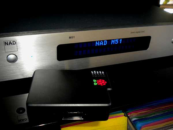

HDMI does not use I2S for audio data. It interlaces audio data with the video stream. Therefore you cannot connect any normal audio DAC to HDMI without splitting audio and video first.
Unless it's a NAD M51 Dac
