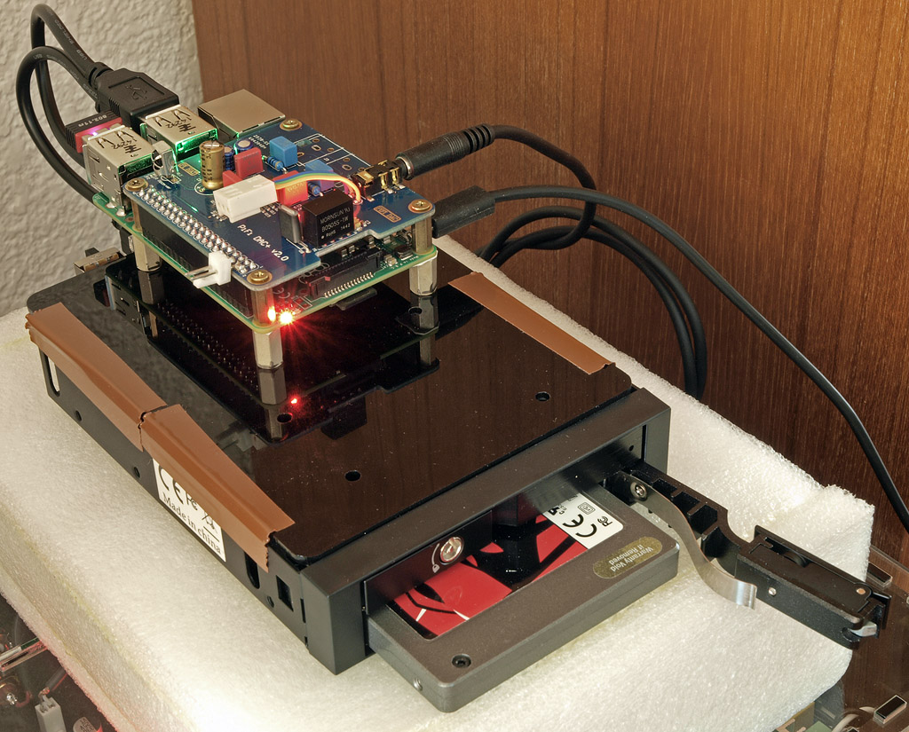

here's the audio board on top of my pi.
which, is on top of a dual slot 2.5" SATA hot swap cage. that has a usb adapter, each, going to 2 of the 4 pi's usb ports. 3rd usb port is using wifi dongle.
really ugly build. chassis is being designed now 😉
will add an i2s->spdif chip later on, as an add-on. for now, the analog-out from the pcm is ok. I am setting the digital gain to 95% so that I avoid any gibbs clipping, that this chip series kind of is known for.

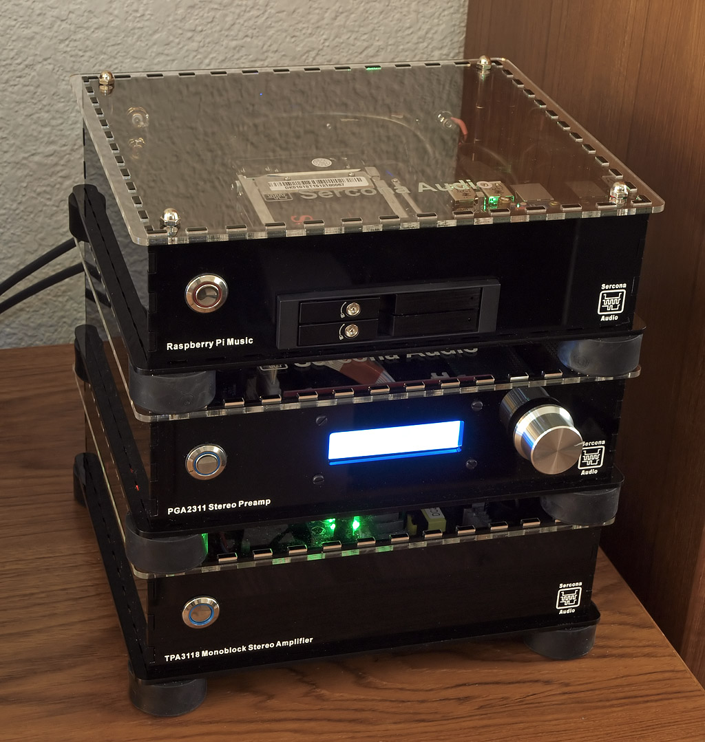

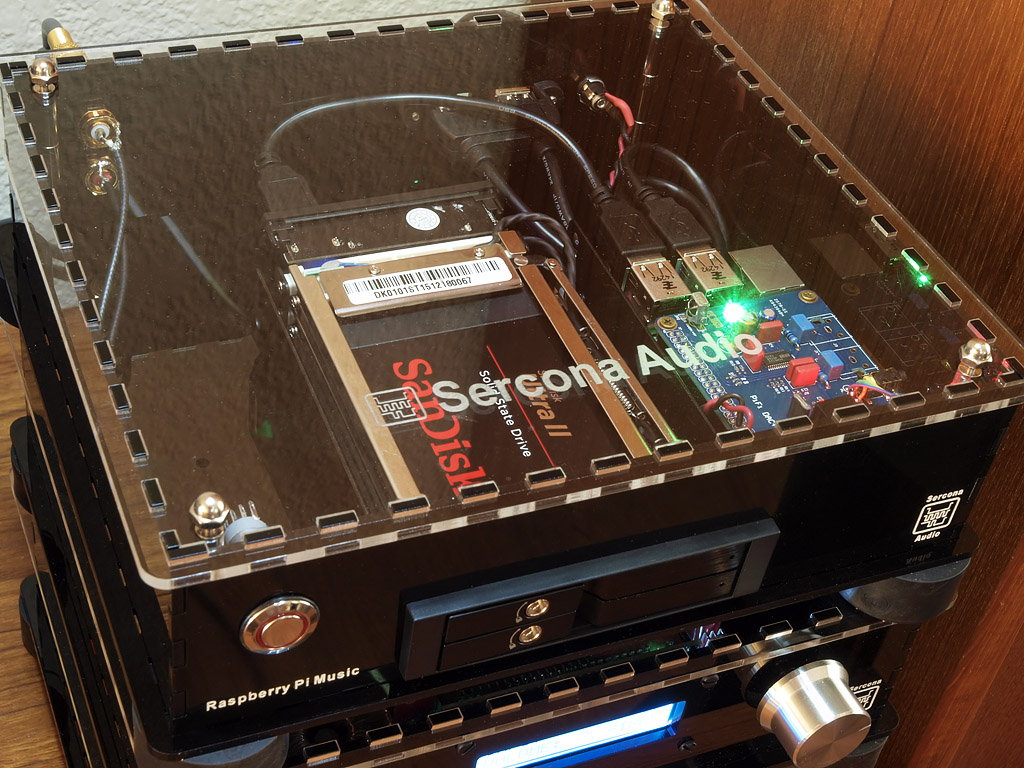

What enclosures did you use, or are they custom designed? redjr

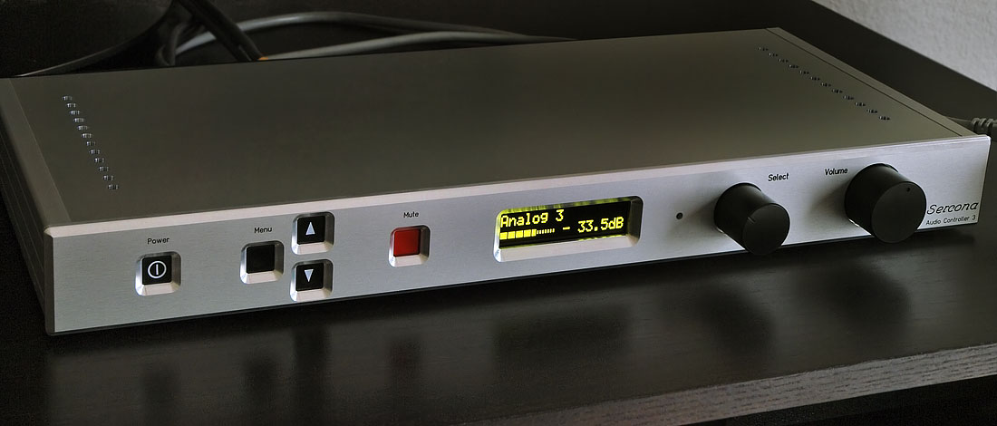

Look at his Avatar. Then zoom in on the photo of his box and you'll see the same logo. Above the logo is the name 'sercona' audio. He is developing a website for this brand here: http://www.netstuff.org/sercona/
I don't know if this is a commercial exploit, but I do like the look of that pre-amp and may like to know how to build one myself !
