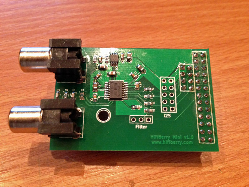

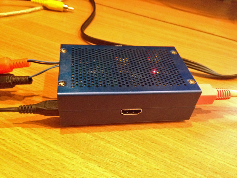

Hi all,
today i had a little bit time and this was the first attempt to try my HiFiBerry Mini from Daniel (Crazy Audio), about some hours.
After a little mistake from me it plays and play and plays really nice (the P5 con on the Pi). 🙂
What should i say, try it! So looks it for now. Next Step i will change the output connectors. When Daniel is ready for SPDIF, i will integrate it to my Pass D1 Clone! Then we should see again ...
The outputs are not last idea, then i will integrate it to the Pass.
Thanks for your support!
