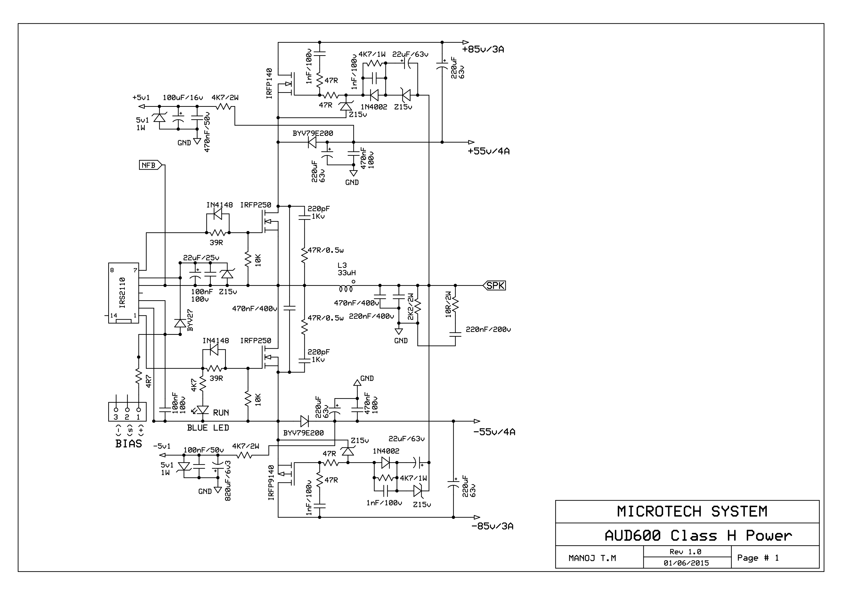

Here is ckt (not full) class D with Class H power😀
Regards
MANOJ
hi sir manoj this is great news did it work .? can the voltage go up to
+/- 145 75 0 75 145 also can the impedance drop to 2ohms . ?? is this method of class h class d stable ?? also the noise in layout?? thanking you for your wonderfull designs sir manoj

Hi Andrew,
Advantage
1. stablity (when low to mid volume AMP running more time on lower supply rail only)
2. Low noise (when low to mid volume)
3. low Bus pump effect ( i think, not sure)
Regards
MANOJ

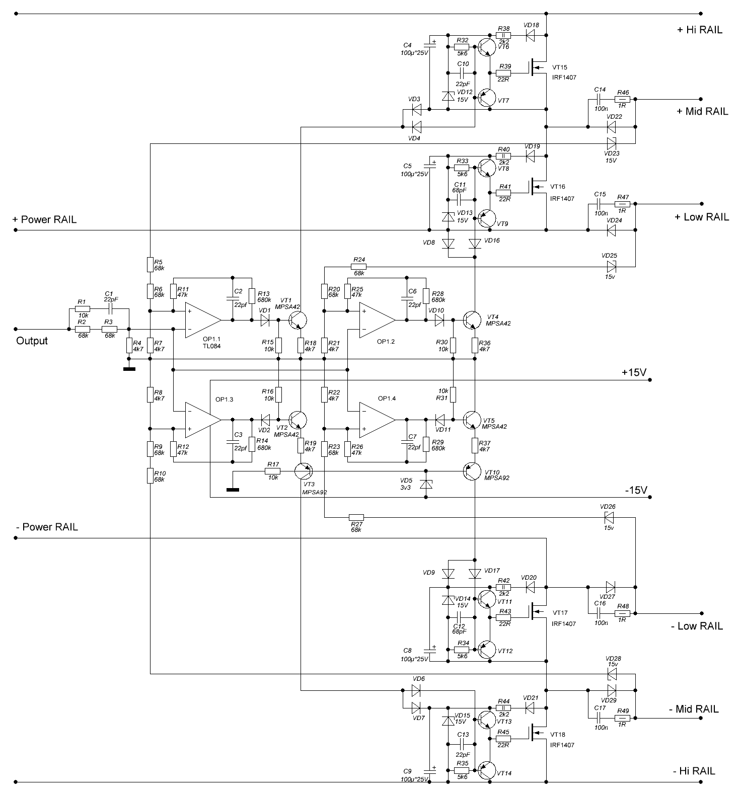

hi sir manoj . can i in-cooperate this 3 steps voltage of class h using n channel fets to drive a class d amp . voltage i intend to use is +/- 45,90,135 ??? 😕
  • forum.vegalab.ru  V.2013 storey PRO-amplifier in the class H pg 11 3 ?????.GIF

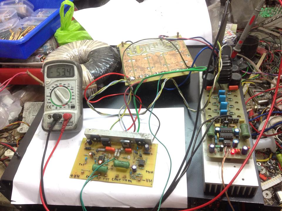

Hello. I wanted your help to understand. I did the test of my class amp d. I measure the temperature of the heatsink. Psu + -70v output amplifier loaded by resistive dummy load. 8ohm 56 ° after one hour. 4 ohm 85 ° after half an hour and protection cuts. The test is done with hard rock music at clipping. is it normal. Now I do not have the speaker that support this power to test in real load. Do the speaker require less power. Help me please to understand if this temperature is normal. With 6 ohm after one hour 65 °

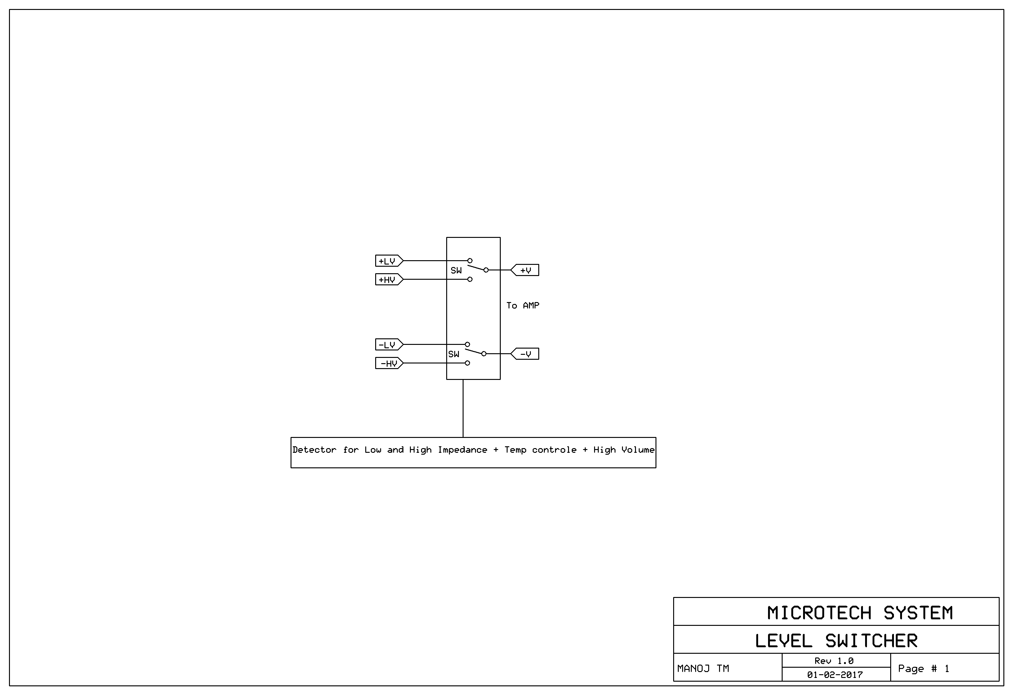

I think 3 stage class H is not give any advantage on class D.normally class d will run on high volt supply range,but the stability on low impedance is very poor on high supply range.I suggest +/-55V or +/-60v max. supply and you need more power use BTL mode
OR Use this
Regards
MANOJ

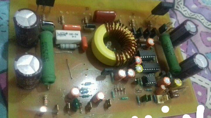

That is true. for low impedances you can put output stages in parallel. you can go up to 1 ohm. to be bridged in 2 ohm. many power
My AUD1000SD i tested with VER2923-223 coil craft coil with DC +/-50v supply its give best sound quality fsw=435KHz(after @10 min it s reduced to 426KHz) MOSFET = IRFP250N; coil & mosfet cool
power out put is 220W @8R 410W @4R True RMS
Regards
MANOJ
Hello. Can I ask you to send me schematic and PCB for this project? If possible attach the file of the PCB in the format of the program,which was drawn printed circuit Board. My e mail alikangelok@mail.ru. With Respect to your creativity
