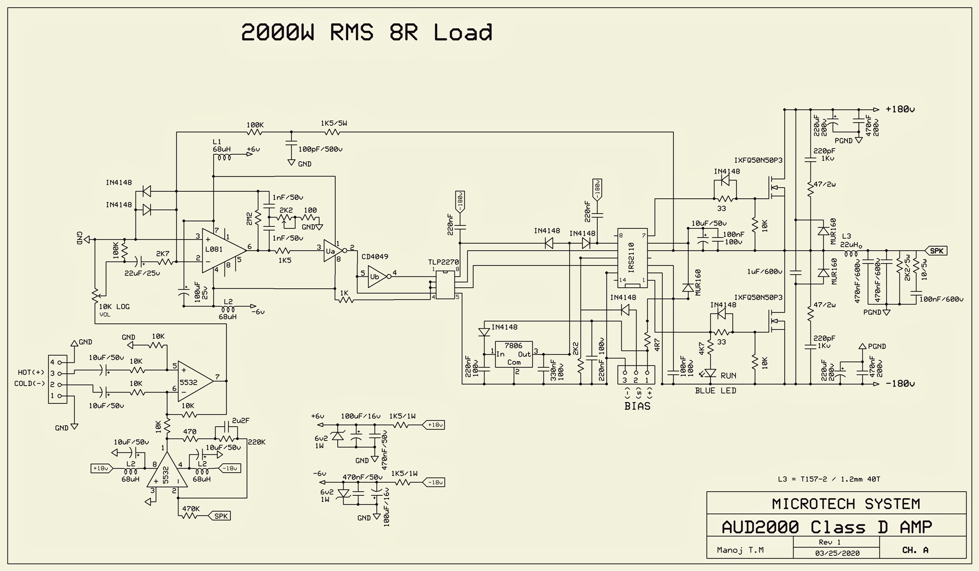

My class D amp

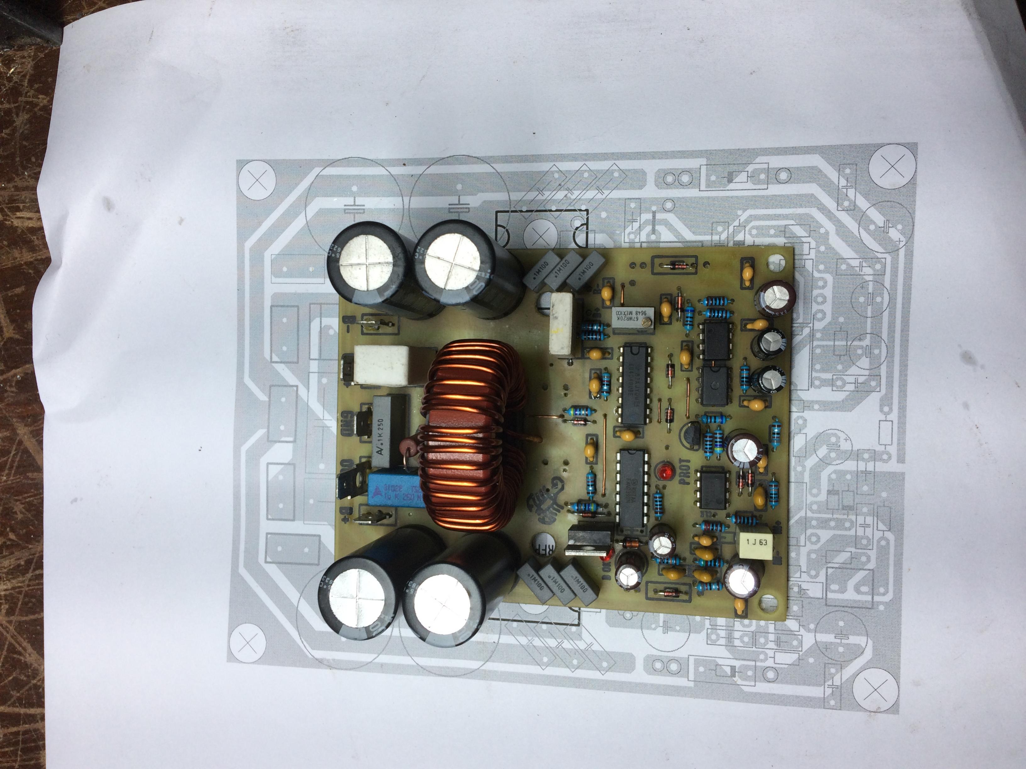

This is the PCB mounted on the amplifier in the first photo.

yes.Waiting TLP2270 & MOSFET and before making PCB i want to check again any mistake in my circuit
Regards
MANOJ
QSC using 500V Mosfet in PL380, Halfbridge, 250 khz FSW
Rail 160 V DC
You will have High Switching losses in IDLE with 180 V DC
Amp is much more warm in IDLE with this high Voltage v/s Class H / TD / EEEngine Amp
I think its better to have max. 125 V DC and Fullbridge
The amp will work, its Basic Standard Design like D4K5 + TLP2270, but SAFE ?
IR need Buffer like D4K5 oherwise get hot
This is my opinion, lets try
