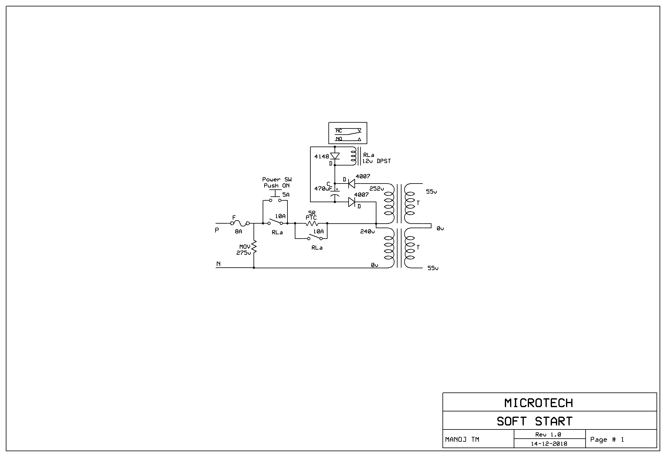

Hi all,
This is my simple soft start circuit. Relay parallel you can connect 12V FAN also, any modification please update 🙂
