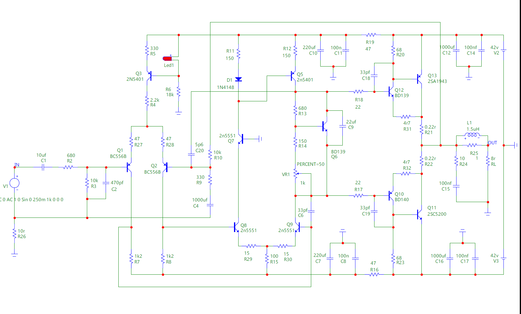

Abetir, I tried to not change too much of your original designed here.
This is my modification.

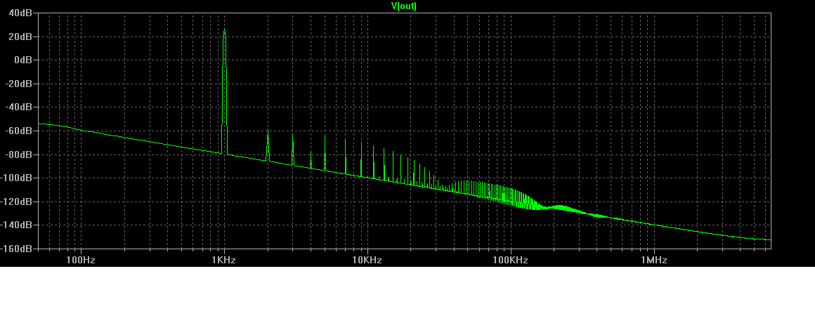

Using CFP reduce slew rate, I do not know how to increase the slew rate. May be using higher VAS current with capable transistor like 2SC3053 can increase the slew rate a bit.
I simplified Symasym amplifier, have almost same result but much higher slew rate and it tested by my friends.

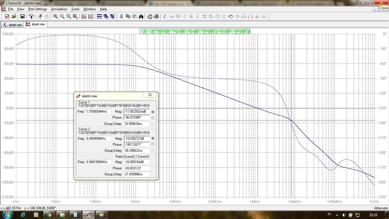

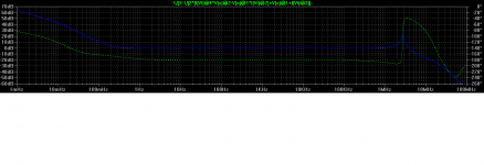

Bimo,
Thank you! will check this out tonight...
Meanwhile...I think I was able to straighten a few things in the design...but the extracted open loop gain is rather confusing...hope I did it right in sim.🙂

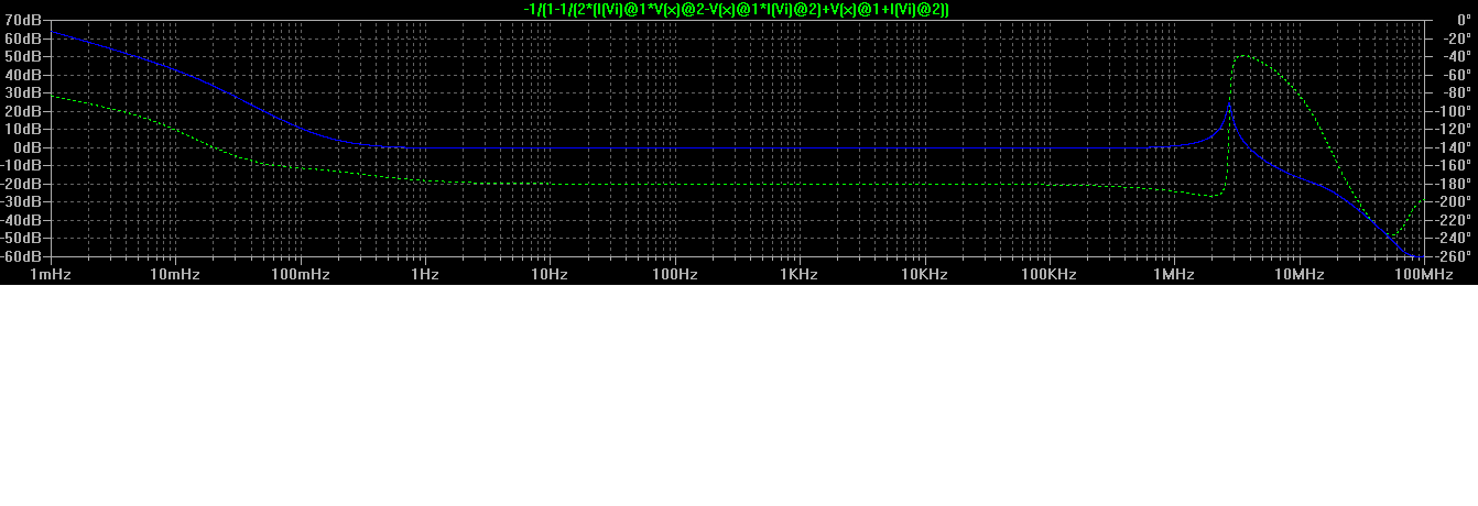

bimo, I don´t get sensible results for the OL-simulation with Your file.
CL-simulation gives ~30dB gain as expected.

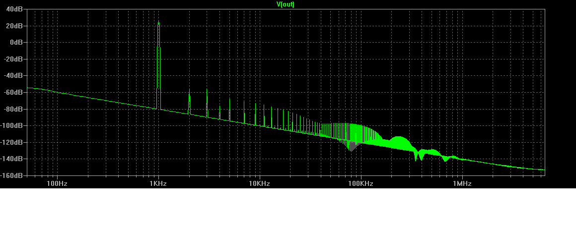

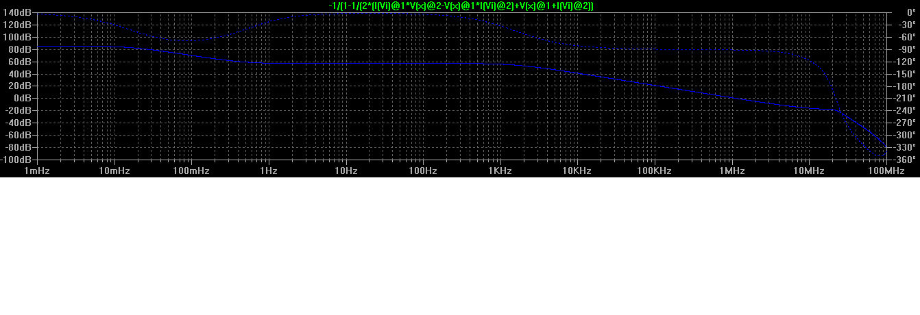

Calvin,
This is my results following bimo's mod...it looks interesting neatier than my work....i just don't know how to probe it..😛

You should read this thread.
I believe it discuss how to use Tian probe to calculate phase margin and gain margin. I learned it from Dadod and Bonsai.
For 2SC4793, 2SA1837, 2SA1943, and 2SC5200, I use Keantoken model. If posible please use Bob Cordells model and Keantoken models.
Please don't chase slew rate. Go for a low overall thd *combined* with low high order harmonics.

bimo, I do know the Tian probing ... guess who´m the schematic of #38 is of? ;-)
With Your file from #51, when I set V3 to AC=0, activated the ";.step param prb list -1 1" line, deactivated ".param prb=0" line and run the AC sim, plotting the "-1/(1-1/(2*(I(Vi)@1*V(x)@2-V(x)@1*I(Vi)@2)+V(x)@1+I(Vi)@2))" line, the result is a amplitude response at ~26dB with a bandwidth of just over 10kHz.
Could You tell what You did instead?

Please set all V1, V2, and V3 AC=0.

Folks,
Anyone care to shed light on the purpose of the LEDs in the attached image? The common base cascode in the balanced VAS is a current error sensor yet this one the base is clamped to minus rail with 3 diodes. This is from one of the late Dr. Bora's VAS design.

The LED for voltage reference (similar to zener diode).
