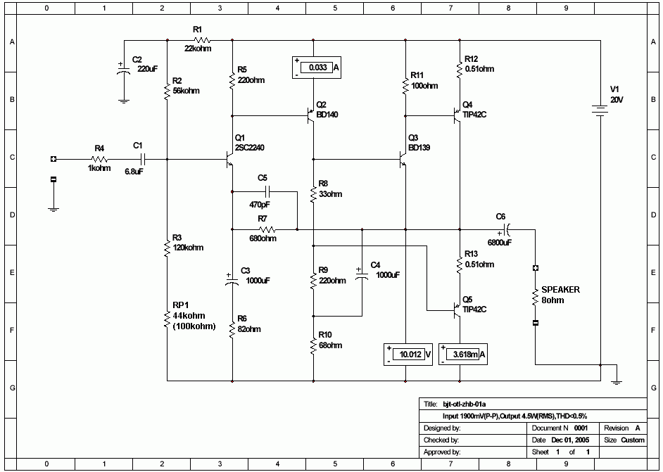

my mean is:
If I can't get AD161/162,I will try this topolgy likes below:
certainly using PNP germanium transistor instead of TIP42C...
:smash:
very good idea but >>>>
don't forget that i can send to you 2 matched pairs ( siemens AD161/162 Z3* ) and 2 ac153K ( siemens ) for free !!!
Please note : Z3 means low gain so you will have to swap " compulsory kiwame " ( 220 ohm - on my schematic ) for 82 or 100 ohm.
The 8.2 ohm which link AD161/162 base will be swapped for 2 or 3 ohm one !!!
* AD161/162 high gain are Z7 series....
Gérard

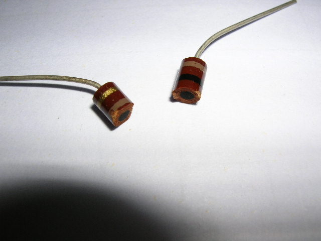

please remember to use high quality resistors ( carbon comp are
largely preferred ) as each of them can be "listened" !!!
Kiwame are my favourite ( lush and warm sounding - airy and communicative - outstanding on piano and voice - accurate stereo ... )
Riken ohm and Kamaya are good choice too ( but expensive )...
regards
Gérard

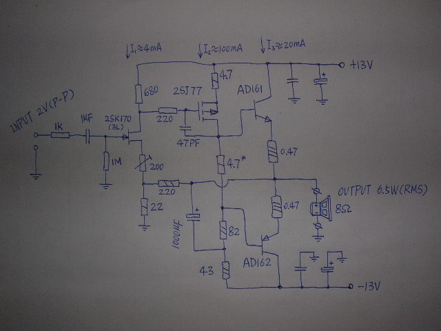

I have one question now,because your AD161/162 shipping to me is low gain,so the driver stage using AC153K isn't suitable,I will using 2SJ77 as driver stage with current at 100mA...
and also OCL I will take(perhaps):
I think this will sounds good as your origin schematics...please let me know what do you think,thanks!
regards!
WINCO
