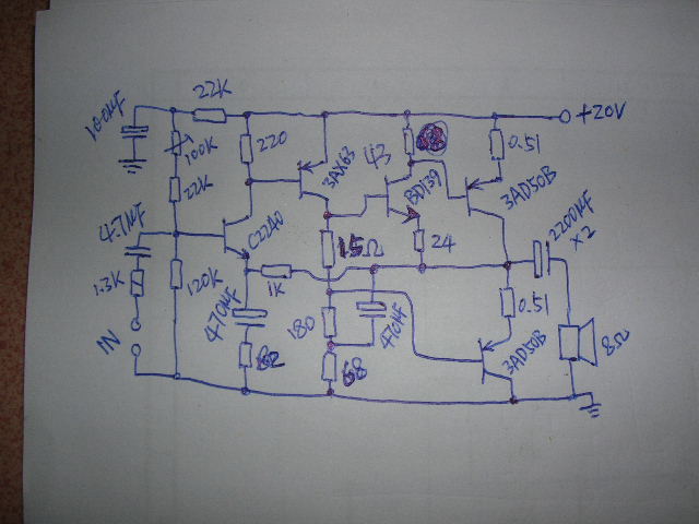

In your previous picture (dscn2140s.jpg), in its lower right corner, I think that the wire from transistor case to ground is not soldered 🙂

it works!
hehe!
adjusted the 15R to 18R,Iq is about 50mA...
It sounds a little warm and some move...
same as good as my mosfet class-a amp,surprise thing!
if I got AD161/162,I think it will sound more good than now.

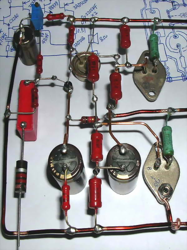

Darkhorse, very nice construction, remember me 1959 equipments.
This construction, made almost the same way tube amplifiers were made..... very nice.
I like your construction.... almost the same idea of RockMandrake...very nice from you two, show us another way to make things...very nice.

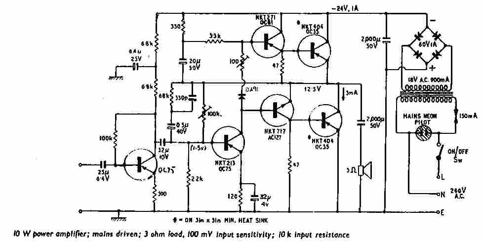

As they say, nostalgia isn't what it used to be! What an extraordinary thread. I built an amp similar to Bones, the PW12-12 with geranium power transistors. Were they OC28's or OC35's? I cannot remember.
It worked well and sounded great until an oscilloscope became avaliable and I measured it. The slew rate was not good, caused by the miller capacitor (470pf in my circuit 330pf in Bones) needed to make the thing stable.
But it sounded so nice. I can only assume that it in a domestic environment you never play it loud enough to get slew limiting
I got a similar shock when I measured a 741 op amp handling a large amplitude 20Khz sine wave. It is a sine-triangle converter!

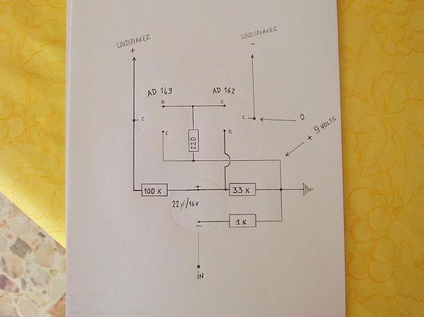

Hi !
How about a schematic of your "little brother" ?

SCHEMATIC
please note :
HEATSINK is compulsory...
Don't hesitate to use very best ( carbon, of course ) resistors ( Riken 'n' kiwame are my favourite )...
This amp offering a great combination of dynamic, rythm and transparency... Midrange and treble blends with an amazingly rich and plentiful bass... It's valve like 😉

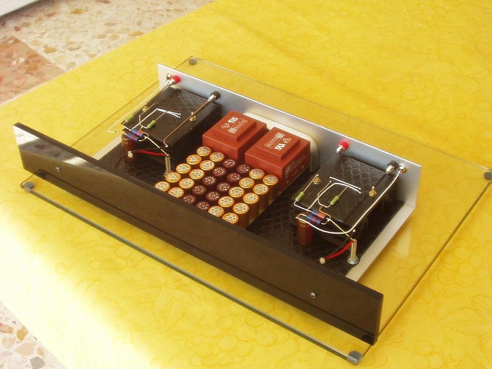

Hello ROCKMANDRAKE,
Thanks for sharing the information. Could you tell more about used PSU? What is the total capacitance per channel, VA of transformers...........
and.. do you plan to use volume control at the amp's input?

Little Brother PSU
Hi TB,
the very best way to optimize PSU is to use batteries ( Sonnenschein Dryfit 9V - 10AH ) 🙂
Otherwise don't hesitate to realize DUAL mono power supplies
( Each Channel )
Transformer : 9V 24VA ( or more )
Capacitance : 20 000 yf ( or more ) /16v
Bridge rectifier : IXYS FBe22-06N1 ( superb ! )

little brother
Hi Mandrake !
I have a little difficulty understanding your schematic. How do you feed the output transistor? Are you drawing DC current through the loudspeaker ?
