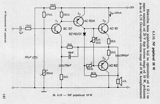

here is the RockMandrake amplifier.
Monsieur Geràrd
"je vous merci pour cette concession par la publicaccion du votre amplificateur du puissance...très gentile cette permission, je suis heureuse pour le votre d'accord"
I thank you by your liberation to make this amplifier published, very kind of you the permission, i feel glad and proud because your agreement related our needs.

hi,Mr Carlos & Mr Gerard:
you are good guys!thank you for show this circuit topolgy.as I reseaching the circuit,I found the driver stage got high currency,that is much easy to drive output stage...good!
but in china,not easy to own AD161/162 GE transistor...and GE transsistor isn't safty enough,but I heard many people like GE's sound very much...they said:just like back to the past time...haha
best regards!
WINCO
best regards!
WINCO
Changing some resistor values..increasing the bias one for example, you can use
silicon units..... those will have 200 milivolts from base to emitter, others will need 600 milivolts, so, some resistors will need changes...the first one, the adjustable will be enougth....i think also the second one will follow the first one...and the bias adjustment resistor will need increasing.
Well, you will loose that intersting "germanium" sonics, but will have the amplifier thopology, that is very nice, working fine.
To substitute, maybe some BD transistors can be helpfull to output.... reducing voltage to 12 volts, maybe BD139 and BD140.....maybe....and the others use BC547 for NPN and BC557 for PNP.....will work also.
If you need, use two BD139 and 2 BD140 in parallell, increase the 220 ohms resistor and include one more diode in series in the biasing circuit...using silicon diodes as 1N4148

Noise problem
Hi ROCKMANDRAKE,
When volume increase to maxium, can you hear any HUM noise? Because I find the VR was placed near by the transformer.

Hi there,
despite this curious (but practical for some reasons ) placement this amp is amazingly quiet !!!

some question...
Hi,Mr.Gerard:
I am very surprise that you mailed me for about AD161/AD162,the things product from england is high quality.
but is too far away...thank you for your warmhearted.
I have some doubt:
1)why using 6.8nF in feed-back loop?
***I think it will bad for HF;
2)I think it's no need with BUX85-10V zener?
3)gain is no need so high(30 times)?
***I know CD can output about 2V(P-P) MAX,you AMP only need about 10 times of gain.
4)there DC current flow through SPEAKER,about 43MA?
***If add one branch (resistor)to instead of speaker will be good?

Hi I found a similar SCH...
Remember a maybe 10 or more years i made amplifier with AD161/162
sound was exraordinary sweet... That was even simplyer sch with OP amp
741 driving... The transistors remain light warm i spoted, maybe it will be possibile to perform Germanium pair in class A?

Hello,
Thanks for sharing schematic of this amp. I will try it. I have currently been using wide-range speakers with GC amp. I will try it with germanium one. The problem is with transistors in US. The only germanium transistors, which I was able to find ( not to mention e-bay ) are ones sell by NTE. Does anyone know about their quality? Are these made now or it is old-stock?
