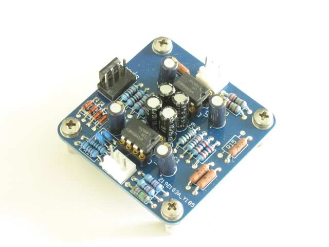

Unfortunately I have no boards left from the group buy. However, I just designed a new board for the same circuit:
After building one and verifying its performance, I have four spare boards of this design. PM me if interested.
The differences from the earlier board are:
  • Input is now protected by a quad of diodes as suggested above by @Mark Tillotson
  • "Normal" size (D=2.5mm L=7mm axial) resistors are used throughout
  • More room for input, output and power connectors - Molex KK254 or similar-sized connectors can be used
  • Slightly larger board, 50×50mm size (one channel)

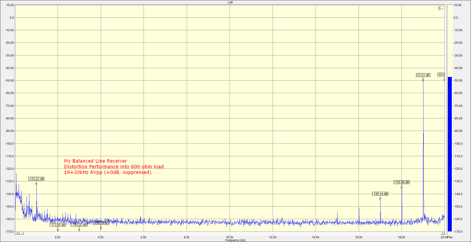

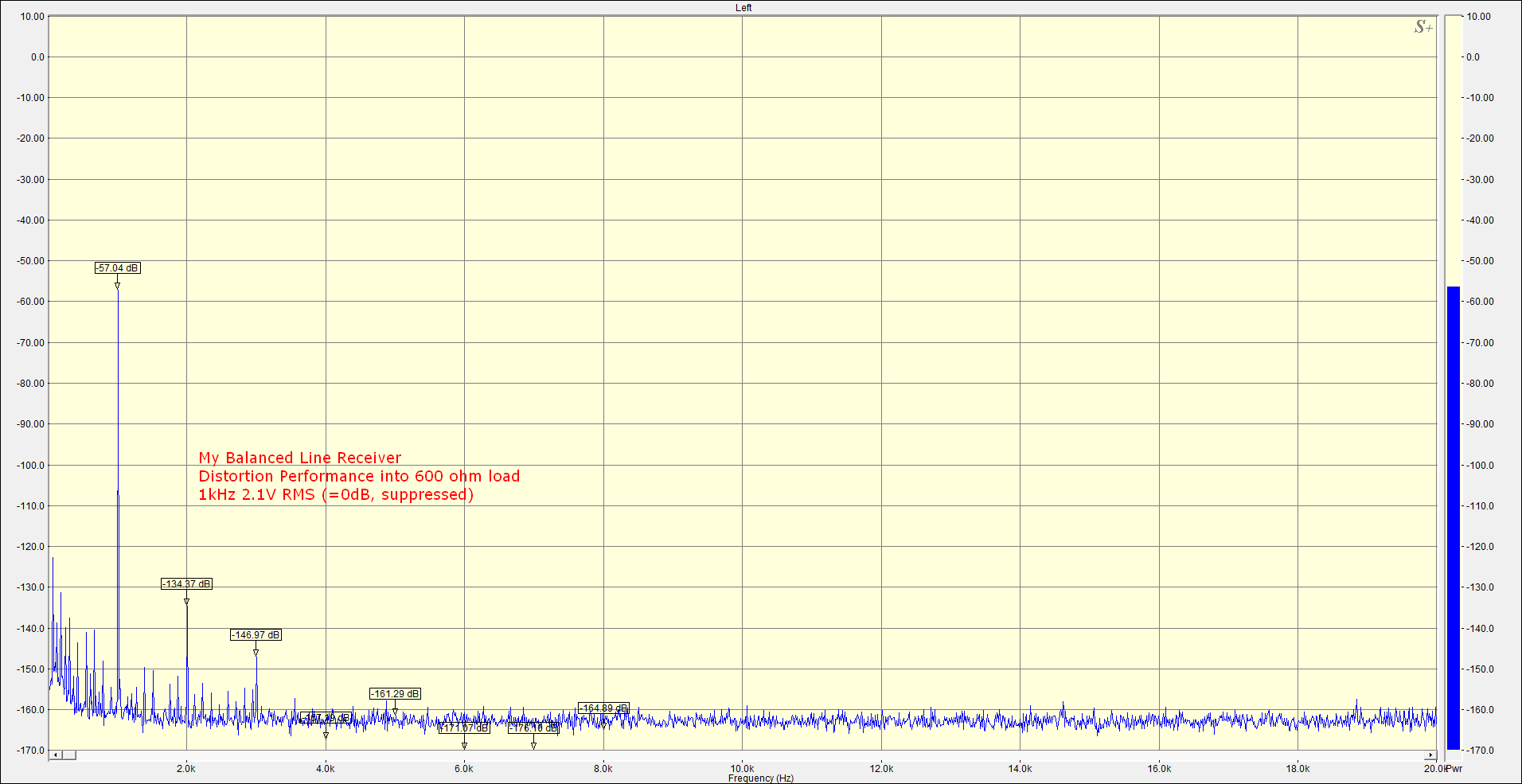

The performance is the same as before. The distortion is determined by the opamp used and is low. Here are some measurements with a pair of LM4562. Note the test signal is attenuated after the board and before the ADC to reduce the ADC's own distortion and reveal low level distortion products:

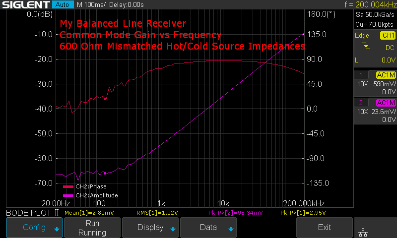

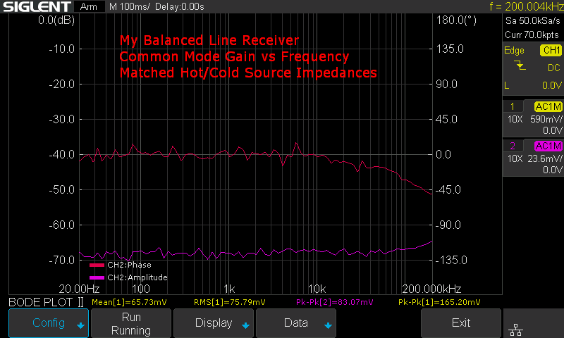

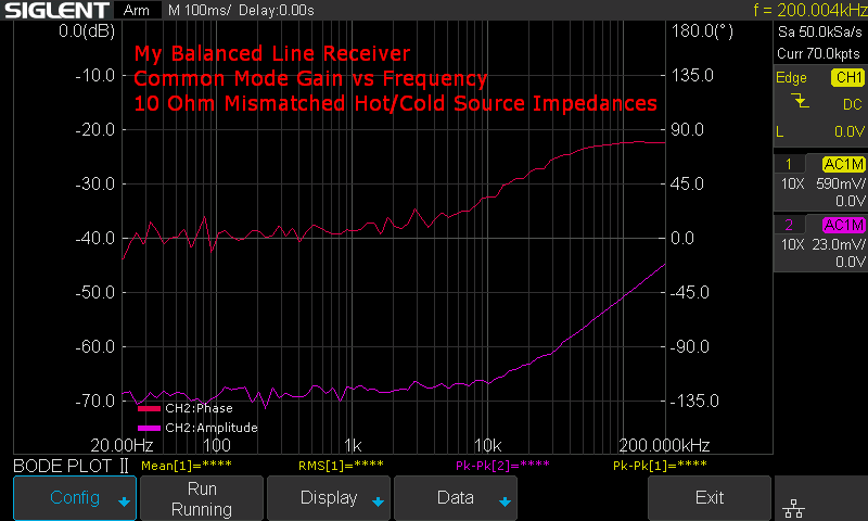

The common mode rejection is very much defined by the matching of the resistors. The results shown below are for 0.1% CMF55 resistors (the brown ones in the photo above):

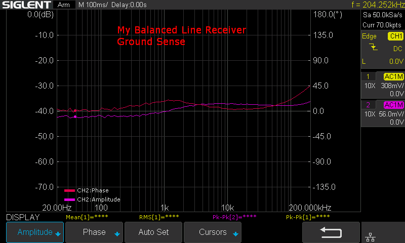

The ground sense reduces the difference between the local ground and that of the downstream device by about 40dB:

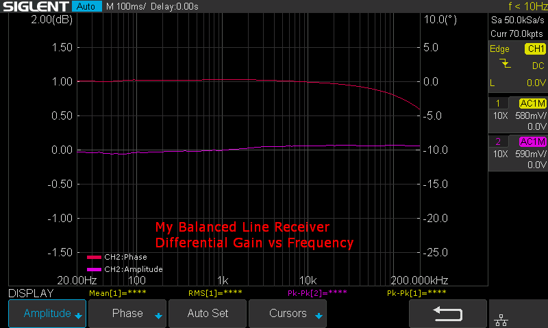

The board if relatively wideband:

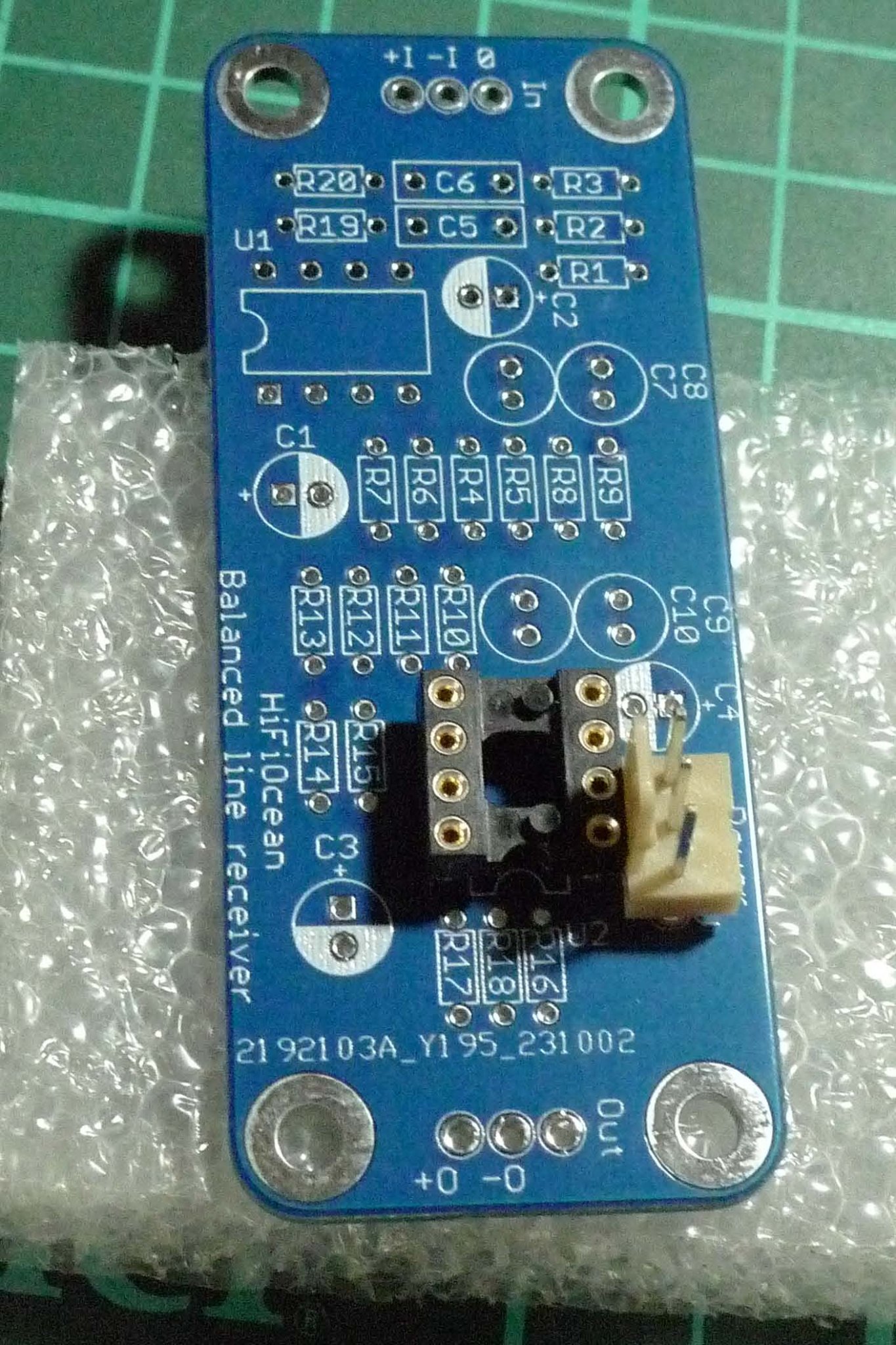

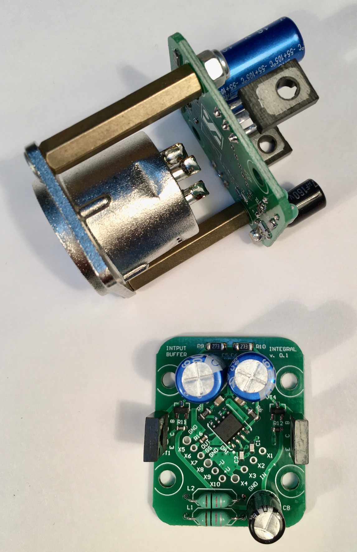

Something like this?
This one is not mine (the source is here, in Russian). This board carries an INA137 and a regulated power supply for it.
I have avoided making PCBs for the public that limit the mechanical layout of the chassis, including connector or knob placement. But as the photo above shows, nothing is impossible.
Reactions: Lee Knatta

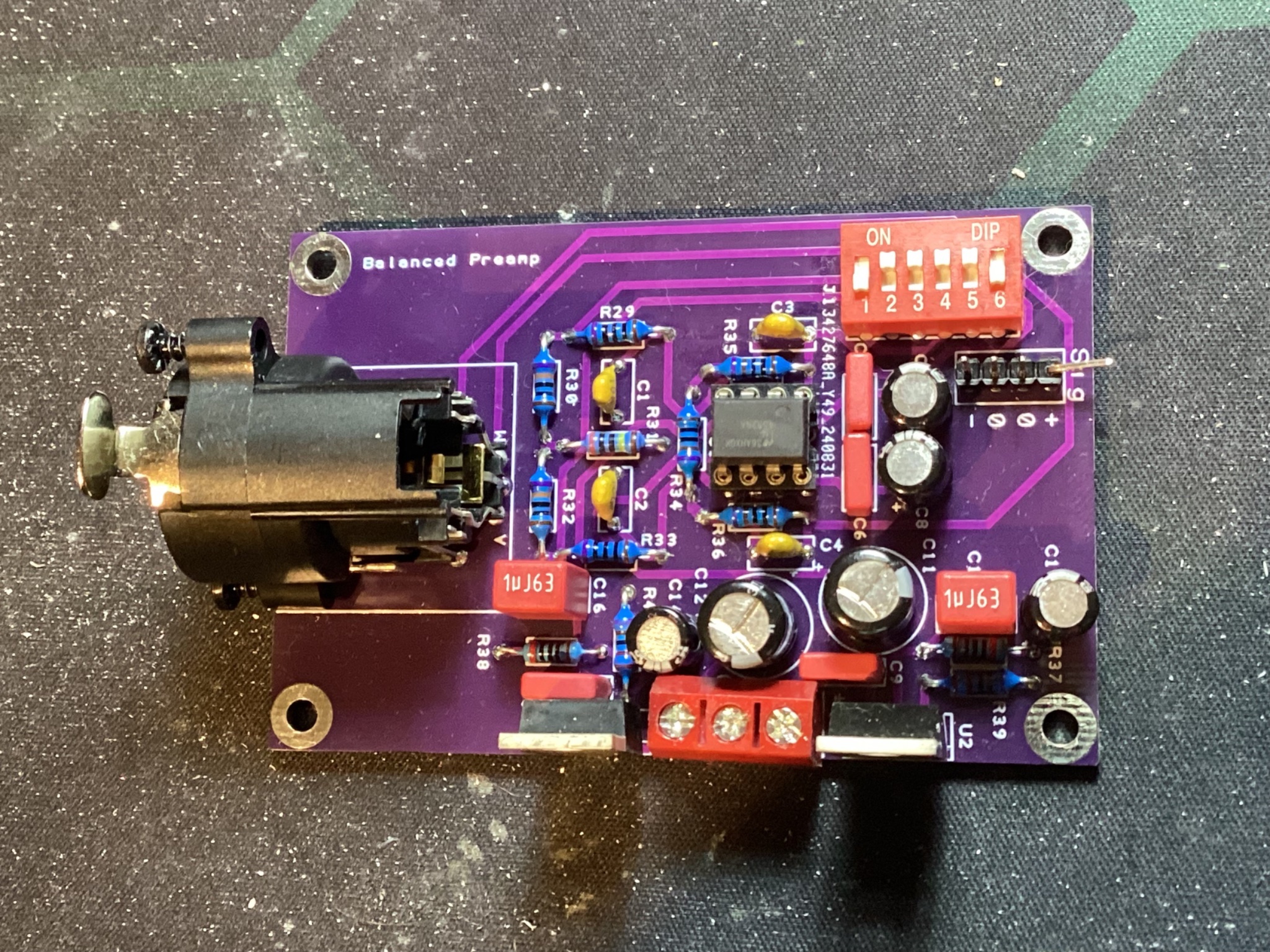

I was thinking a PCB that would mount by directly soldering to the PCB pins of the Neutrik jack, to save on wiring efforts as well as drilling/tapping/mounting on a sheet or backplate/baseplate. As far as universality goes, Neutrik jacks should be available pretty much anywhere in the world and I don't see any reason they couldn't be shopped for any application.
https://www.audiosciencereview.com/...d-measurements-of-hifiberry-dac-pro-xlr.8569/
https://shop.klotz-ais.com/mis-tx4mk-1.html
These examples above have multiple jacks per board but obviously not a requirement by any means.
