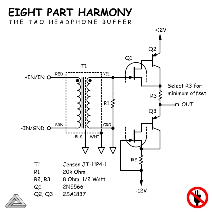

Try this
This is a discrete dc coupled, single ended circuit. Use 50 ohm resistors and your favorite +/- 12 -18 volt supply.
To get around unbalance replace R3 with a 40 ohm resistor and 10 ohm pot. Take the output off the wiper.
The parts are available from several suppliers.
George
