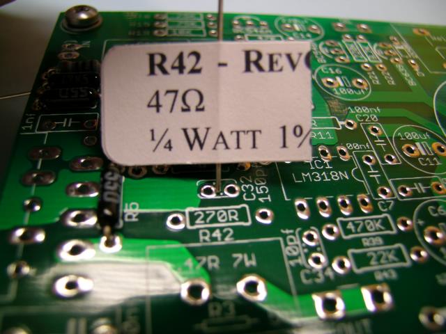

The only discrepancy I am aware of is one resistor marked on the board as 270r but is now 47r. This was a last minute change suggested by Mauro.
What discrep's are you referring to. We would like to fix or note them for others.
Thanks, btw! Glad you like the kit.

Hi float,
Very glad to hear your experience has been so positive this far. I bet you can't wait to fire it up! 😀
Although the schematic does not say so you could actually use a broad range of values for R42 from 0R to 270R I have tried 0R, 4.7R, 47R, 200R, and 270R all with success.
Mauro suggested 47R as being very stable, and thus we decided to use that value. But you could substitute anything in the range of 0R to 270R if you choose.
Mauro controls the schematic.

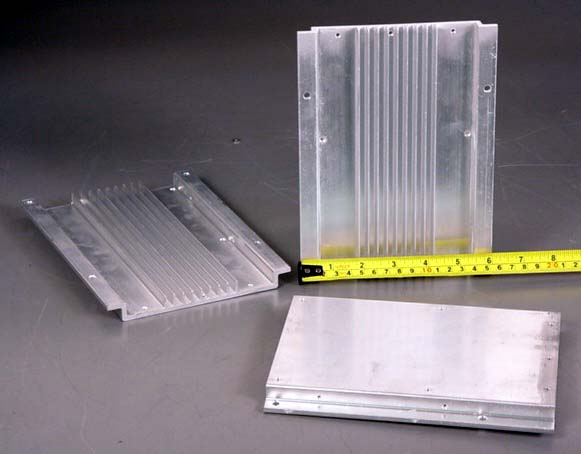

I have heatsinks in now (3" and 4") and will be adding them to the site soon. I will take the opportunity, however, to photograph the drilling and tapping of holes and mounting of the LM3886.

Brian said: I have heatsinks in now (3" and 4")
Which gives me a good opportunity to ask:
How long a heatsink (still thinking barred boss) would be necessary for 3 channels? I'm thinking of trying 5" for front center and right & left rear.
I'm not sure you can fit three mono channels in one 5-3/8" wide heatsink. I've been planning on using 1 -3" per mono channel.
