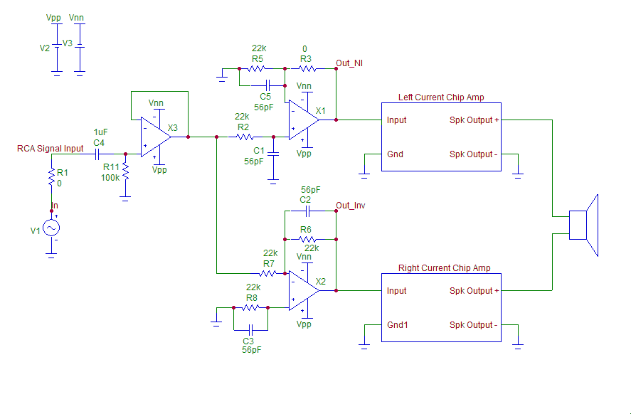

analog_sa said:
this circuit is all wrong

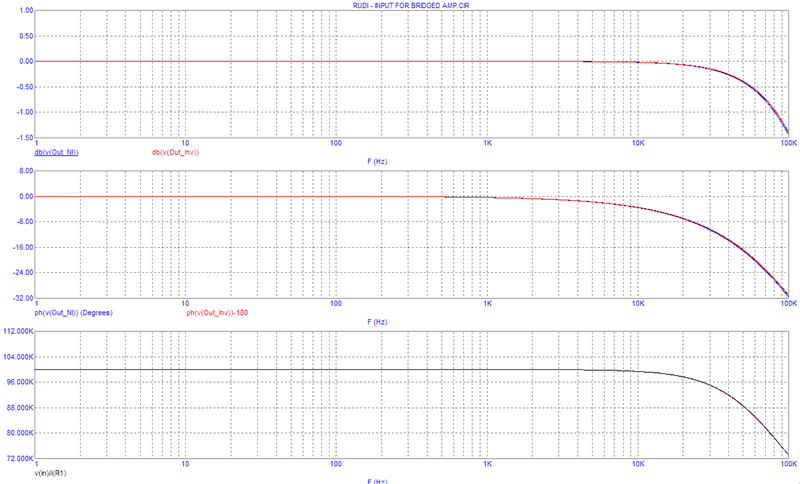

well can you explain why. here is the simulation. and the LF is done after the inverting stage

JosephK's suggestion is certainly first rate but even if you swap the inputs of the opamps it won't work too well.
Function of R5?
Ridiculously high values for R2/R7 - a real noise source.
And more...
well we are always looking for answers. do you have a suggestion.
the original values were 10K but then you need a buffer for my valve DAC

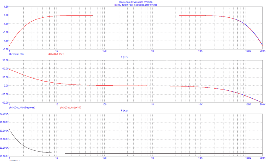

I will not bore you too much on this subject again. Realised last night that Microcap 8's model of the opamp is the wrong way round, I have corrected it just in case somebody else wants to try it, and before I get condemned to the Looney bin and start writing articles for positive feedback while in confinement
Here is my last suggestion with correction and with a 100k input Z. BTW I know that BelCanto uses this technique for their digital amps. It is just unfortunate that I do not have there schematic.
thanks analog-sa. it will also be easier to execute. I will check the spec and see if i can get something cheaper than a jensen

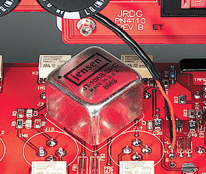

UnixMan has some very valid points about bridging. In lesser designs it usually brings sonic improvements as it simplifies ground return currents.
If you still want to pursue a transformer phase-splitter i can only say good things about the Lundahl 1544 - cheap and very decent.
