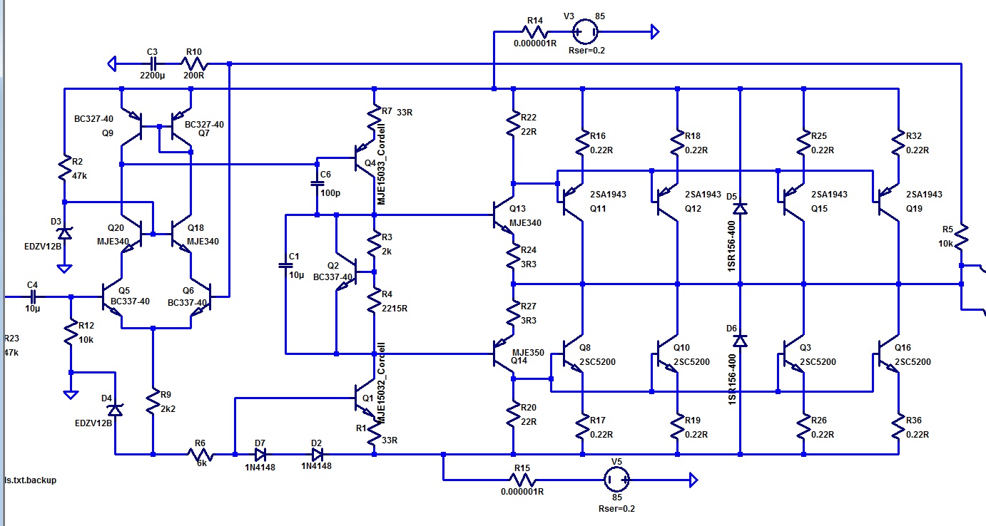

I will take Mooly's advice and set the targets for this project.
The Objectives:
a) Use an existing driver and power stage (taken from Wharfedale S1500)
b) Design/find a SUITABLE VAS and input differential stage
c) The input differential transistors must be isolated from the high voltage using a suitable method. I used a cascode with high voltage transistors.
d) Use the SAME chassis and power supply.
e) Use the existing DC voltages of +85V, 0V (ground), -85V
The Consequences:
i) High voltage VAS transistors are a requirement that cannot be workedaround.
The MINIMUM Vceo voltage is 85x2 + safety_margin. The EXISTING driver stage uses MJE15032 and MJE15033 which are RATED AT Vceo = 350V.

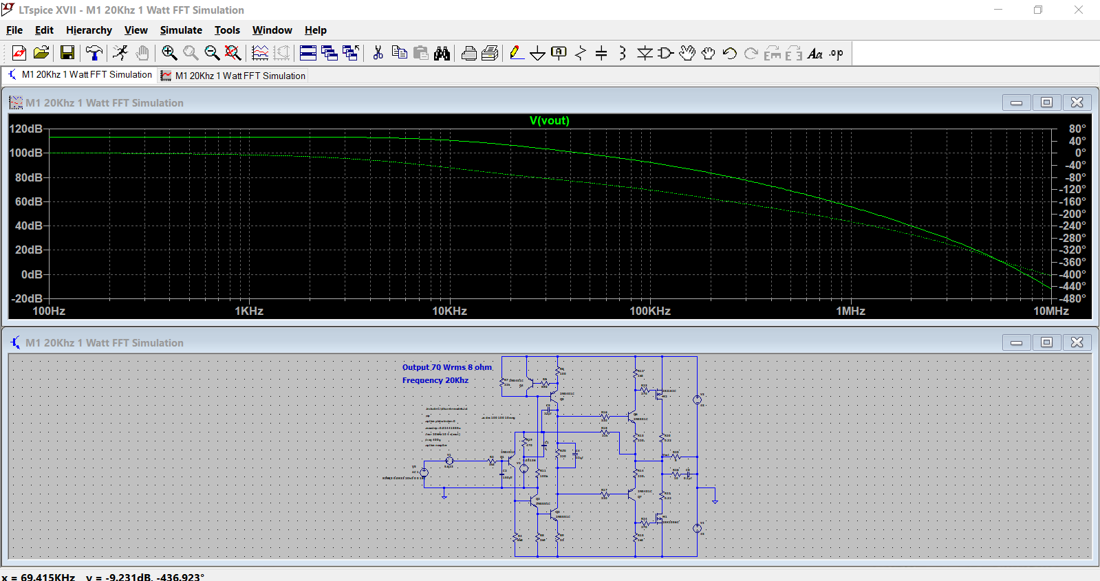

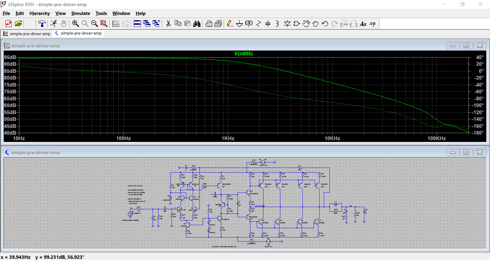

From now on I will concentrate on this circuit. See the attachment in which the Miller capacitor and feedback loop are disconnected.
With a signal voltage of 1000mV, the open loop gain is a staggering 96dB. However, with a signal of 1mV the open loop gain drops considerably to a mere 36dB.

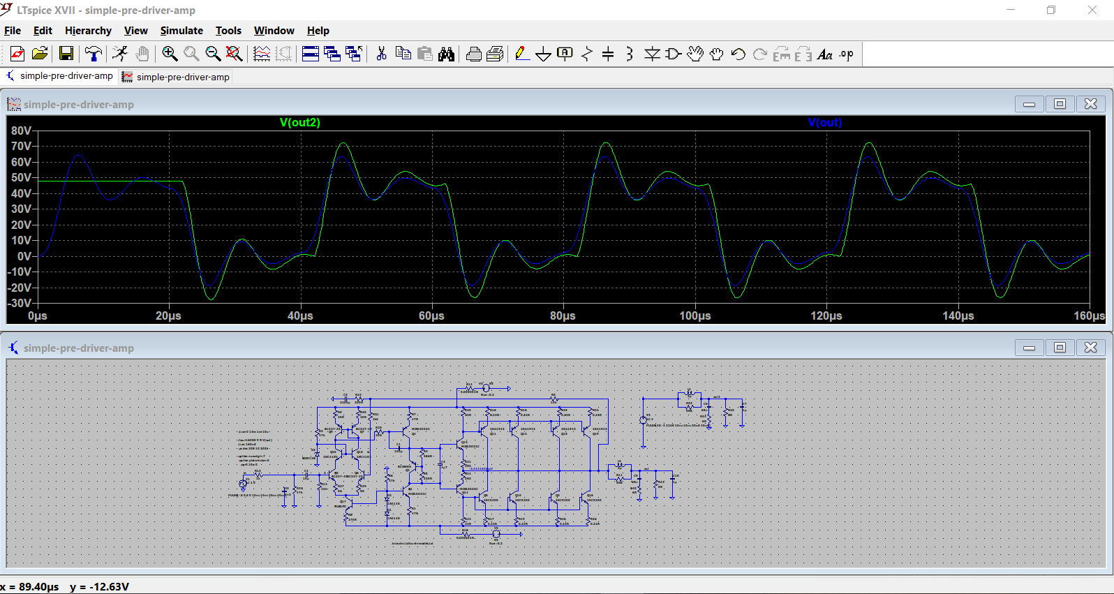

Ib(driver_transistor) and Vout under open loop conditions.

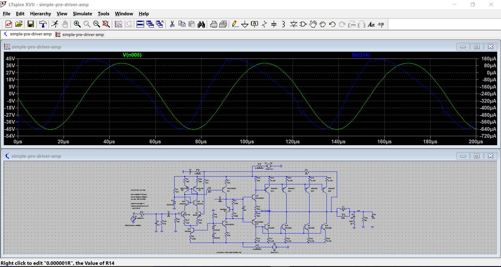

The attachment show the output waveform under open loop conditions. There is far less ringing of base current of the driver transistor. The distortion with this high output level is around 10%. The simulated signal frequency is 16kHz.
It is interesting to investigate why under open loop conditions the driver's base rings considerably less than when the loop is closed.

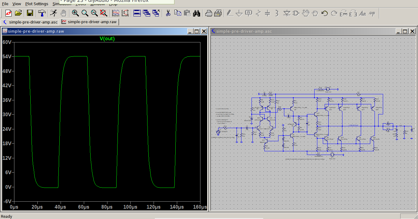

PS: [More Testing]
With the feedback loop closed and the Miller capacitor connected. Up to 9.35V peak output, there is practically NO ringing of the driver base current. The ringing appears as a kink that is just noticeable.

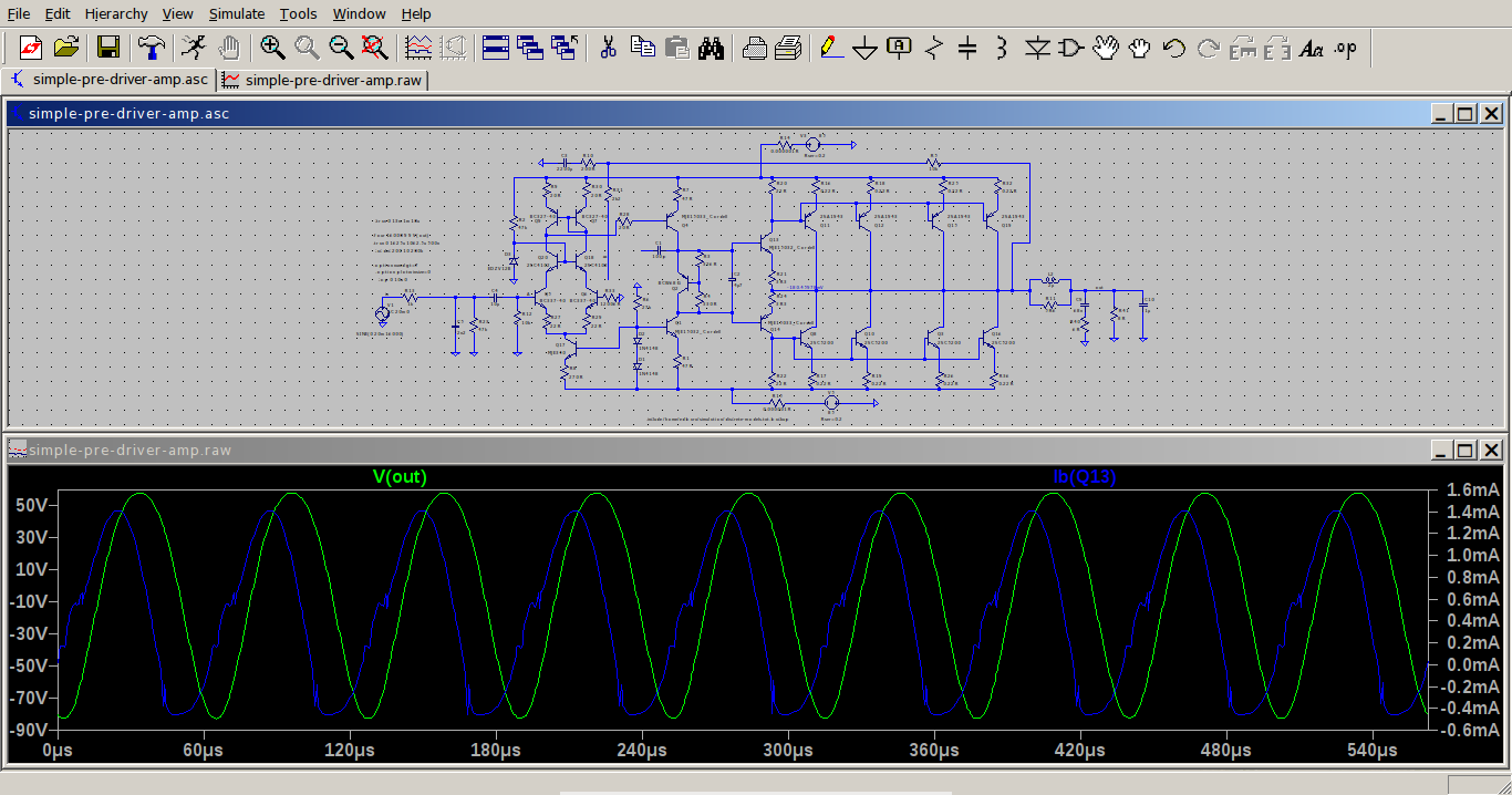

You can achieve similar results by making the feedback return cap very large (try '1' which is 1F, don't enter 1F though which is 1 Femto in LTspice). Doing it this way preserves the correct DC conditions. Short out the feedback return resistor.
This is with 10mv applied to the input.

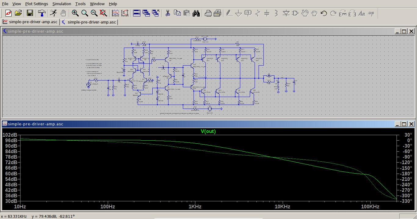

Thanks for the trick of eliminating feedback without having to find a suitable resistance to pull the output to zero volts under no signal conditions.
Using an emitter resistance of 56 Ohms for differential pair pulls the open loop gain down to:
At 10Hz: ~300 times
At 16kHz: ~150 times.
I don't know what open loop gain is best suited for maximal stability. With the above open loop gain, the AC Analysis is as attached.

The peak in your response is because you are measuring after the output inductor which means the inductor reacts with the load capacitance. Try measuring before the inductor.
I think conventional wisdom suggests you should really be aiming for a high open loop gain. My own amp, which is very uncomplicated achieves high OLG using just a single ended input stage.

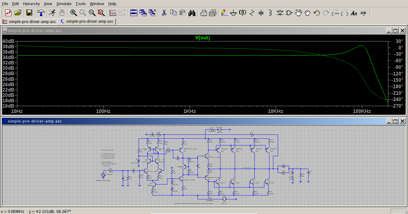

With an emitter resistance of 12 Ohms the open loop gain is:
At 10Hz, 98dB
At 16kHz, 66dB
Without an emitter resistance the open loop gain maximum is 102dB.

With differential pair emitter resistors of 12 Ohms and with the output filters disconnected, this is the square wave test with a slew rate of 15 million volt/sec.
Making the load slightly capacitive by connecting a 1uF capacitor in parallel, oscillation occurs quite vigorously.That looks pretty good actually. Nicely shaped and no suspicion of oscillation.
Twin wires have capacitance which cannot be eliminated. With the inductor the oscillations are greatly reduced but the overall shape of the square wave is not as neat as that with a purely resistive load.
Looking at this design, IME, you guys have a potentially thermally unstable OP stage.
If we take the MJE340/350 drivers, for an increase of 1mA quiescent, EACH OP device will have an increase of 30mA (x 4 = total 120mA).
Since the VBE is a BC337, if it is a TO92 case you will have some issues achieving the required thermal coupling as the whole OP stage, being VBE, drivers and OP devices will need to be VERY well thermally coupled.
If thermal stability ends up being an issue, try the following:
- Use small flat pack BJT for the VBE bias transistor and clamp it close to OP devices on the heatsink.
- IME, you can tweak the thermal 'feedback' by the current rating (geometry) and early voltage of this transistor. For example if the OP stage tends towards thermal runaway, try a VBE BJT of higher current rating and observe it's behavior.
- Insert some small value resistors, (say 0.05 ohm) resistor in series with R24 / R27 which becomes OP device collector connection point. This will provide current run-away feedback.
WRT actual amp stability, my, and many other peoples experience is that CFP OP stages love to oscillate - in real life as opposed to in simulators.
If this occurs, try some small value base stopper resistors on the OP BJT's.

Thanks for the warning. In my native language, not english, there is a saying which goes something like this: "Prewarned is half armed". Maybe, you don't know, that this power stage, is the power stage used by Wharfedale S1500 amplifier. This project is to bring that amplifier to life but with major changes.Looking at this design, IME, you guys have a potentially thermally unstable OP stage.
I am taking your advice/warning to try mitigating thermal changes in the bias currents. At constant current, the voltage across a diode decreases by 2mV/K. A 10K temperature increase corresponds to a -20mV change. A diode can easily be used instead of a resistor in the amplified diode without drastic circuit changes.
P.S. I changed the amplified diode transistor to BD136 which can be mounted on heatsink. Vbe will change by -2mV/K, which means in our case, an overall change of: (470 + 415)*(-2x10^-3)/470 volts/K = -3.766mV/K
For a temperature increase of 30K, this will result in a bias voltage change of: -3.766x10^-3*30 = -113mV/K
From this calculation it seems the voltage drop due to thermal increase is too big. This is an opinion, so constructive comments are very helpful.
In agreement to what you warned me against, simulating a global circuit temperature of 60 degrees Celcius, the quiescent bias current per pair increased to 300mA. Such a current is destructive if not properly controlled. The output transistors are particularly sensitive to thermal runaway: this is clearly stated in the manufacturer's datasheets.
So, the next aim is to stabilise the circuit againt thermal runaway in the output stage. Simulating for a global temperature of 20C and 60C, the bias voltage across the amplified diode is:
@ 20C Vbias = 1414.119mV
@ 60C Vbias = 1275.409mV
This voltage drop with a hotter temperature is NOT enough as the quiescent current increased by a very large factor.

The non-linear emitter diode resistance is in the path from the supply rail to the base which is your control point. In this circuit the output emitters connect to the supply rail which is not beyond suspicion for cleanliness as might be the case with a line like the speaker feed where negative feedback would clean some of that up.
I put small resistors in series with the base so most of the voltager drop from current entry draw point to exit is across the resistor and not the non-linear diode resistance. I did this in the simulation attached to post 221 where these resistors also help to split the feed. In all these simulations the output transistors are matched sets - this does not happen in real life.
Fast forward to the latest rendition of the circuit - these are redundant. The phase margin may be -60 degrees but the gain margin is only -6 dB under the ideal conditions of the simulation. As I see it there are risks needing to be mitgated here. It would not be a bad thing to run the supply for the small signal stage from a separately rectified power supply source.
Problem: Drivers heating up conducting more and more current with the same bias voltage.
Attempting Solutions: Use a temperature dependent resistor or the junctions of a transistor or a diode pusposely mounted in good thermal contact on top of a driver on the main heatsink.

One characteristic of the stability of this circuit is when the standing current through each output transistor is low the stability will be high. Since the driver transistors fill the crossover region the outputs should be allowed to work at low standing currents. You can see this in the simulation attached to post 221 by changing the value of R4 from 990 to 960. This will have the effect of changing the stability margins. The gain margin will decrease by near enough to 10 dB albeit the phase margin will increase by 6 degrees. This came about by the rather insignificant act of increasing the per output transistor standing current from 2 m.A. to 6 m.A.
In a way the output transistors might be regarded in the sense of dumping current. It seems this has some rather awkward effects on phase - imagine the effect on gain and phase margin when the output currents are high. If the stability gain margin is only 6dB in your latest circuit you might like to monitor your changes more closely. Had you adapted my Tian probe simulation to changes you made you would have seen this. R8 and R18 and 19 in my simulation are not thoughtless additions to the original circuit with regard to temperature. In that regard neither is C6 regarding stability.

In the present circuit if the driver transistors are allowed to heat up these will draw more current through the collector load resistors increasing the voltage drop across these. Accordingly the voltage at the base of the outputs will be made lower.
The difference between the output base voltages will then increase and more current will be drawn. You would not put the driver transistors on the same heat-sink as the outputs - these need an adequate separate heat-sink
The 220R stopper resistors in the driver transistor bases will put some limit on the base current and mitigate some of the risk.
The 27R resistor in the vbe circuit restricts current through all three transistor connections and this amended structure resembles a common emitter amplifier making it more sensitive to temperature.
The place for the sense transistor is on the same heat-sink as the driver transistors.
It appears that the output transistors can run with the bases a fraction below the voltage turn on threshold as the drivers will bridge the crossover gap between the separate output halves. You could aim the bias setting such that as the driver transistors warm up the standing current in the output transistors crosses the conduction threshold.
I perceive there are significant differences in phase in the output stages of this circuit.
In my simulations such defeated attempts to compensate by the usual Miller capacitor. The only way to correct for these was to derive some feedback from the Vas collector to short circuit these high frequency effects. The additional capacitor C6 was included for that purpose.
A CFP has better temperature management than an emitter follower arrangement however the output structure of this circuit is not a CFP as there is a missing feedback resistor between the output transistors and the drivers.
