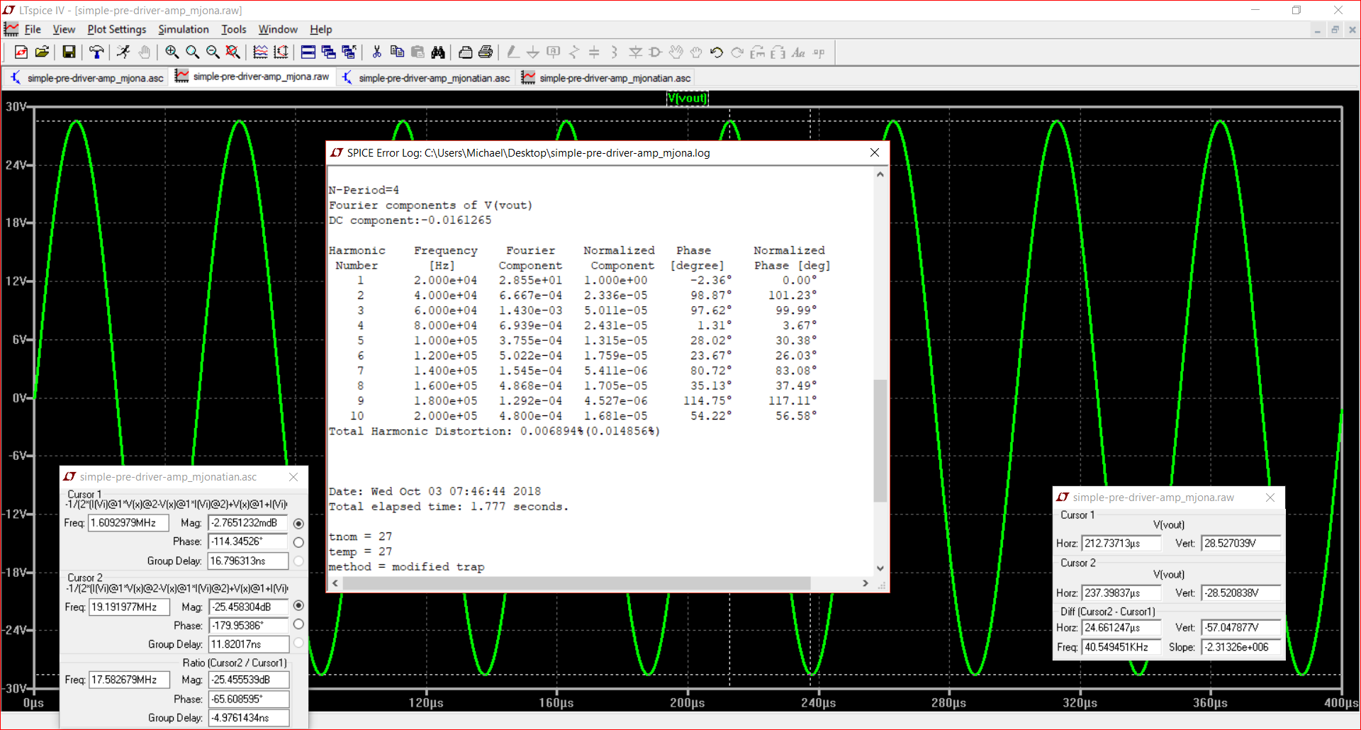

50 Watt Version
I am quite surprised how well this circuit simulates and am attaching some preliminary views of THD and Tian probe results. The results for THD are at 28.5 volts peak output. I did the Tian probe test before this at 27.5 Volts peak but there is no difference with the re-run I did after the screen shot was taken.
I changed a number of transistor types and reduced the supply rails to 40 volts.
The output devices are MJL21193 and MJL21194. I made the drivers BD139 and BD140.
The collector and emitter currents are roughly equal in these. The MJL's standing current is about 10 m.A. paying heed to the mention of the findings of Self.
There are a few other points to make about the circuit and I am gathering some thoughts for later. I will post my .asc files in due course.

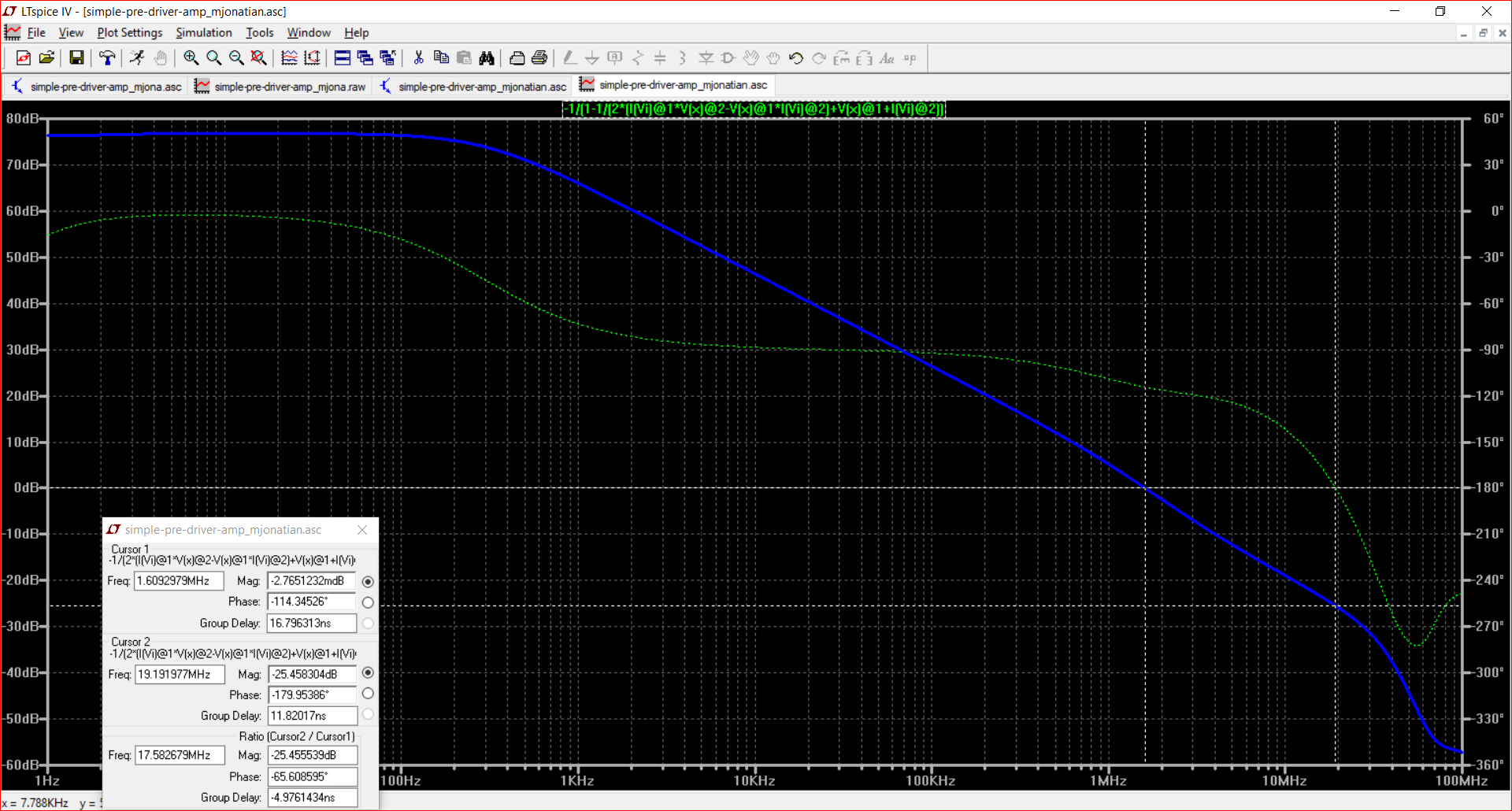

For the Tian probe the expression -1/(1-1/(2*(I(Vi)@1*V(x)@2-V(x)@1*I(Vi)@2)+V(x)@1+I(Vi)@2)) is shown in blue on the file.
Copy this and run the simulation. When the .raw file appears right click on the title in green vin and when a drop down box appears showing this delete it and paste in the expression copied. Then select the option to use two cursors drag cursor 1 to coincide with 0 dB as close as possible. The keyboard side arrows allow more accurate placement in fine steps. Then do likewise with cursor 2 to set this at -180 degrees.
The gain and phase margins will appear in the box at the bottom of the screen.
This simulation can be used to check stability effects arising from changes if anyone is interested in experimenting. A couple of things to note is the presence of a 27R resistor in the Vbe circuit which is contrary to the way Self does this but in accord with Julian Vereker and John Linsley-Hood. The compensation scheme is around the voltage gain stages - I tried Miller compensation early in the piece. The feedback network is low impedance by choice to allow a low value of compensation capacitor - value almost nothing.
