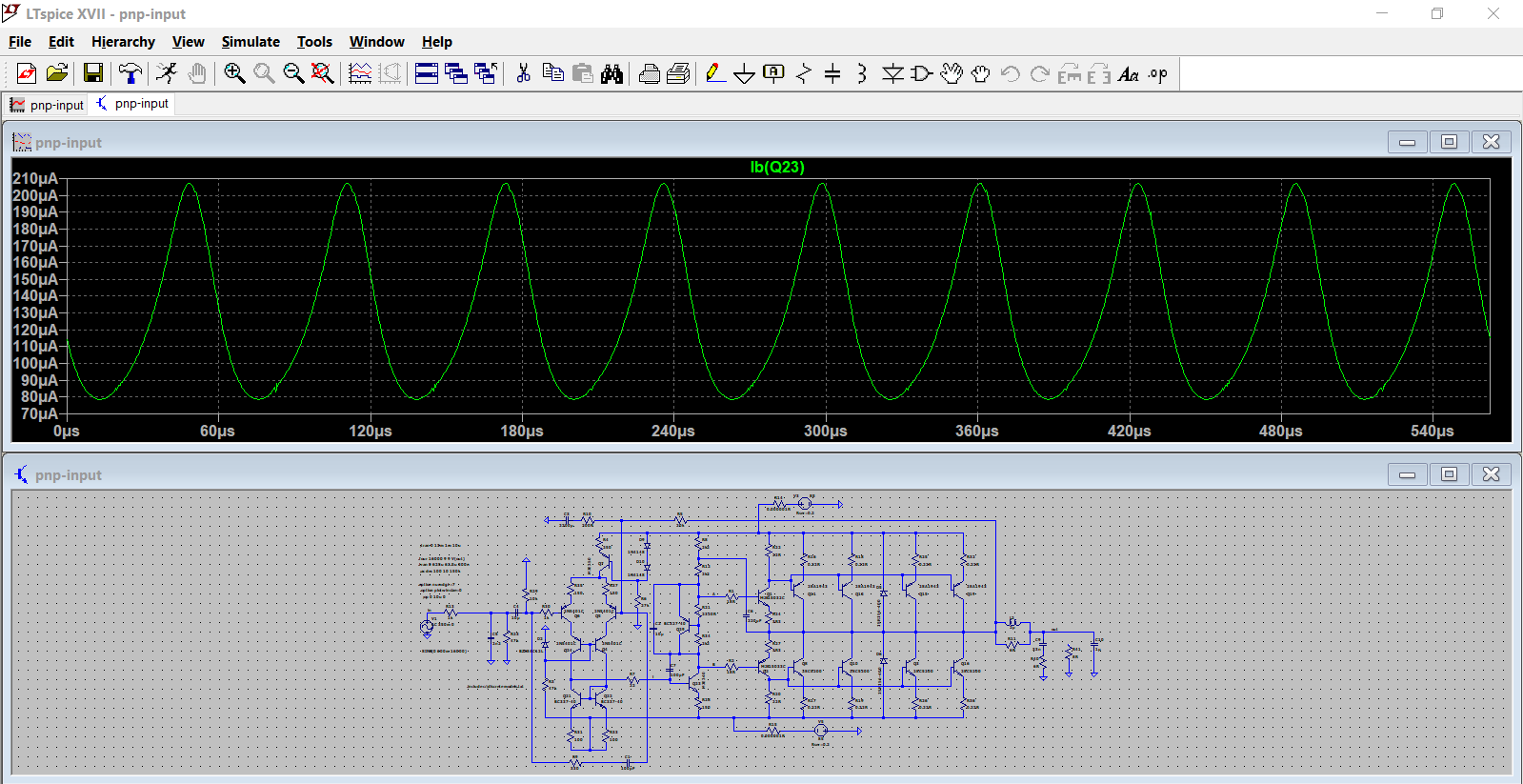

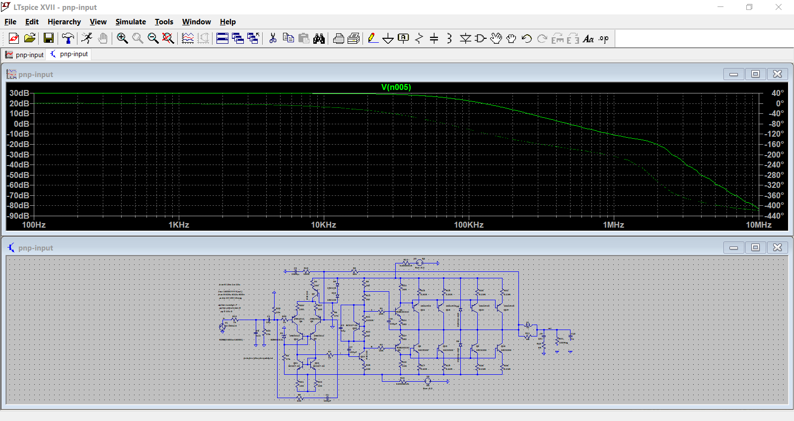

I've had a play with edbarx's design but it seems to defy conventional attempts to tame this behaviour completely.
I got it down to this and with the biggest change being seen in reverting to a conventional bootstrapped load for the VAS.
  • pnp-input.asc
    pnp-input.asc

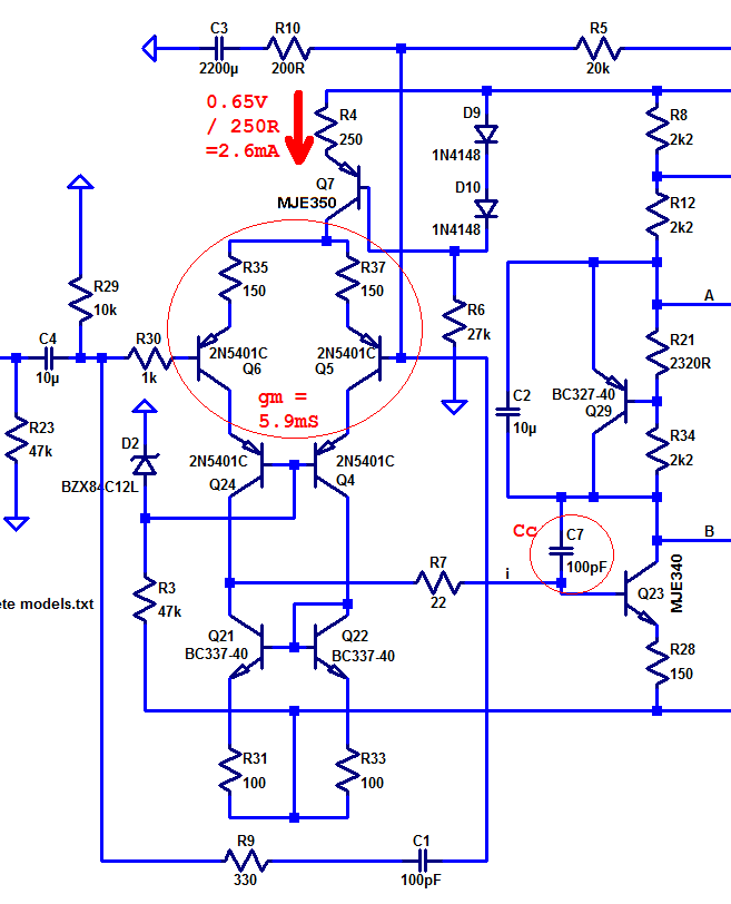

Quoting from the attached pdf.
Wh = gm1/Cc ................(15)
dVo/dt = 2Ic/Cc .............(18)
With:
2Ic = 2.6mA
gm1 = 5.8mS
Cc = 100pF
Wh = 5.8x10^-3/100x10^12 = 58x10^6Hz
dVo/dt = 2.6x10^3/100x10^12 = 26x10^6V/s
P.S.
Plotting Idiff/(Va - Vb) I got 47.7mS. Va and Vb are the voltages at the bases of the differential pair and Idiff is the current taken as output from the differential pair.
This is what this "proud" person gets from these formulae. Please, note I am not the kind of person who is convinced the universe revolves around them; I am too old and too tried to hold such a delusion.

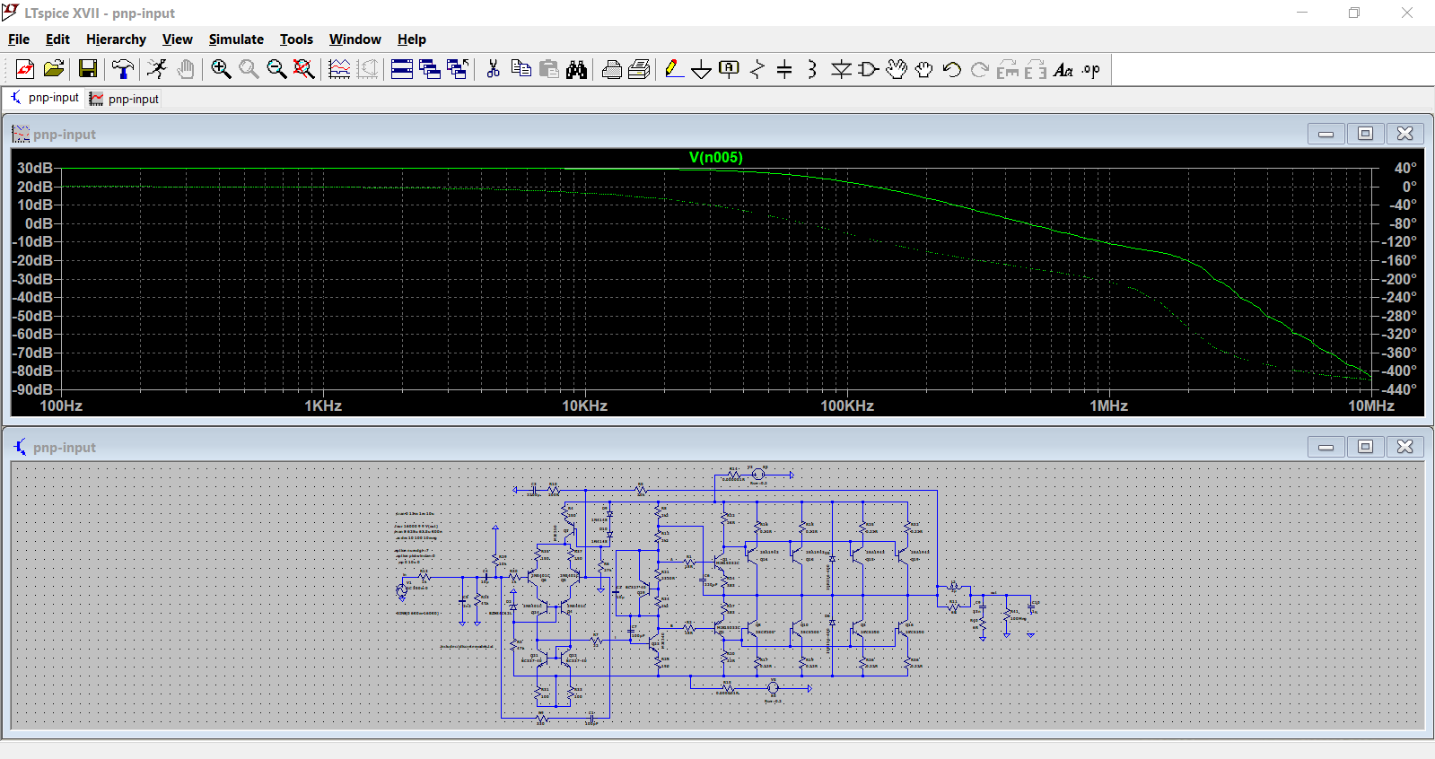

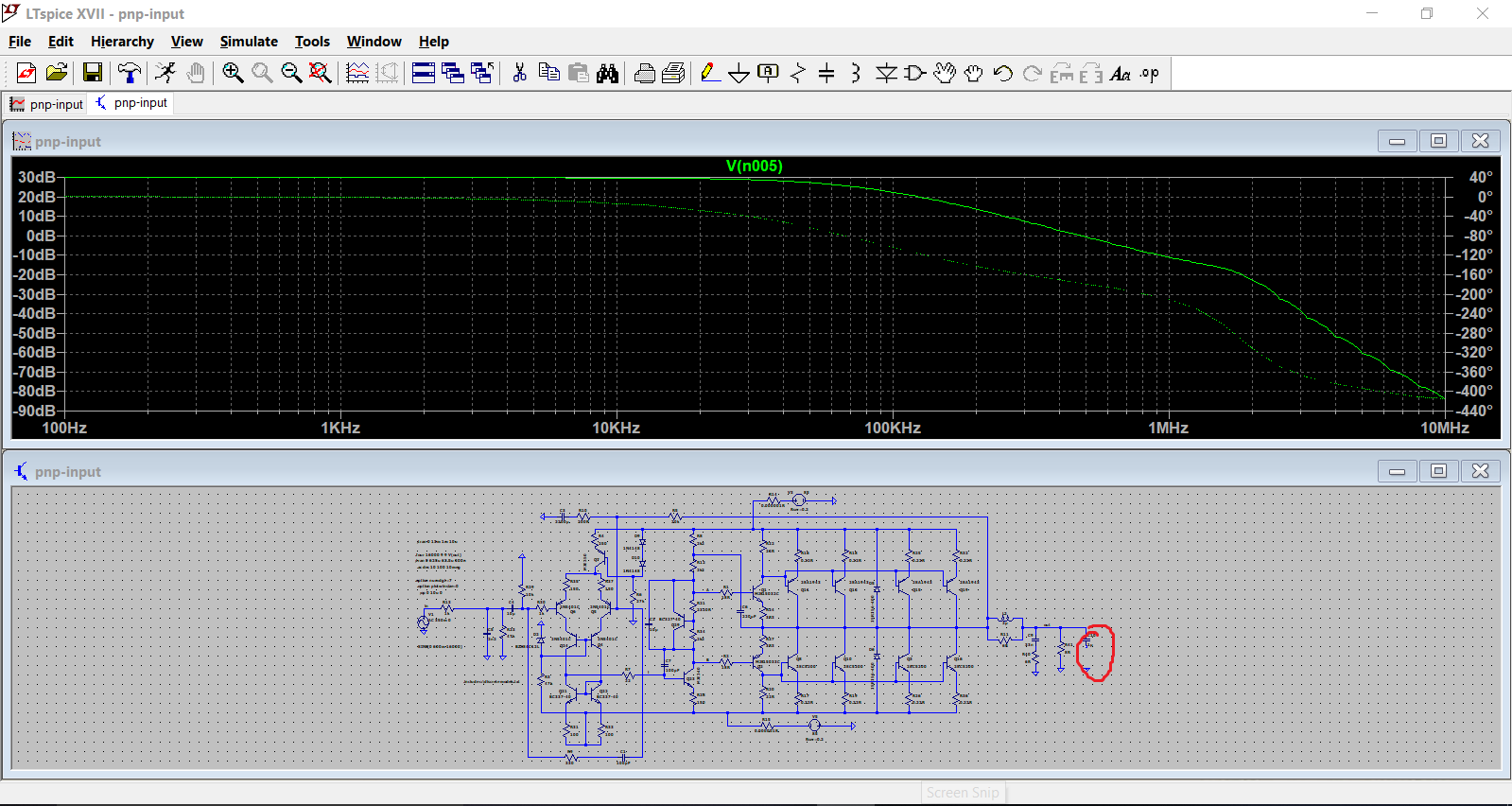

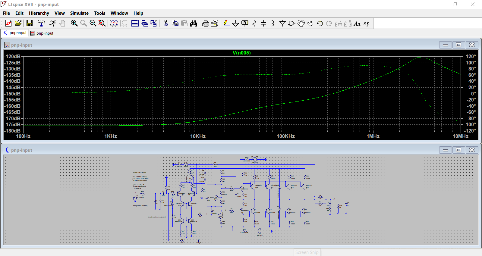

I've just noticed the sim still includes the capacitor loading on the output.
More weirdness now. If you run an AC analysis with the cap removed then the results are nuts.
So in sequence.
1/ This has the cap removed and no load attached.
2/ The cap removed. The load is attached.
3/ The load is now 10 meg. Cap still removed.
4/ The load in now removed.
Why is '4' not the same as '1' ?
What would you do with this amp Mark ?
Almost right; equation (15) gives a result in radians/sec ; to convert to cycles/sec ("Hertz"), divide by 2*Pi.
And you get gain bandwidth product of 9 Megahertz. In my opinion that's awfully aggressive for a hobby project using minimal test equipment. In post #201 I offered the suggestion that 20 megaradians/sec (3.2 Megahertz) might be a realistically achievable goal.

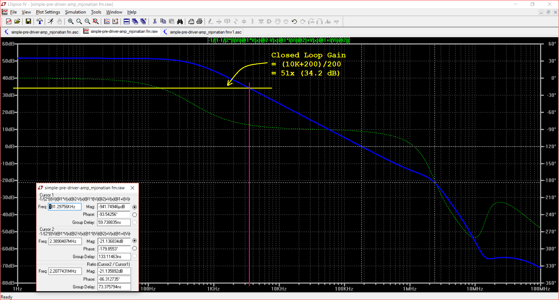

I never before this time did an AC Analysis, frequency response analysis, with the feedback loop disconnected. The test show the dotted line crosses the -180 degrees at around 80kHz. This is definitely bad and may be the reason for instability.
Since the latest circuit was deemed inadequate, I am doing my testing on this one which is still a works in progress.
I don't know whether Mjona's open loop frequency response plot is representative of a design that is constantly being modified. But if we consider it a "snapshot" and study the plot a bit, we see its open loop gain is perhaps a bit low for an amplifier whose closed loop gain is 34dB. I drew a yellow line and a pink line on Mjona's plot.
_

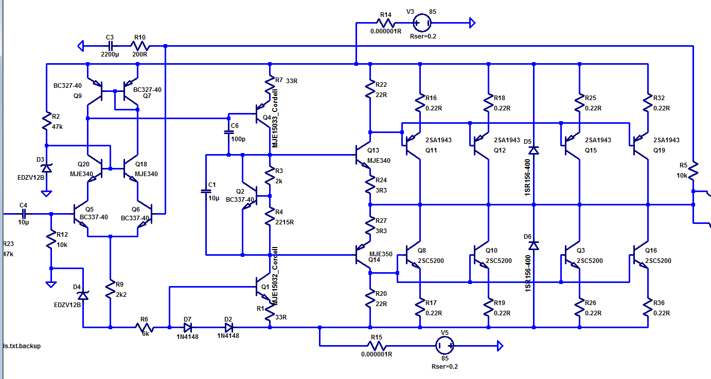

Anyway I am attaching my latest simulation. In the previous ones I had relied on C6 for compensation with different values (just showing to illustrate only). If MJE243/253 are up to the job with 85 volt supply rails these will give better stability margins than MJE340/350 which look a bit skinny to me.
I have not gone to a lot of length with this simulation so feel free to knock into whatever shape.
I have abandoned that plot which was based on using MJL21193/21194 outputs which I can see is not going to happen. Attached is an updated simulation using MJL1302/3281.
I have eight 2SC5200 and another eight 2SA1943 transistors already mounted on heatsinks with the driver and power stage shown. These were taken from a large public address amplifier (Wharfedale S1500). Since the amplifier failed and it was quite new but with the warranty period expired, I do not want to throw away everything. The amplifier's box contains a large powerful power supply that can supply about 15A of DC current at +/-85V. It has a beautiful finish, and in my opinion, it would be a waste to throw away everything. This is why I am keeping the power stages and power supply. I am only changing the pre-driver circuitry and the way the amplifier was grounded. I want the 0V rail to be grounded.
Since the voltages are +/-85V, Vceo must be over 170V. This applies for the VAS's transistors. The other high voltage transistors need not be that high voltage although preferably they should be capable to withstand 170V in the event of a failure.
