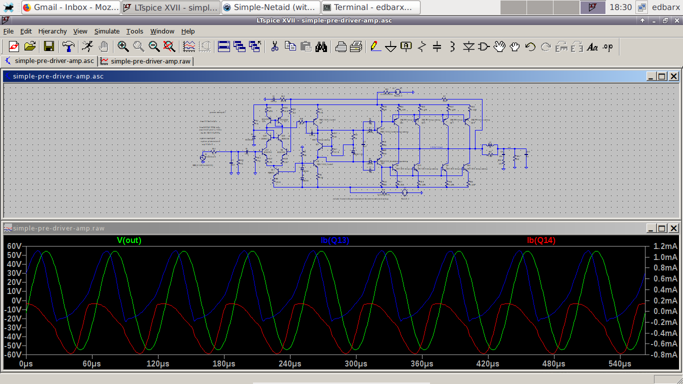

Nearing my aims. 😀
Features:
a) No ringing of driver base currents at 16kHz
b) Drivers and power output transistors thermally protected with the quiescent current almost remaining CONSTANT over the temperature range of 27C - 65C.
c) A distortion figure < 0.2% for ear-drum breaking powers.
d) A beautiful square wave at 20kHz
e) With the output filters, and assuming a parasitic capacitance of 1uF in the output, the phase angle of the output never reaches 180 degrees. This over the range of 10Hz - 100kHz.
f) The circuit uses the exact same output stage, so I do not need to remake it.

Thinking about output short circuit detection and power shutdown in such an event. I am thinking about using a small tyristor to activate a sub-circuit to de-energise the entire amplifier in the event of an output short circuit. The circuit will divert current away from the input stage, VAS and power stage drivers. A tyristor has to ability to remain on once it is turned on. This will avoid having the protection circuit making the entire amplifier oscillate.
This same circuit may also be used to shut down the output when clipping is detected. A LED will turn on when this protection circuit is activated. Short-circuiting the tyristor temporarily resets the tyristor. What do people here think about this approach?

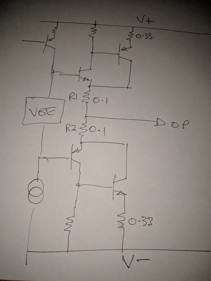

You need to implement current / temperature stability feedback resistors
as previously discussed. See below.

P.S.
Those 0.1 Ohm resistors are a good idea which avoid depending on the functioning of a complicated temperature compensated amplified diode. In my design, if the amplified diode fails while the output is hot, it would mean destruction of the output transistors.

Exactly.
What I have shown is standard way to implement CFP OP stage.
The resistor values vary to some degree, but you need them.

Rethinking again and reverting back to the idea of denying power to the amplifier, in the event of overload/shorted output, I think, it can be done with an additional six components. This time the opto-coupler is a normal one transistor one diode optocoupler. For low current sensitivity an infrared LED may be used provided these photons have enough energy to generate electron-hole pairs in a doped silicon crystal.
I am attaching the edited yet unsimulated circuit. First, I have to figure out how to let LTSpice recognize a tyristor. The problem is I do not know what I have to type in the Component Attribute Editor dialog. I need to simulate a 0.5A tyristor that can stay on with a few milliamps and can be triggered with a current in the order of a milliamp.

With this optocoupler the LED conducts when the current reaches 13A.

I will stick with the conventional output current limiting circuit. The attachment is the resultant circuit. with a short circuit of resistance 0.1 Ohms the output current is 28A and the output waveform is more or less a square wave.
If users think this circuit is the one to be built, I will start making the PCBs. Each amplifier circuit will consist of 3 separate PCBs two for the output stage and another one for the other stages.

a) I also heeding to the advice of mounting the driver transistors on a separate heatsink. Simulations show that if the drivers' temperature is 10K cooler than the main heatsink, the quiescent currents will be optimum.
b) Ringing of the drivers' base current at 16kHz is eliminated with compensating signal diodes and a 3n3 capacitor in parallel.
