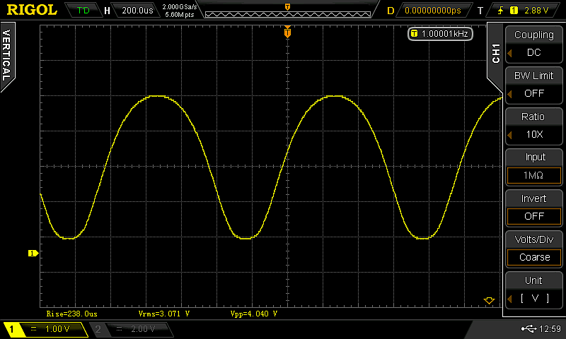

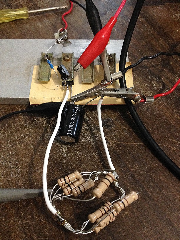

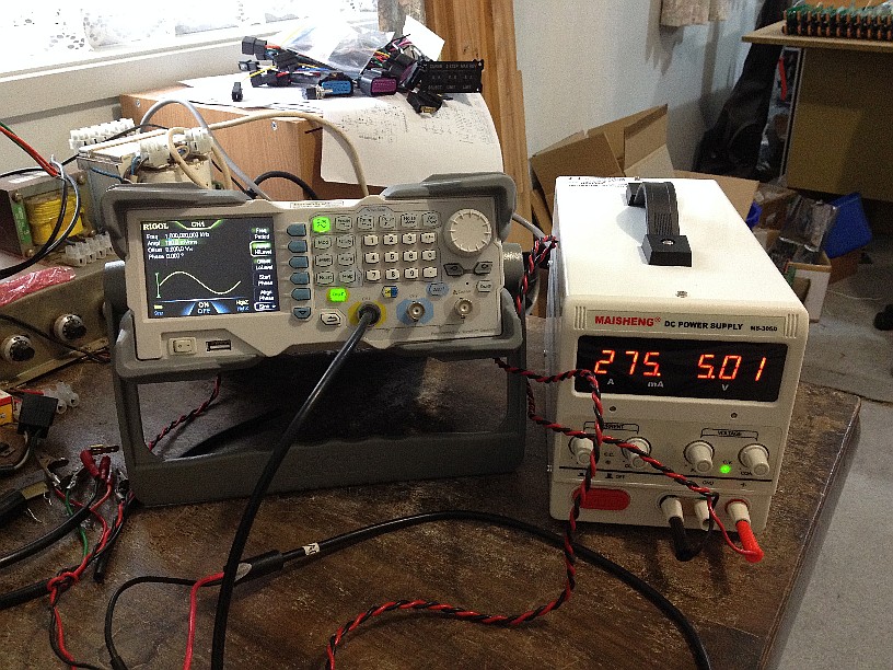

I used an IRF540 because that's what i had laying around, so it's not an exact comparison,and i used an external adjustable bias supply to find the best point, but it does illustrate the fact that with a 5 volt supply and an 8 ohm load I couldn't get more than about 4 volts peak to peak output without heaps of distortion. And that 4V p/p equals 0.25 watts output. End of story.

5 volt supply, 8 ohm...0.25 watts output. End of story.

So you don't agree with my actual measured results and yet you haven't measured them yourself? Would you like to explain to everybody why you have this particular point of view?Umm, don't think so
