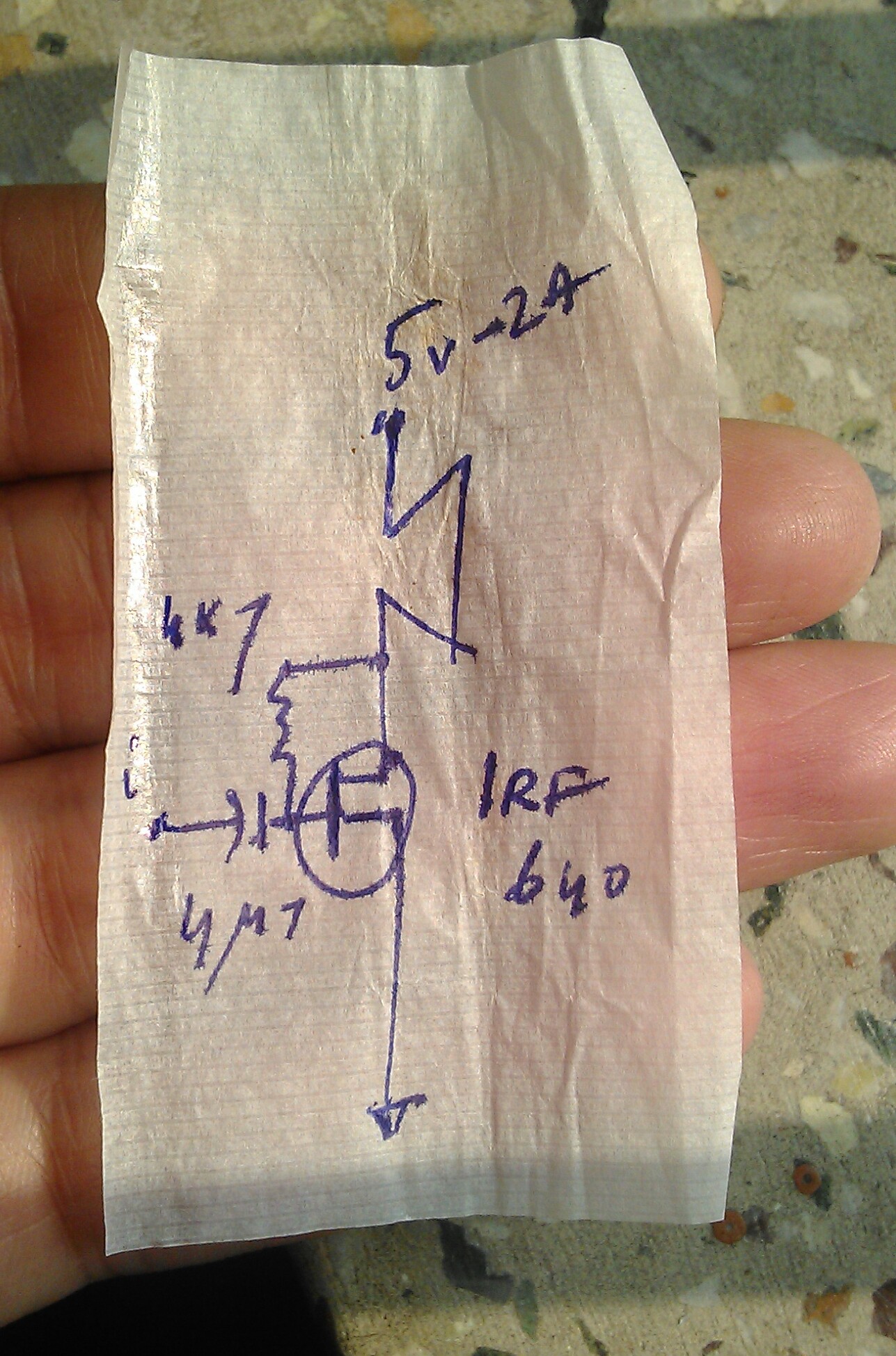

Here's it,
Drawn on tobacco paper, not promoting though
I'm low on resources, can't measure,
You better make one, it is very simple,

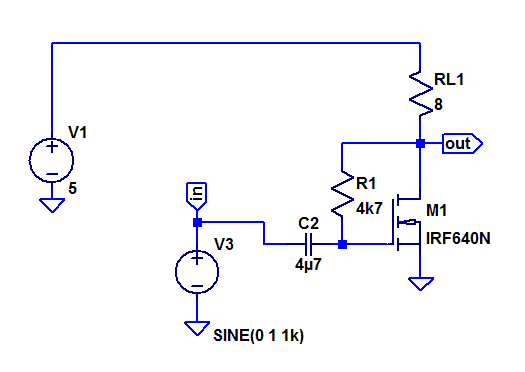

Your schematic looks just like the one posted on post #2 where you said it was not correct. Can you explain how it is different?
Vs:
I have to give you this, never seen a schematic on a cigarette roller paper before. Perhaps a hint at a smoking voice could if running too much voltage 🙂
MOSFET will have 4v drop so about 1v across voice coil max. Most speakers can handle 1000mV dc offset but it dissipates about 1^2v/8R or 125mW.
Apology for that, But I did not mention the word wrong.
Well, there is a first for everything.

Half apology after I revisited the comment #2, the o/p sticker should have been made at the top of R load, not below so it could be confusing, just what happened.
For the reader's clarity:
In post #2, "RL" IS the speaker. Scratch the output tap, the only actual resistor is on the input. Correct?
The rolling paper drawing wins my prize for the coolest hand drawn schematic. (See, over here, people don't really use them for tobacco) What we need here is a Cheech & Chong smilie...

The absolute max power can easily be calculated from the schematic.
Maybe you missed it: post 21. About 0.6W theoretical max but we all know that in practice it will be less.
