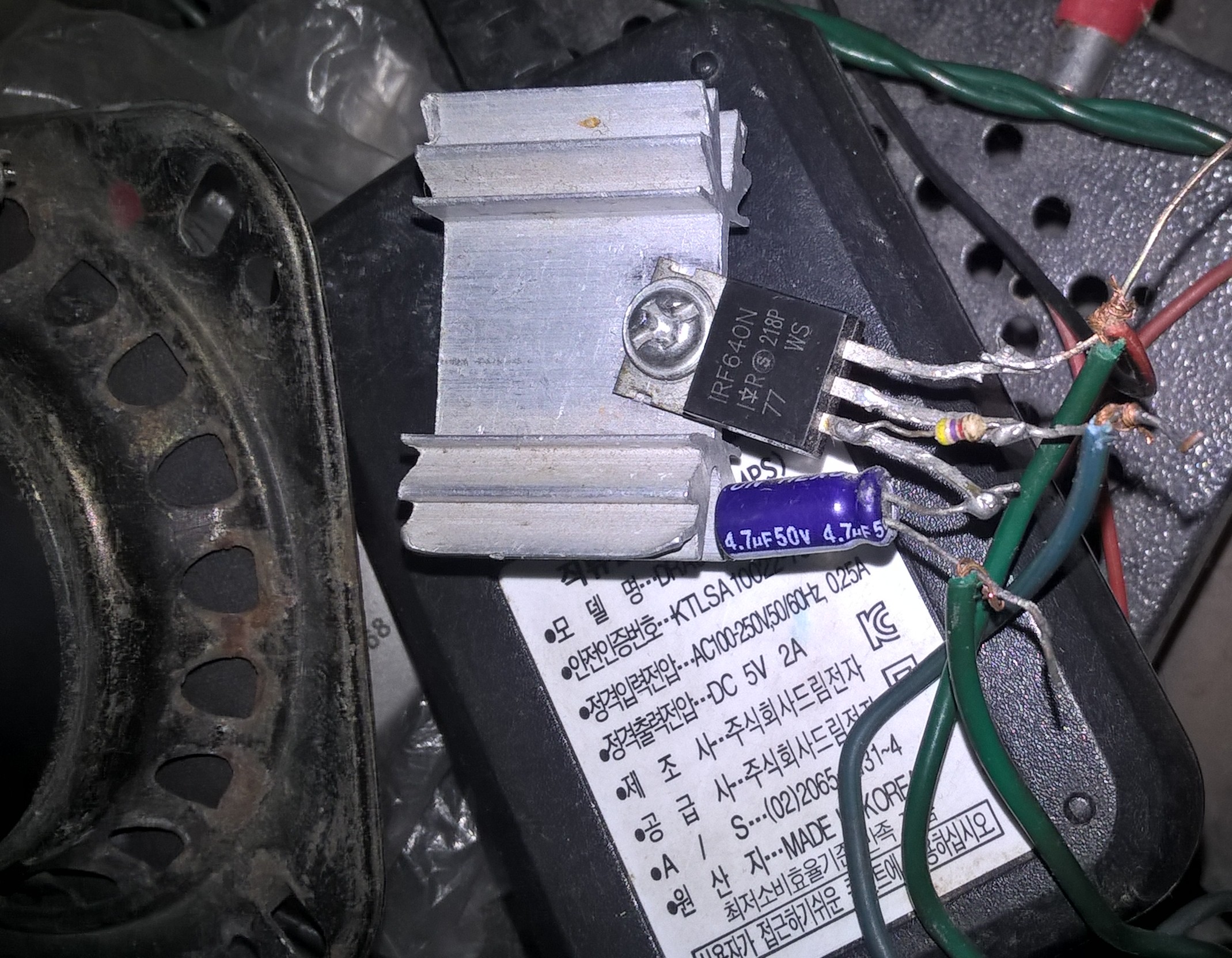

Just for this comment, to see, how low my pretty little amp sounds, I stayed away from direct feeding my beloved aiwa or philips deck, and bought a non functioning pocket cassette player from flea market, repaired and here's the outcome.
70dB out of 5v, not a bad joke, eh?

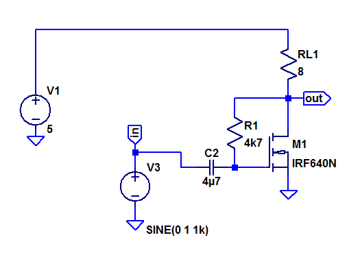

> circa 4v dropout voltage?
The D-S "drop out" of a MOSFET is a part-volt. (You may be thinking of source followers without over-the-rail gate drive.) See first image snipped from IRF640 data.
I simmed, using a variable-gain device to adjust 230mV drive signal from below to above full clipping in 3dB increments.
At low drive levels the thing has the expected 2nd harmonic distortion, "sweet". THD is essentially proportional to drive. At 1.5V peak output it reaches 10% THD, almost all 2nd. This is the customary place to rate a non-hi-fi amp, and figures as 0.280 Watts RMS. Past that it clips on the top and bottom, 3rd harmonic, "loud".
The simulation uses another (older) MOSFET which I tinkered to get an optimum Vto (the only way to set bias in this plan). The model used is very crude and not accurate at these relatively low currents. If someone has a better model which shows some higher level of higher harmonics, I'd believe it.
