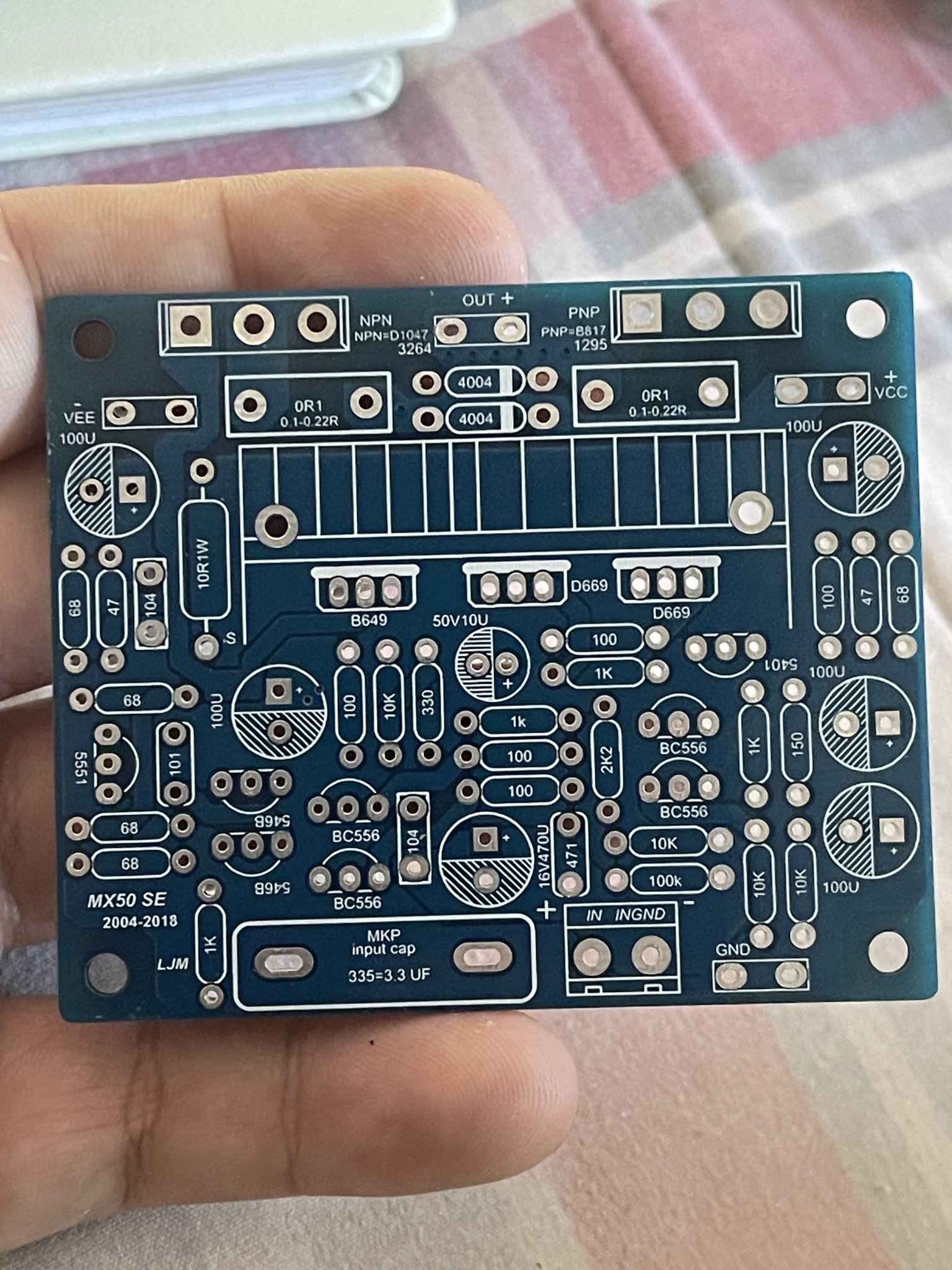

MX50SE problem please help
Also can you tell me which of these resisters controls the dc offset ?
It is usually determined by the DC balance of the differential input stage. If the offset is below -/+100mv it is a non issue.

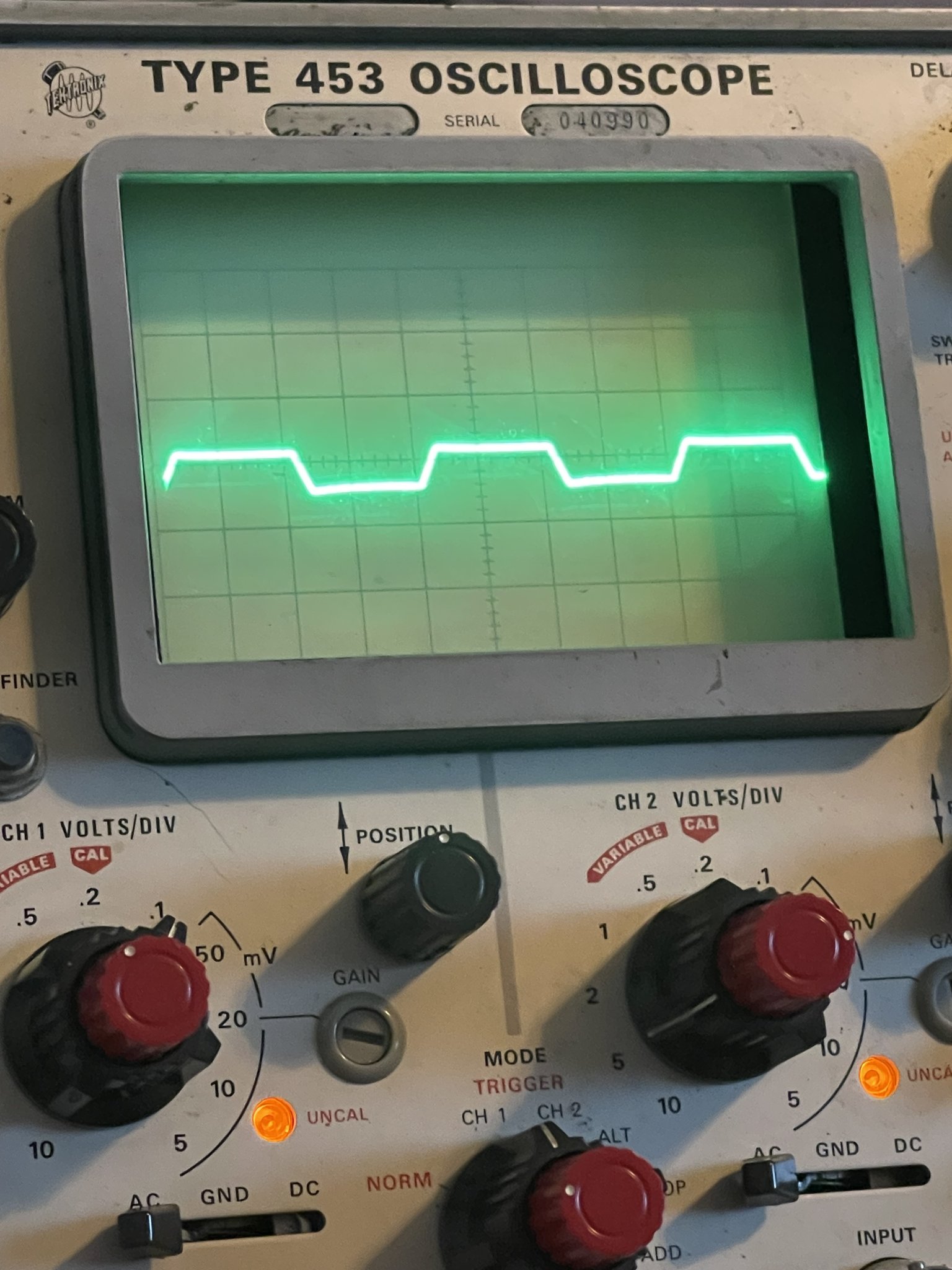

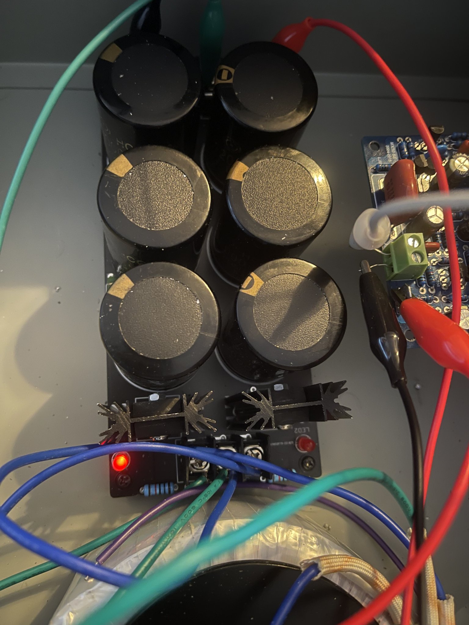

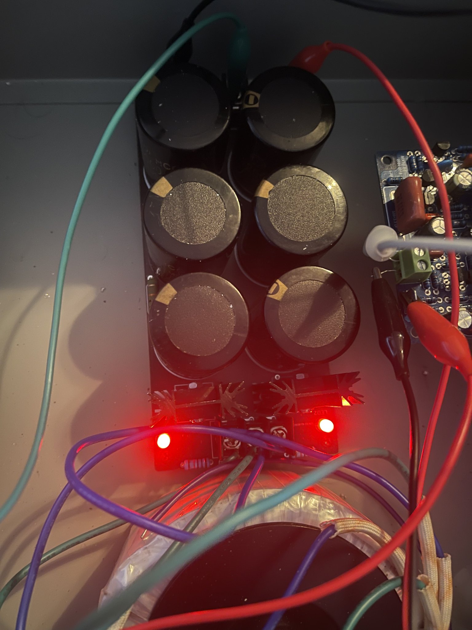

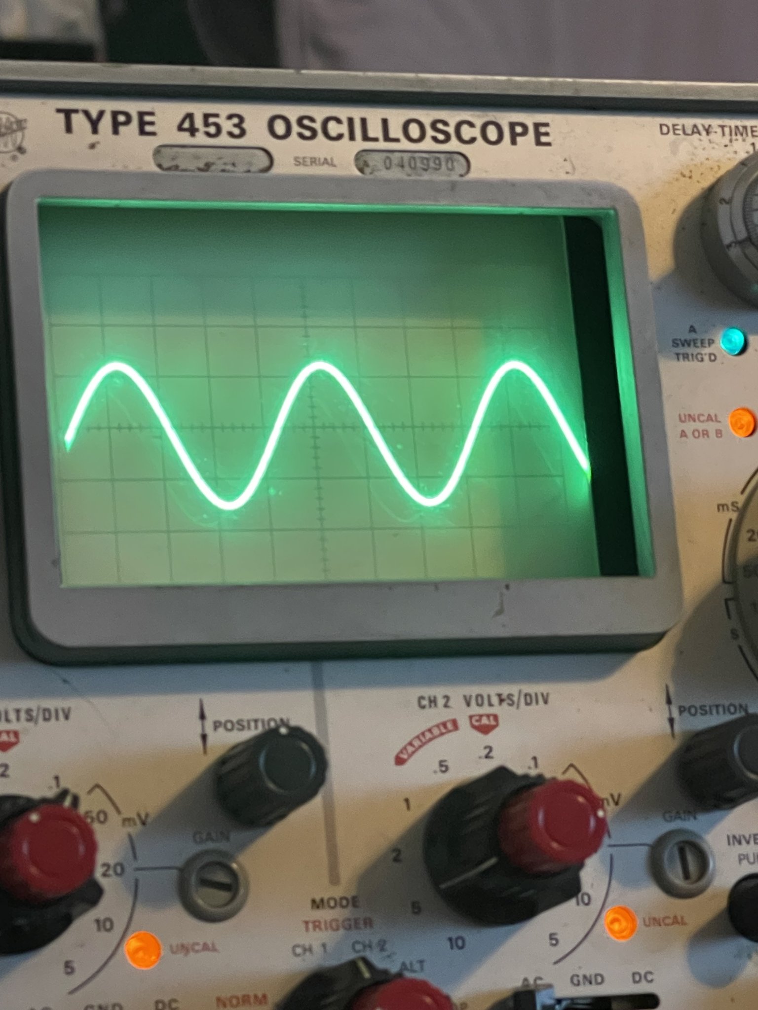

Another question this is a weird one on the psu I have two led light they indicate that the caps have power . Now when the amp is connected one led turn off faster then the other indicating that there is more load on one side then the other . I checked the current on the ground side and there is 1.5ma indicating that there is an imbalance in the circuit it was not like this before both LEDs used to turn off at the same time . Am I overthinking things or is there an imbalance in the circuitry ? Just to test it further I ran a 1khz sine wave through the amp and measured it with the oscilloscope and I can clearly see that one transistor is shutting down before the other ! Could this be a miss match of the output transistor? Maybe the hfe is different one to the next would that effect it ? On the pic with the oscilloscope you can clearly see that the top portion of the wave is at zero but the bottom portion is got some potential still . The only thing I can attribute this to is a miss matched output transistor but I could be wrong !

Its all normal, really 🙂
Each amp will draw slightly different currents, you can't expect the - and + rails to fall at the same rate when you turn off. Also if you have a load attached then the DC offset will shift as the collapse and that will pull one rail down much faster than the other.
I think you misunderstood me I’m only testing one amp the other amp is not connected I was just curious why one rail was draining faster than the other when the entire circuit is made to be balanced ! And no there was no load connected ! The only thing I have changed is the 10ohm resistor I put a 2w instead of a 1w I thought maybe that had something to do with it . As soon as I get the parts to complete the second amp I’ll compare the two see if there is a difference.
The current draw from each rail can be different in an amp. I don't think this one is balanced meaning each halve is a mirror image of the other, it has a differential input stage but that's all.
Also large caps such as the PSU one can have a wide tolerance, a close tolerance for big caps would be -/+20% and they could be as much as -20/+50% and those differences mean each rail holds more or less energy than the other at switch off.
Its all a non a problem.

I’ve checked to see if the caps are turning off at the same rate and yes they do when there is no load or amplifier connected ! It has two drain resistors that drain the caps and they discharge at the same rate !

Ur oscilloscope showing Ac wave dominating more at negetive side 🤔 i don't think it's good negetive will clip first then positive that's not good
Provided the amp has low offset and no oscillation you haven't a problem.
What happens in the time the rails collapse isn't a meaningful measurement and is simply a non valid test. As I have said, lots of amps draw differing currents from each rail.
