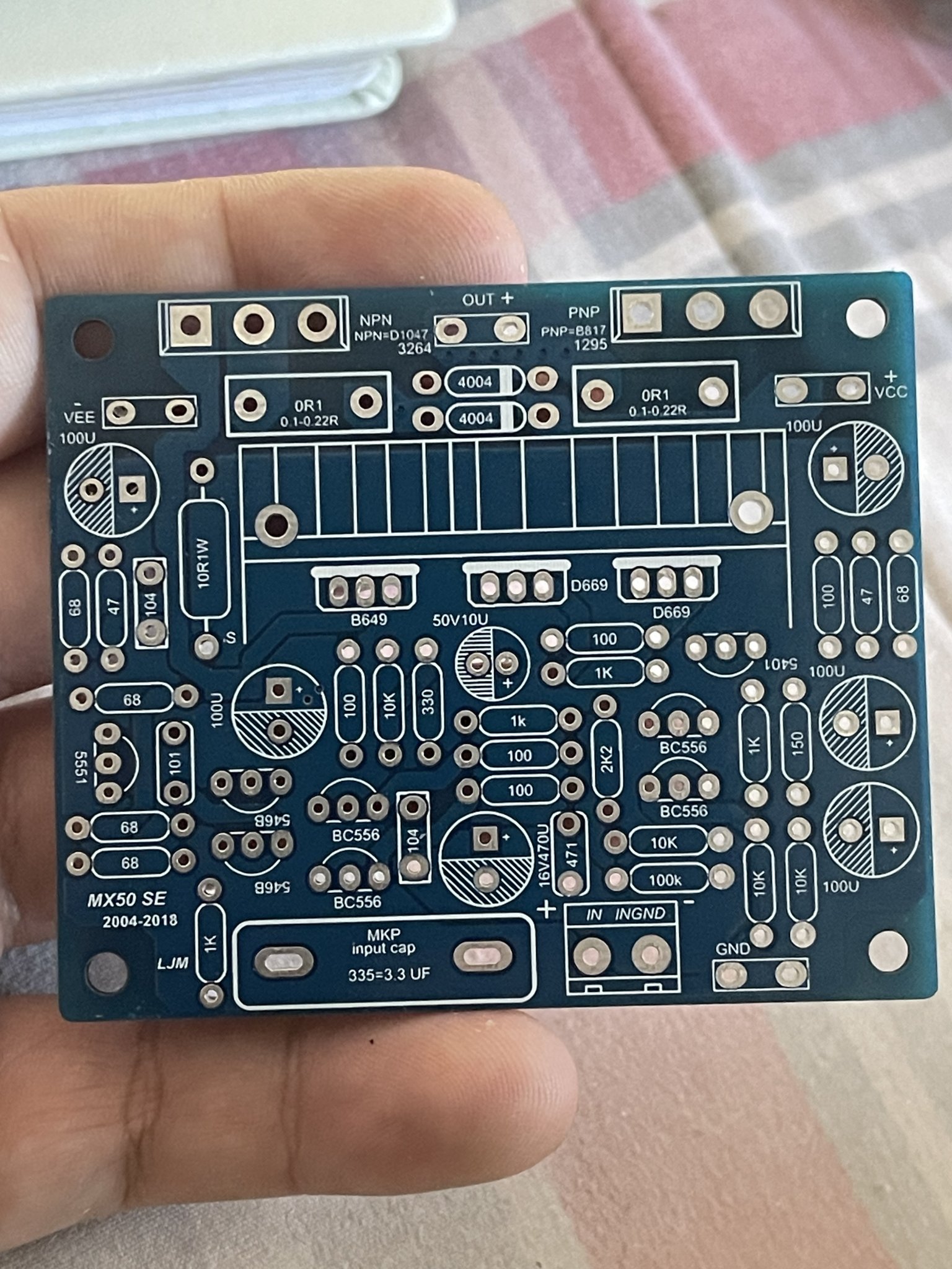

I think it's pcb problem , u can see there capasito connection present with collector but base connection missing đŸ¤”

Everything looks properly soldered! Unfortunately I don’t have any spare parts to swap in I’ll have to make do with what’s on the board

Check if newer version schematic available there, to see what components r used and what u r using, check components properly
99.9% that is what is happening.It’s very strange could it be a very high frequency oscillation above the audible range ?
I'm going to say you should start using a DBT (dim bulb tester) to limit current and further damage. The board should draw minimal current if powered up on its own with the inputs shorted.
It is unlikely (imo) to be a faulty cap as both boards behave the same way.
Well strange update I desolder the blue cap I think it’s 100pf and and resolderd it and now amp has been running trouble free for 10 min go figure that one out . The amp with no load pill like 20ma it’s very minimal amount of current so I’m very very confused lol đŸ˜‚

The blue ones I believe are 2kv 100pf does it matter if it’s 1000v or 2000v isent it a bit redundant for it to be such high voltage ?
By the way one of the 100pf measures at 79pf would that be enough for it to oscillate?
Now I need to get the second amp going I need to order output transistors the 100pf caps and 0.1 ohm 5w resistor and 10ohm 2 w resistor and see if I can get the second amp to not oscillate!
